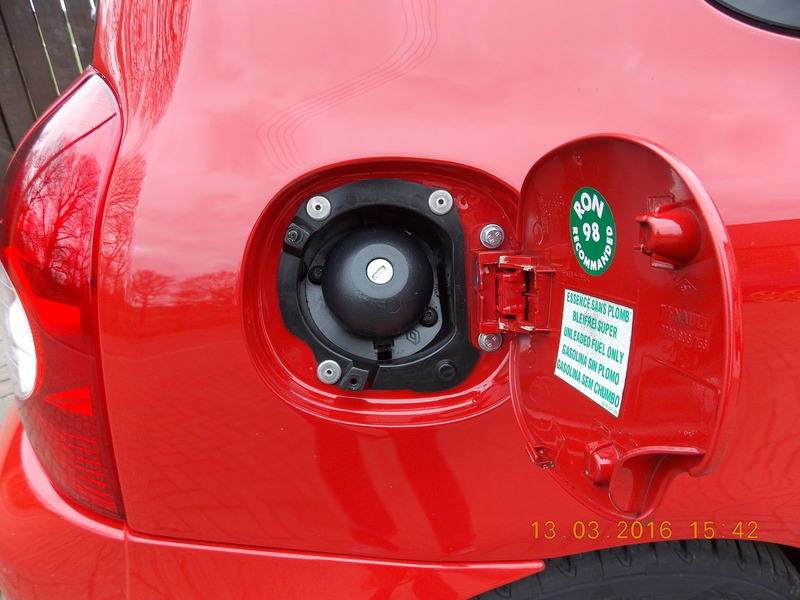

Hi guys - could somebody take a picture of the fuel filler section with the fuel door open? I would like to see what the area around the cap looks like. When my fuel door is closed its slightly deeper than the surroundings - wondering if I am missing a rubber seal or bits. This is what mine looks like:

@LOK Top Left silver rivet, To the left of that there is a small rubber stopper / bush
Bottom Left rivet, To the right of that there is a "missing" small rubber stopper / bush
If they are both missing the cap sits slightly in and your picture shows both are missing
A new unit is only around £10 from Renault, you can not just buy the rubber stoppers.
Easy enough job to do but the pop rivets should be black, I touched mine in after fitting new one's.
