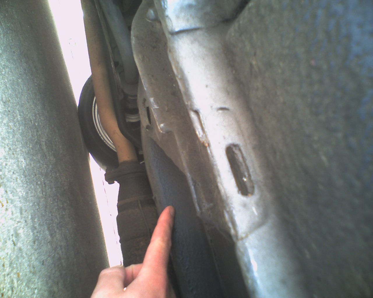

Look at the botom of th sills near where the door hinges are. Then stick your hand under the car and youll fell the bit of chassic about 1 inch high an 1.5 wide bu about 2 foot long. Id try and jck on the but if your going o axle stan i jack on the normal jacking points (the sills) an put the axle stands on th chassic member bits.
ive started doing it on the bit i photoed above,and it seems ok is this safe, plus do i have to put 2 axle stands on or can i just have one?
well i jacked it there for a trial!pants im getting confused now thats where haynes say use it but it is the dodgy max power poo book!
