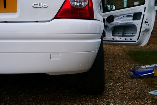

Before 15's on the rear

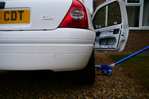

After 15's on the rear.
I did have a fair amount of negative rear camber. Also the before wheel was et37 and after was et43 so affectively only gained 10mm.

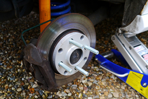

I bought mine from Larkspeed, well worth getting alloy ones and they must be hubcentric. My rears are H&R, too small for bolt to hub so i run a stud and nut conversion.
Front is bolt to hub FK alloy 25mm spacers. Any more than 15mm rear and 25mm front without having a different offset of wheels is likely to scrub from what i have seen.
I was hoping to bolt through with longer studs, is that not advised??
Might aswell do a stud and nut conversion if you need longer bolts anyway, Larkspeed sell the ones used in that picture studs are about £1.00 each same with nuts, so you could do the whole car for about £32!
