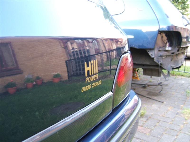

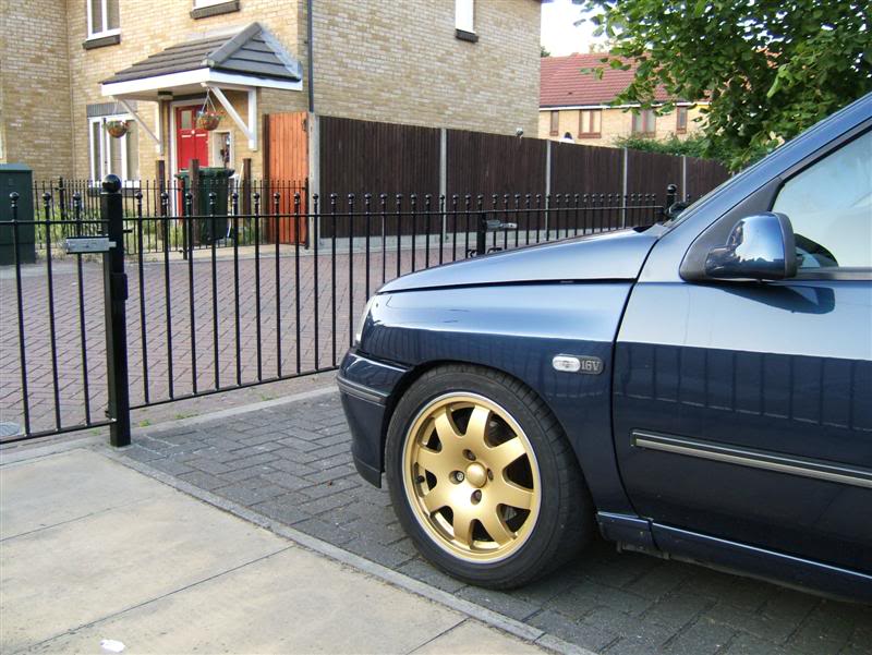

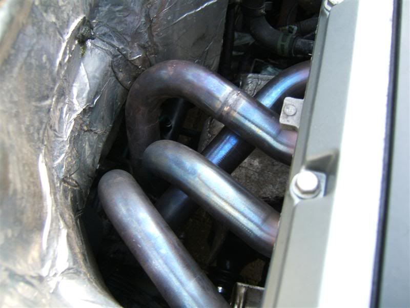

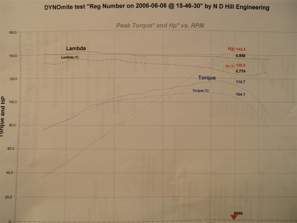

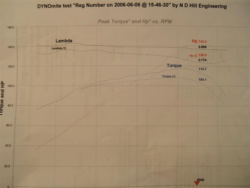

went to hillpower yesterday to collect my hybrid, had williams widetrack fitted with aload of new parts and a set of fk konigsport coilovers. also got the supersprint manifold fitted, uprated fuelpump and another remap due to it running lean, well pleased with the results... the dotted line on the graph is what i got when i went to the williamsclio rr day and the solid line is what its at now. love the way it handles on the widetrack aswell, thanks nick very happy with the result:D a few pics...
