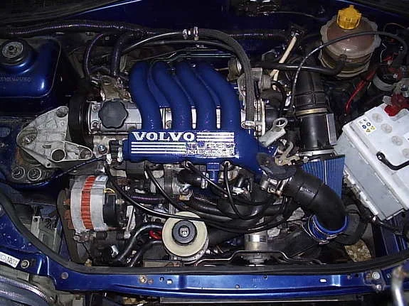

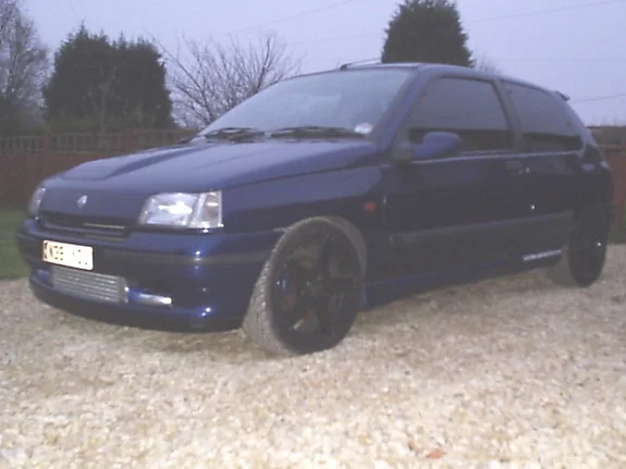

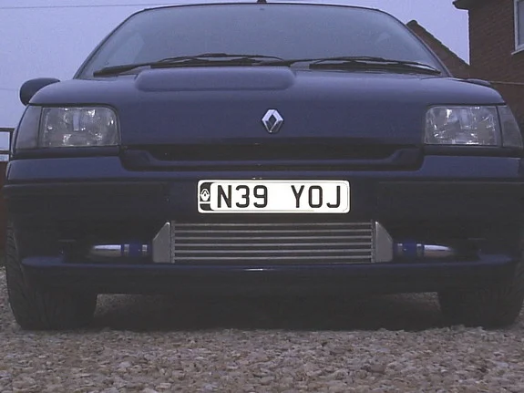

finished putting my engine back together after having the head ported and polished, so thought i'd post some pics.

well about 170bhp has been predicted by the guy from a volvo forum, who reprogrammed my ecu. its gunna be tested march at amd.
heres the spec so far;
*1996 renault clio rsi, phase 2
*16 valve bonnet
*tinted windows
*modified front bumper to incorperate front mounted intercooler
*16'' mania, 5 spoke alloys, resprayed in jet black, low profile tyres
ENGINE
*volvo 440 1.7 turbo transplant, running rsi gearbox & driveshafts
*front mounted alloy intercooler, polished intercooler pipes
*baileys twin piston dump valve
*j&r cone type induction kit
*polished & ported head, new valves & springs
*custom exhaust downpipe, made by apex performance tuning
*full stainless exhaust system with de-cat pipe
*strenghtened top engine mount, tig welded to head
*re-programmed ecu - more boost
*custom wiring loom throughout
*blue colour coded block & inlet manifold
*rsi radiator with custom coolant pipes
*lowered 50mm at the front on spax springs and gas shocks
*lowered torsion bar by 70mm rear on mon-roe gas shocks
*larger front 16valve discs & calipers, sintered pads
*rear: rsi discs & calipers, sintered pads
*16valve dashboard
*white lockwood dail set
*centre mounted boost & aux gauges
*16valve steering wheel
Should go well enough then. I wish some of the Max Plastic boys would take a leaf out of your book and make a proper modded car rather than a mobile fun fair.
cheers. the main problem i had was the power of the engine, ripped the top engine mount out of the head the first time i took it out!! so i got it tig welded to the head all the way round, seems ok now.
