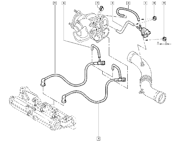

I am struggling to make sure this is the part I require: 8200549111
For a Renault Megane R26... could anybody provide me with an exploded parts diagram of the engine bay / front end / inlet / vacuum set-up and or show me what that part is?
mucho appreciated.

You only had to ask ;)
8200549111 is no 1 in that photo - the hose running across the top

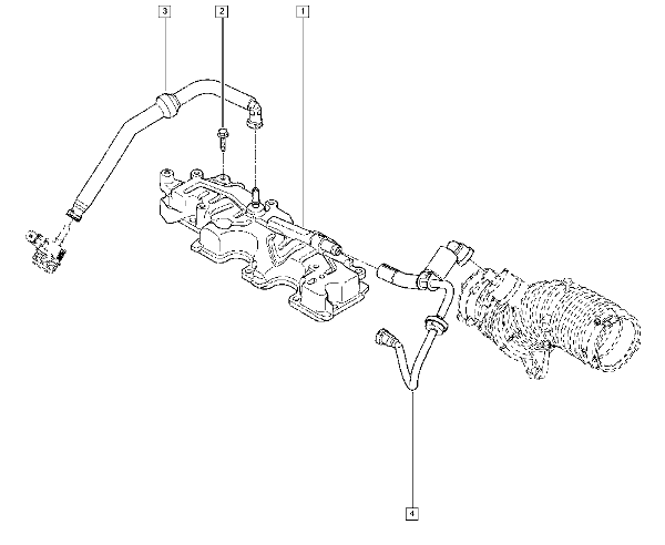

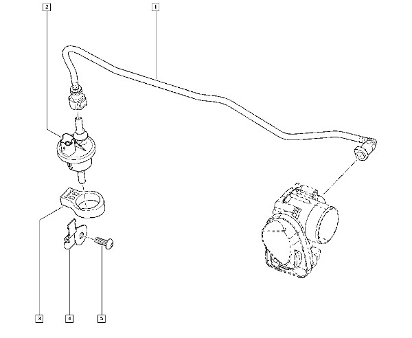

these are the other two photos linked to that section
If you need anymore of them part numbers from them photos, let me know.

Its doesn't show up correctly on dialogys but thats the breather pipe that everyone snaps, one that clips into the throttle body. The one that connects to the carbon canister solenoid and the breather on the head.

ahh I've snapped the pipe that goes from the inlet manifold - T piece for recirc valve - then it goes to the brake servo
That is the one I am after, but it looks wrong on the dialogys pictures??

your on about the one that goes to the inlet manifold ;) Fitting a dum valve by any chance :) i did this also lol u need number 4 on bottom photo if so the clip ur looking at looks wrong but they dont do detai on this mate it will just have that stupid clip on it

That is the thing, I've ordered number 4 on the last image and it's come exactly like the image, i.e the wrong pipe.. It's nothing like the one on the car? Super confused :s

Yep that's for a 225 its with dialogys set up for a CM1V vehicle which is what my vehicle code is. It's just not with all the pipes it's shown under braking servo. Just got to know where to look that's all, the software is just a French as the car!
It shows all the others in the picture but if you try to select them it'll tell you it's not for the specified vehicle.

I know this is a super old post but need assistance I'm trying to get the partnumbers for the 2ND imagine from the top says number 4 on it
