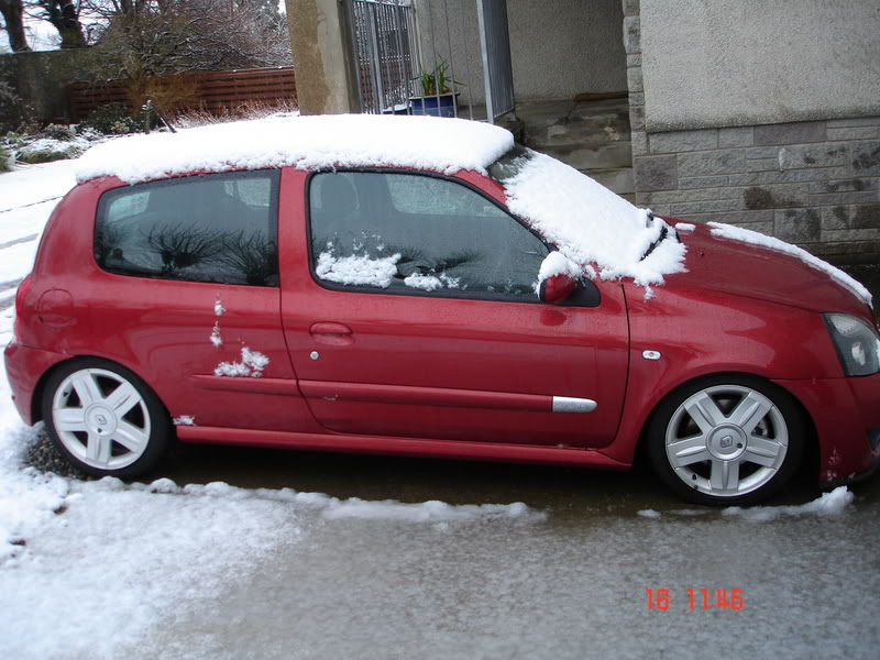

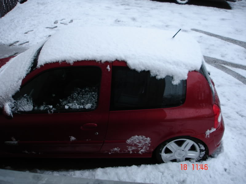

Melted alot now but last nite it was crazy! Bugger, coz i want to thrash the car now that the coils have been set up.
ALi
Have you got low profiles on your wheels mate? I got the same wheels as you and the effect of you lowering your car with the standard wheels looks mint. If so, what tyres you running on?
^^ You have the same wheels but yours are 15"s dude.
Those are 172-16"s on Ali's
Correct me if im wrong though.
Nice pics. Can't believe how much snow some of you are having, had nothing down here yet!
Looking lovely Ali (the car)
What happened with the turini's? And I didn't know you'd gone for coilovers too, whatcha get? Too low for me and my 4x4-coilover tastes though ;)
Out of interest, what geometry settings did you go for? I had 1.5 deg neg camber and 0'10 toe-out at the front (on the advice of Progrip), think the back was parallel with no toe-in or -out.
Nearly exactly the same!!! 1.5deg neg camber at the front. Opposite way with the caster, half a degree of toe in! On the back we had .5deg toe in aswell. We struggled a bit with the height. H&R and FK's are the same, there's an issue with the springs binding. But to get a decent ammount of tilt we had to lower the front a touch. It is low, but not as low as that pic portrays!
Turini's are keeping warm, (Actually i was running bald tyres so had no option)
Know what you mean about the springs - I had some of the coils touching one another too.
