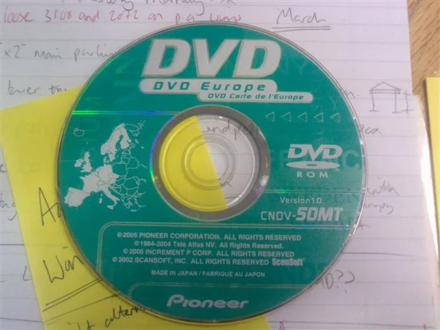

have you got the latest nav disc mate?
The disk I'm still using is the one that came with it:
Chris
My Map disc is attached below? Is mine newer or yours?

no you dont, it comes with the lead you need mate.. Nige i have that green disc but think there is a new one out
