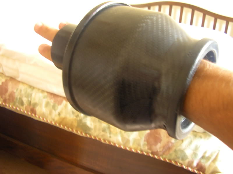

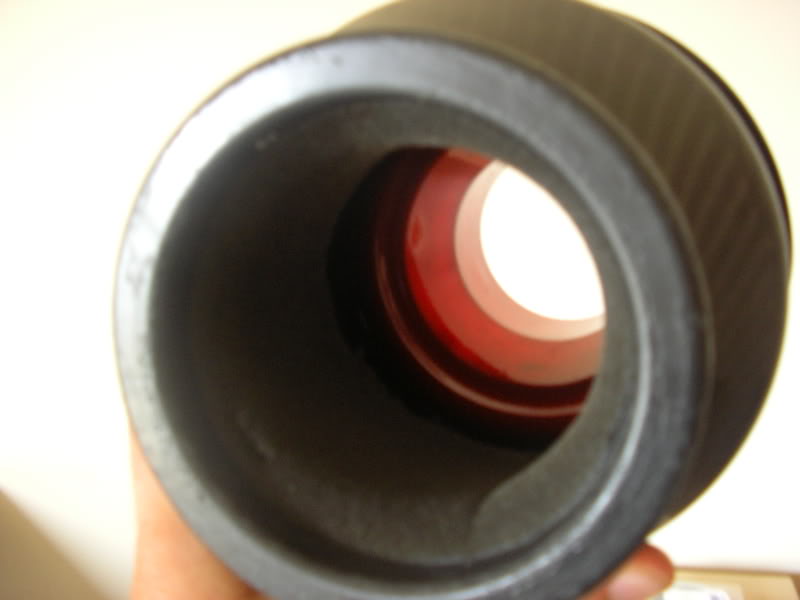

  Ph1
All it is is the housing, foam along the inside and at the back a piece of round foam glued to the side bits
mate, may have mis-read your post but you know you are missing the main filter part there yeah? you should not be able to put your hand straight through it!
  Ph1
I found it ran better with a hand through it lol ;)
Nah was just showing the build. Back sponge bit wasnt in the filter at that time as i was in the process of gluing it in.
Filter got shifted on soon after this photo lol
lol so you can take it apart but needs gluing back together!
