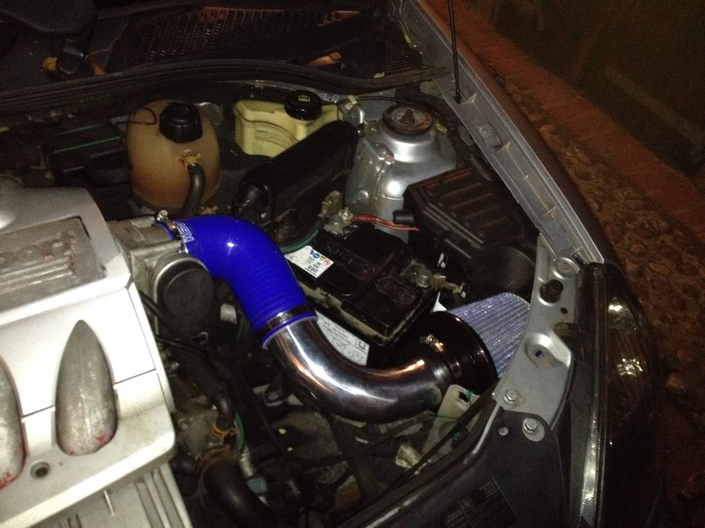

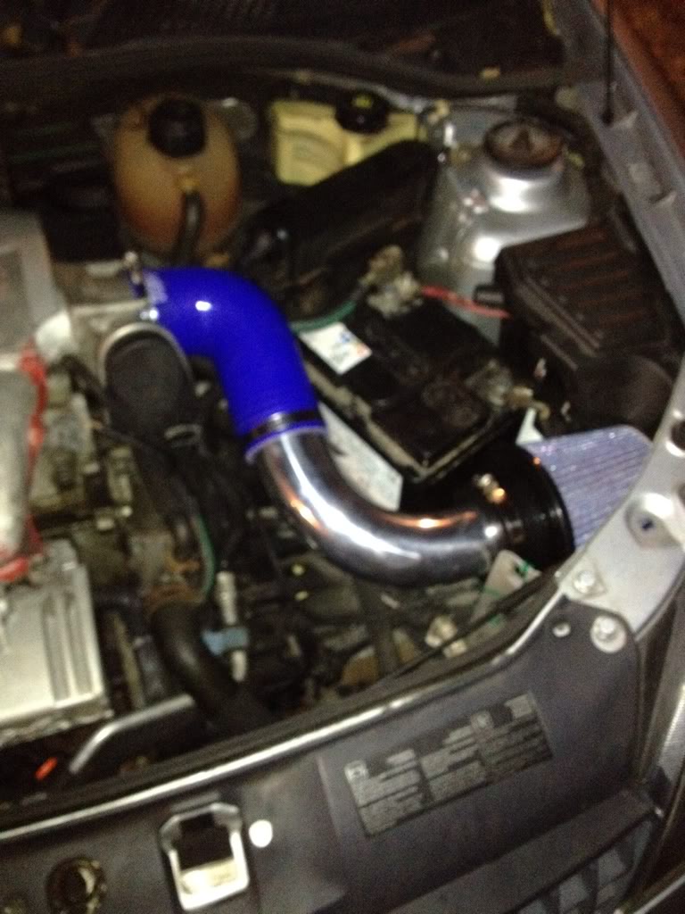

  172 cup
  172 cup
^^^^ not the best pictures and my engine bay is looking a state, which I am in the process of sorting, but as you can see fits well and was easy to do. Only done it last night so havent taken it for a real run yet.

Cheers for that mate, that looks a much better set up (if you cant afford the enclosed units) ... Ive already got the samco hose coming, so i may try and find a aluminium bend pipe like yours to take the filter away from the hot air...just need to find out the diameter later!

  172 cup
well i know that the pipe that fits on the throttle body is 70mm id if that helps. A quick note though, there are two different size batteries, an 075 and 063 type. you will need the smaller 063 for this to work.
  172 cup
i was going to do this aswell, ASH have all parts required to make at fraction of cost, did you use 70mm 45deg silicone hose and polished pipe ? does standard airbox hav a cold air feed that can be used with this ? looks good
  172 cup
I used ASH for the parts. ordered 70mm id 90 silicone bend ( you will need to trim some off throttle body end but it is easy to cut), 70mm od alloy bend, the ASH twin cone induction kit and a breather filter. however with the breather filter i ordered the 18mm id and it is a bit big so might be worth getting the size down 15mm iirc. as for the air feed i had the standard air feed which i cut to the right lenght.

Well i had the 075 battery in there at first and the pipe work wouldnt have fitted even with a small filter. this is the filter that is pictured http://www.autosiliconehoses.com/twin-cone-performance-air-filter-air-induction-filter.html fits in fine (063 battery), the diameters are on the website though if you dont like the design.
As for the heat shield, as said it is well away from the engine so shouldnt need it. plus its right on top of my standard air feeds. I do like the Ktec on but it is £120 more than what i paid for mine.
