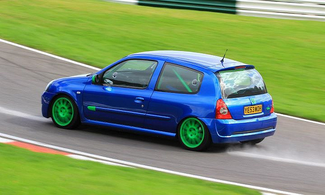

304144_2403005880259_1404475619_32927701_987099520_n by NorthloopCup, on Flickr
Not the best of pictures, but you get the idea. It shows the oe look black border as well. I'll take a close up later on if you want?

car looks great pal think al get some when the old wages come in. Had any issues with them leaking or when at speed?

Not had any leakage issues at all with them but they are slightly noisier than glass. Nothing terrible though. It's actually quite civilised when your sat on the motorway @ 70-80mph for saying it's fully stripped of carpets and sound deadening! Lol
