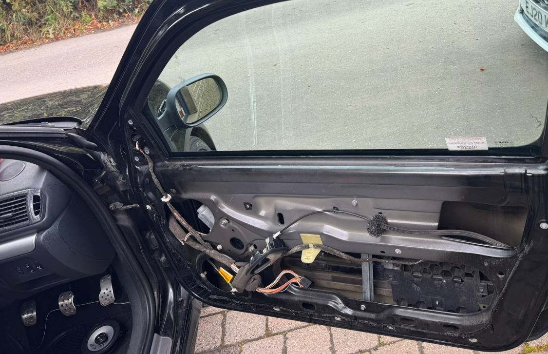

Yes - myself and a neighbour redid mine at the weekend. It's a fiddly job, but not so bad if you have some basic tools, somewhere to have the door(s) fully wide open and ideally, another pair of hands.
Taking off the window seals is very easy - it's replacing them that's the difficult part. I had a part that came off a donor Mk2 Clio and while the passenger side went on OK, the driver's side has a couple of small ripples on the edge. Not ideal, but the seals were free.
Taking the doors cards off will break the butyl tape seal and if OEM (like mine were) - can take some force to separate having been in situ for over 20 years. The replacement tape is cheap enough from Amazon however.
I took both of my windows out and cleaned all the mud and debris off the leading edges of the glass that is hidden away. Cleaned up the glass and added a little WD spray when reinserting them. The up & down motion is much smoother on both sides of the car now.
I still have the door cards off at the minute as I'm going to clean up the inner sections of the doors a little, tape-up the cables for added protection and I've got some replacement clips for the door cards themselves arriving. None were damaged that I saw during removal, but again, they are very old and cheap to replace for new items.

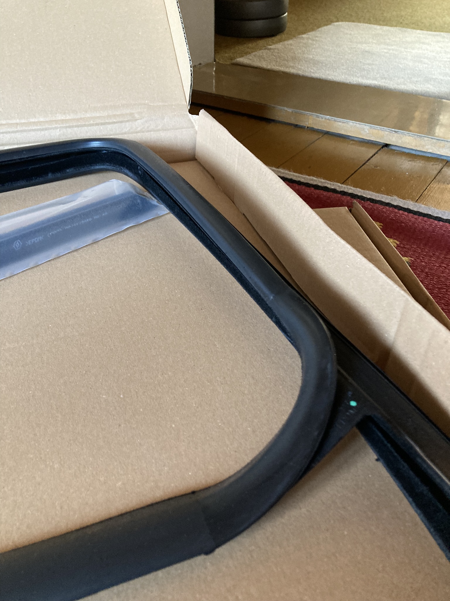

I'd be intrigued if you buy the new items. I would like to know how they turn up and if they are delivered perfectly flat, having the metal bars in them.

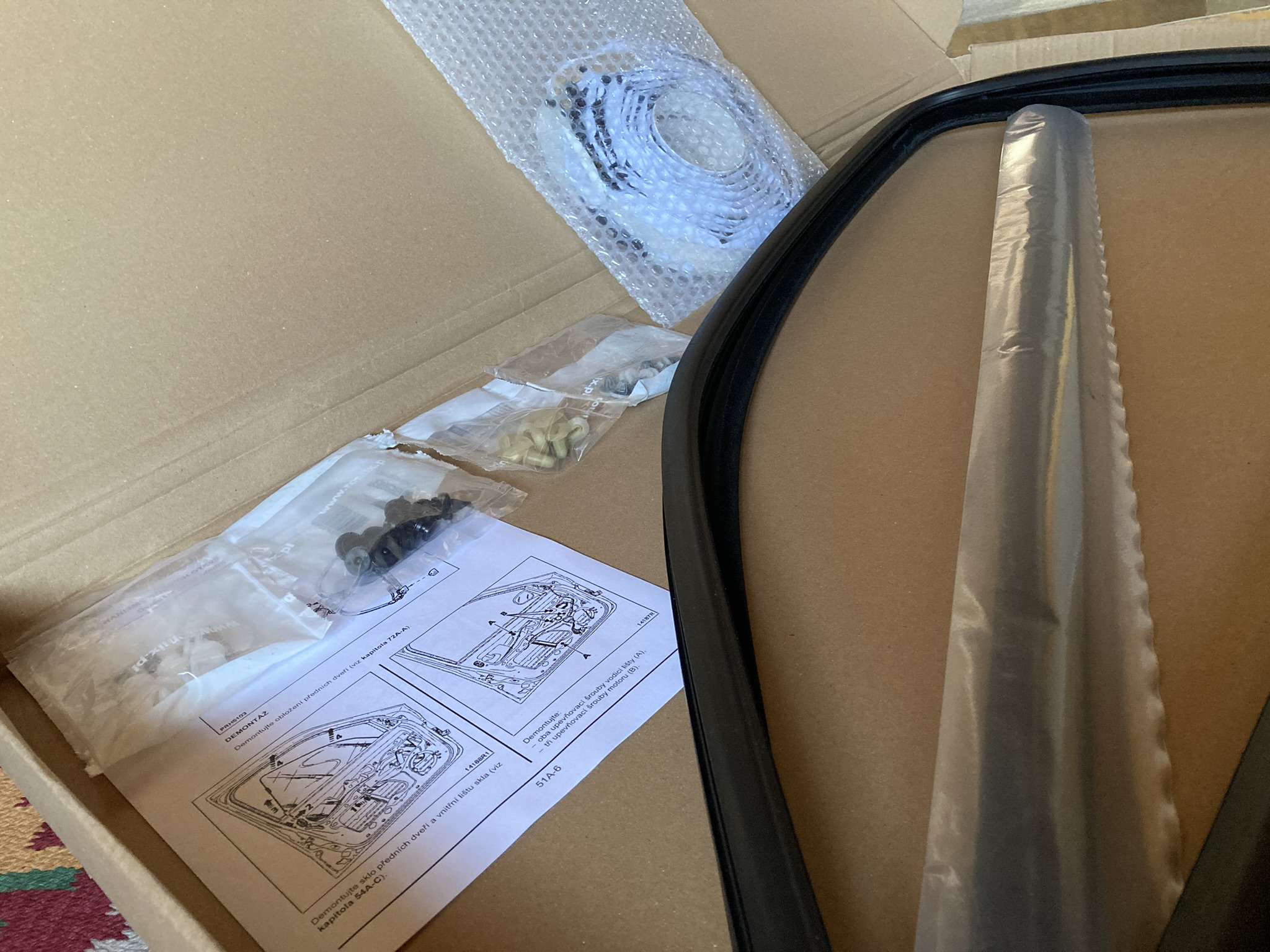

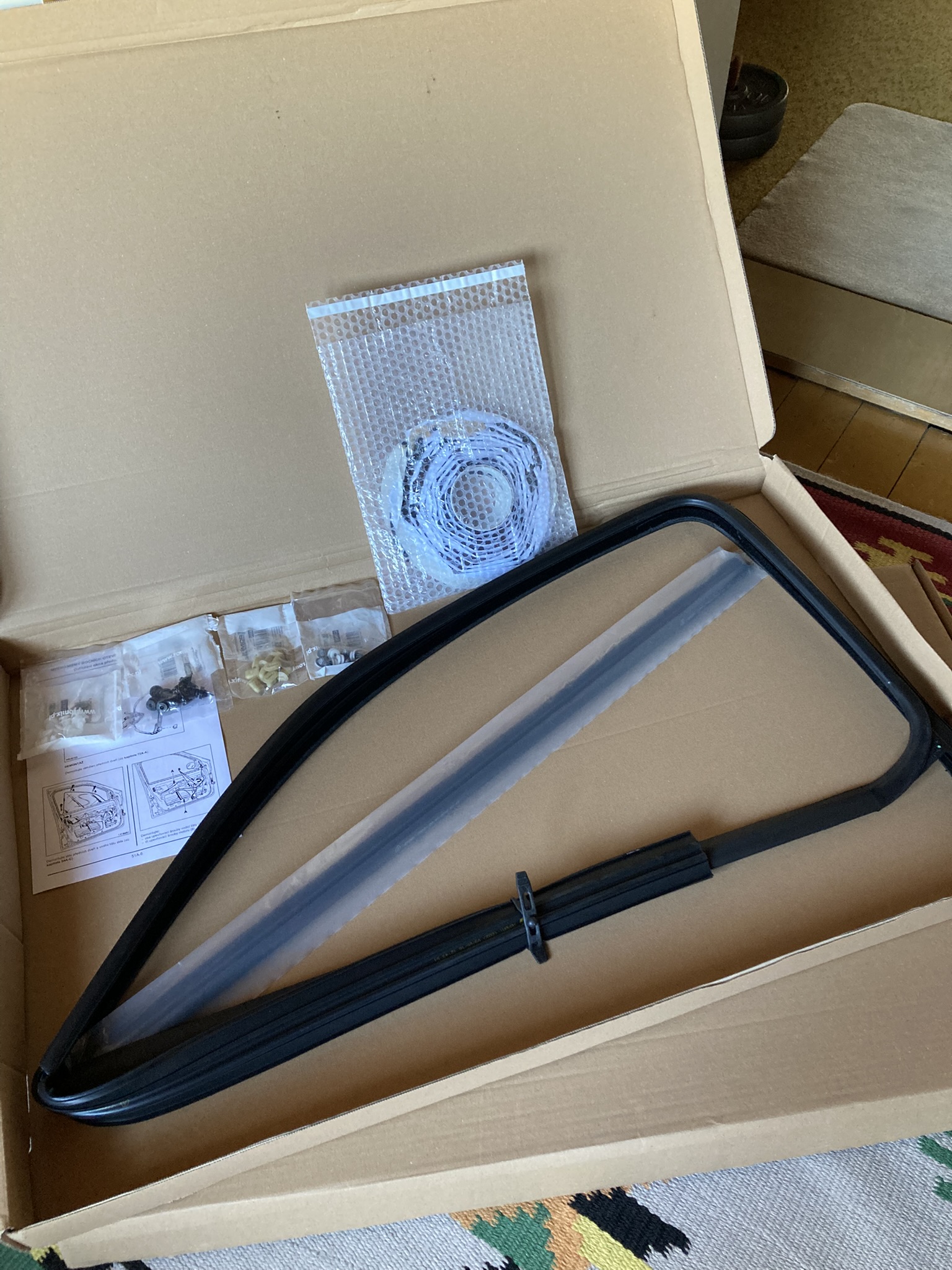

So as I promised here we are, new LH/RH window seals, nice and straight, new all clips, butil tapes and workshop manual, just for sure ;)

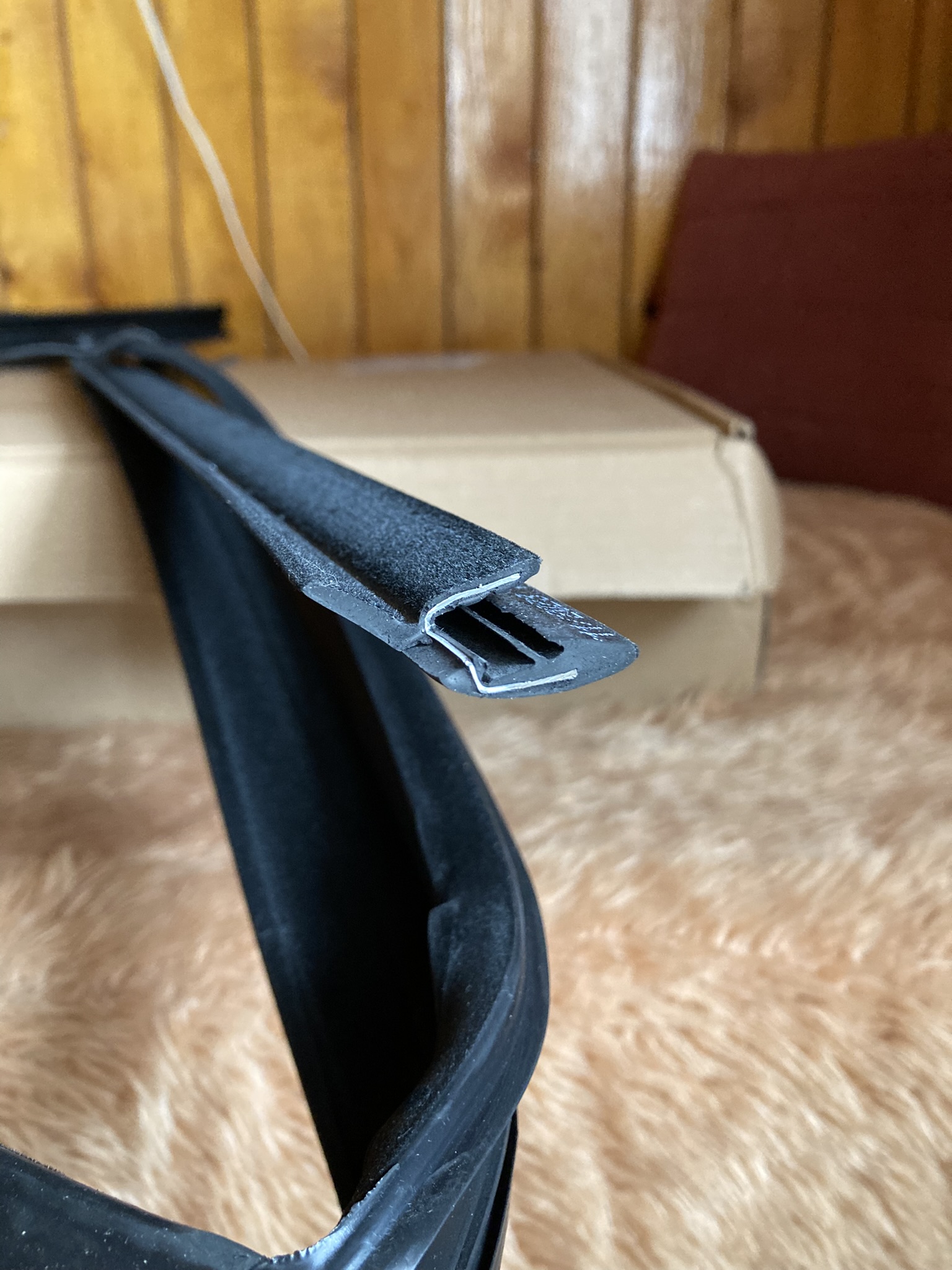

Is there any way to repair the original seals? My car has the rust bubbling under the rubber in a couple of places but the seals look good apart from these few areas. Is the metal under the seal totally enclosed or can it be get at without damaging the seal?
I don't think so. See a picture, metal part is inside a rubber. I think corrosion start here and continue inside, as mine are bubbling right behind the rearview mirror...
Ahh, no chance to repair that.
Yep, no chance unfortunately. If it's of any consolation - my originals were bubbling from the inside out also and I was worried that the rail of the door that they slotted onto may have started to corrode as well. Not an issue at all - I had the slightest of paint removal - approx 1 to 2mm behind one of the seals that I just coated with some touch-up paint beforehand.
