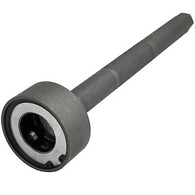

Removal tool required as you won`t get a spanner on it, plenty on eBay.

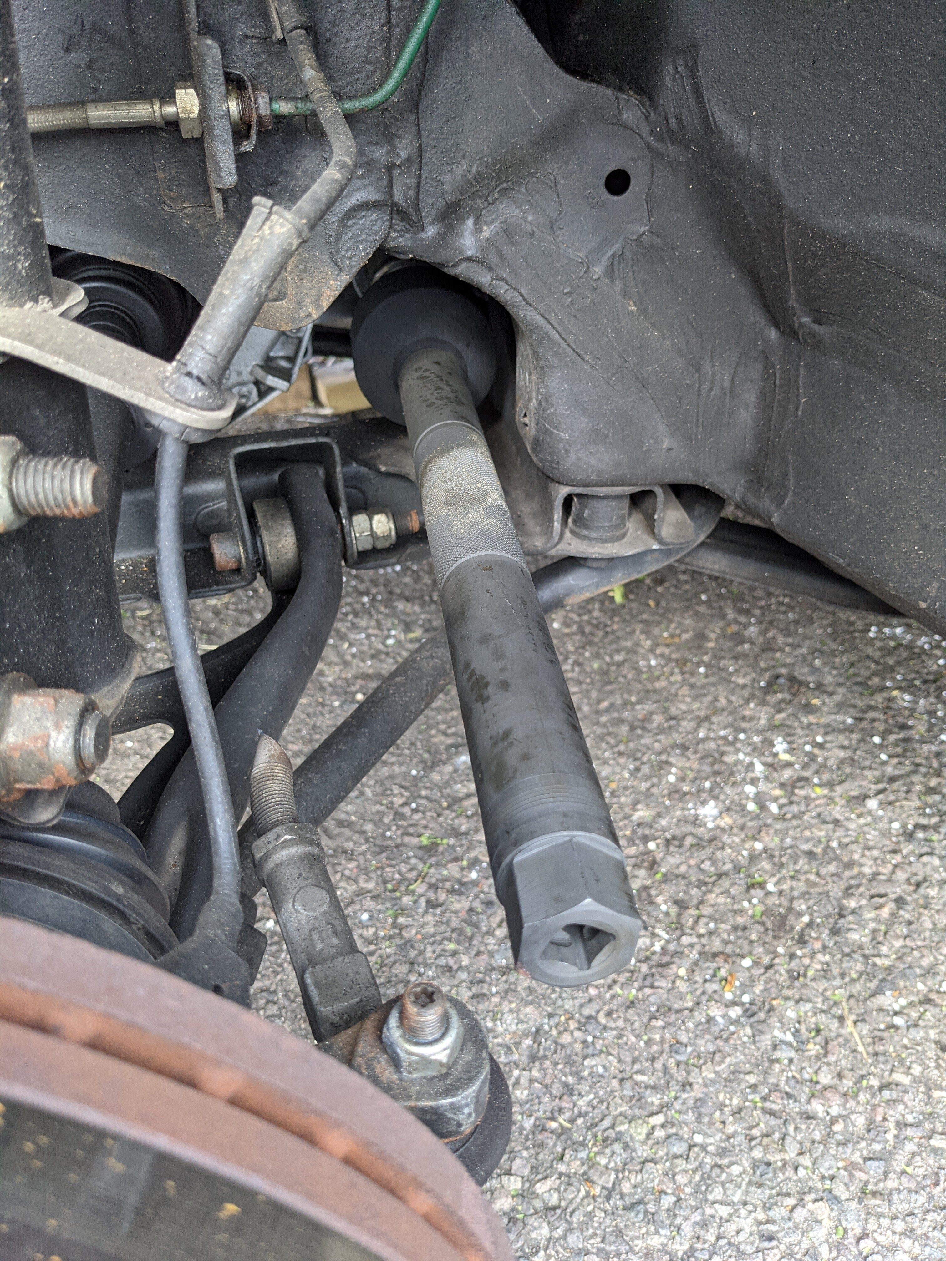

You can use a fan spanner cut in half but couldn't get enough leverage on it when I tried. One of the tools which goes over the tie rod made it 1000 times easier.
Oh yeh and the ones I got from ECP were waaaaay too small for my non cup. I ended up getting some genuine Kangoo ones which are slightly smaller but only by 5-10cm and still have plenty of thread for the TRE to go on.

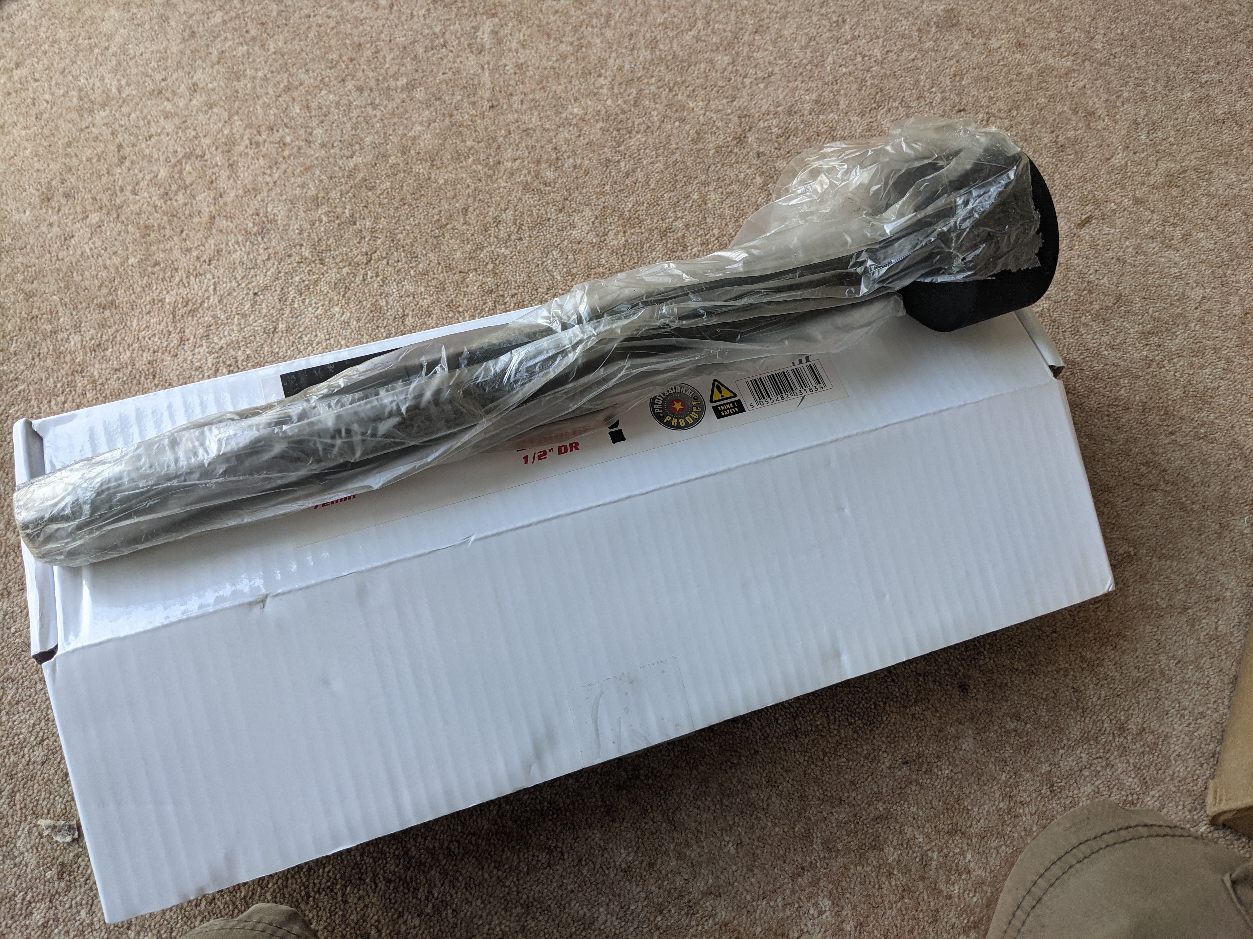

Has anyone got a link for the inner track rod tool? The link above is too old.
Yep, 28-35 is what I got as well. Just gone back to 2016 and checked my emails.
Makes the job 10000 times easier.
Thank you very much both. Just ordered it!
