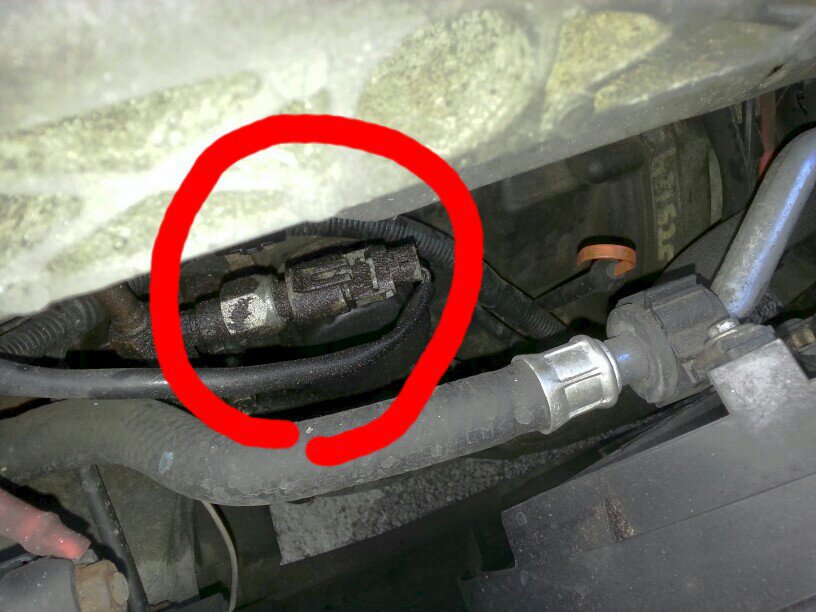

Hi guys. I've found a leak under the bonnet at the front of engine. Please can someone tell me what this is. Its a clio 172..

Thats power steering. Sensor is for pressure.
