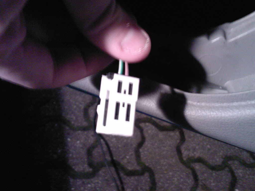

Just bought a set of Alpine SXE-1325S speakers for the front doors.....
Unscrewered the old ones off, and for aynone whos done this will now theres a small white clip on the back that you simply clip off the speaker to release it: as shown below

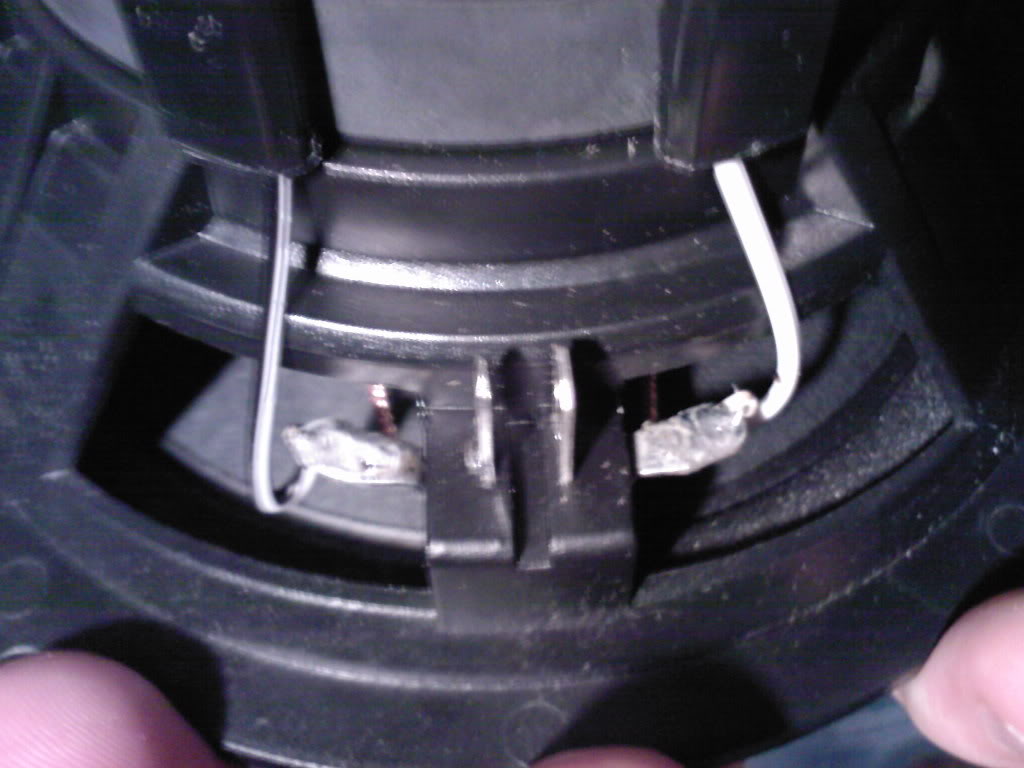

The problem is the clip will not clip on to the back of the alpine speakers.....as the "pegs" (probably not the correct word) are facing the wrong way as shown below:
Just wondering do i have to cut the two wire above the white clip and thread them through the hole in the "peg"....just worried about cutting the white thing off........
Please Advise - I need help !!!!

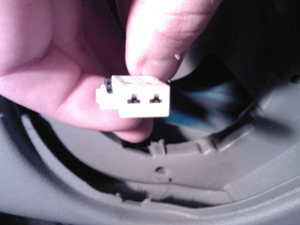

Here the otherview of the white clip - so the "pegs" on the back of the alpine speaker obviously wont just slide in as their facing the wrong way:
Hi,
I had the same problem, you can either buy an adaptor to go between the plug and the speaker, or you can cut the plug off and buy the connectors from somewhere like maplins.
I forget what the connectors are called, I'm sure someone else on here will be far more helpful!
Remember though that if you decide to cut the plug off, when you come to sell the car you might not be able to reconnect the original speakers ;)
yer my dad just come home now with his crimping set !!! thanks....hes sorting it out now...thanks for the advice guys !!!
