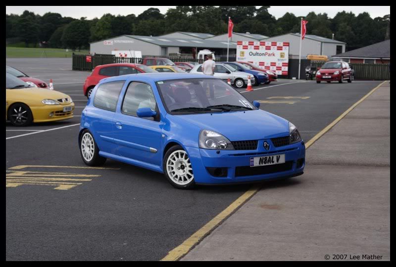

Running 195/50/15 Toyo R888's
Photo shows Eagle F1's but they came off straight away;)
Done Donington GP & Silverstone GP, totally changed the car from running on the 16" turinis.

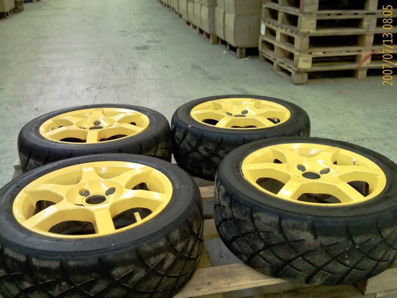

I've got an old set of Dynamique 5 spokes for road use and some OZ F1s like Steve above along with a set of TSWs (no idea what they are...err, they have six spokes) for track.
I've run Yokohama A032s (205/50/15), Dunlop D01J (195/55/15), Dunlop Sport wets (not sure of size) and Yokohama A048s (205/50/15).
To be 100% honest I couldn't really tell the difference between grip levels or behaviour on any of the different dry tyres. Compared to road tyres there is no comparison to make...it's like night and day.
On the wets in the wet though, the grip level is incredible. Makes me laugh every time I turn in when it's greasy - "How the f*** can it do that?!?!?".

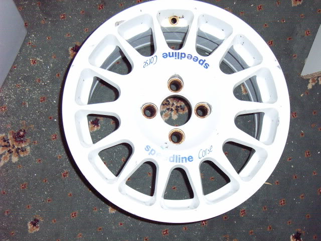

best wheels you can get for a Clio
and this pic the Tyres are part worn Clio cup slick :D
Will have a used set up for sale seen just need to finish the slick off
  Clio 172 ff
Thanks so far, guys! Seems like 205/50-15s is not the worst choice, then. Loving those Speedlines and the black OZ F1s. Speedlines are almost impossible to get over here, though, but I'm currently having an eye on anthracite OZ F1s off ebay. I just don't know if they have the correct centre bore. 60.1 is what the Clio needs, right?
