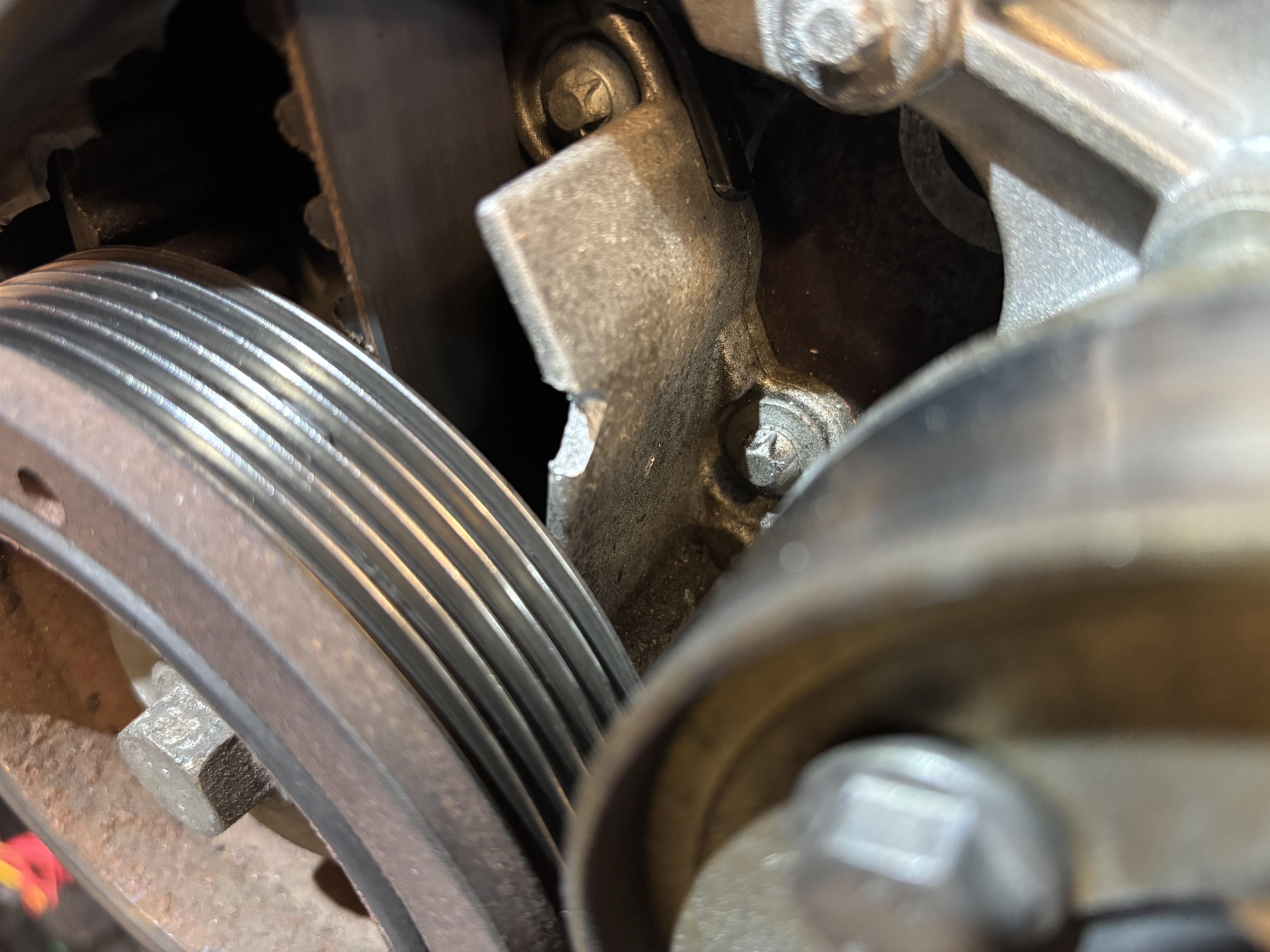

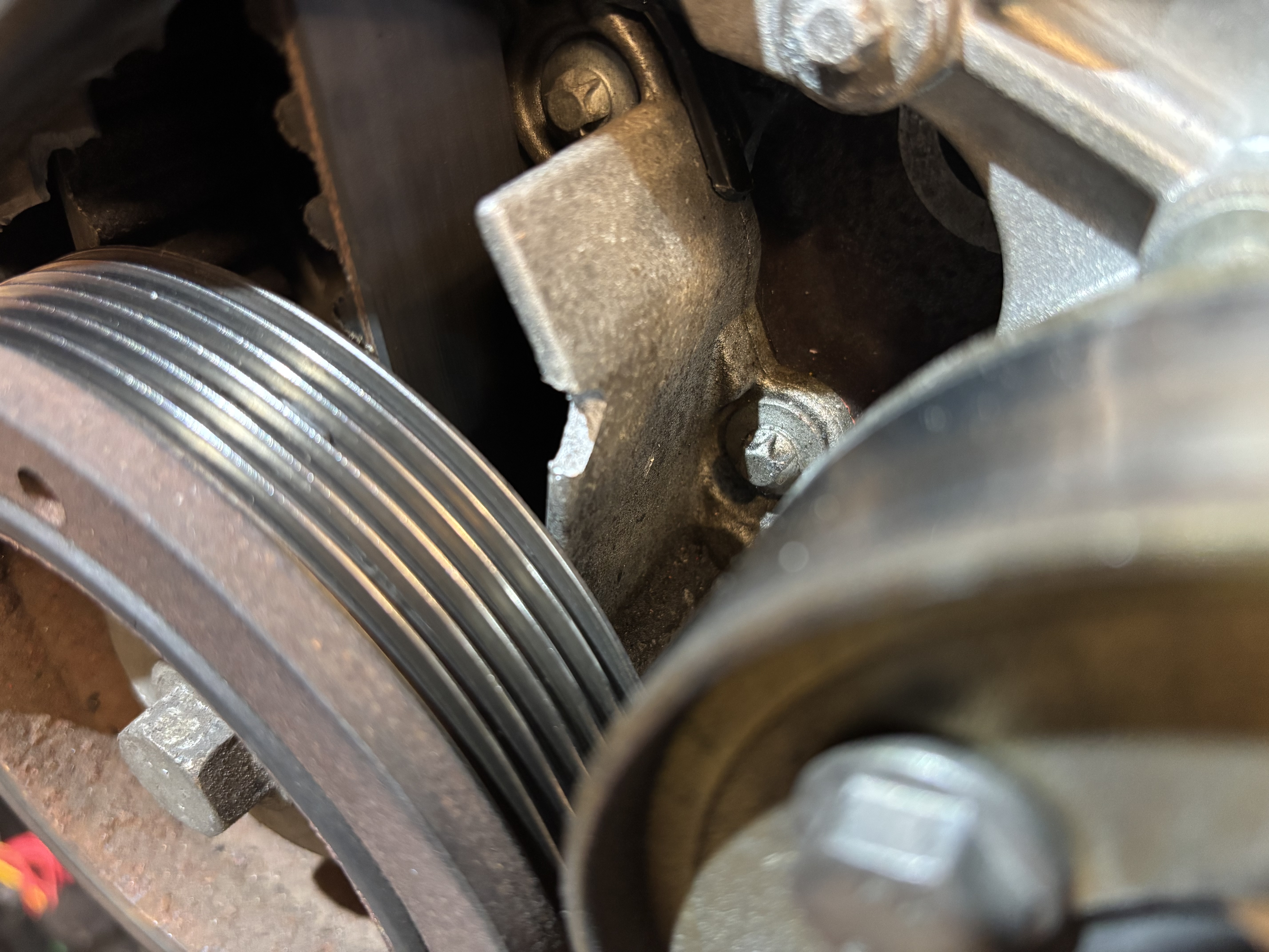

Any idea how this is supposed to be fitted? Does the crank pulley need to be removed for this to fit behind it?
Must use the same as this one, would have minimised my aux belt catastrophic fail

I had the genuine RS one from a MK3 cup racer fitted on mine, with some slight modification.
No one was making them for MK2 at the time.
Definitely worth doing I'd say, you never know if it'll save the engine one day.

How easy are these to fit? Any downsides?
Mine is going to Birchdown next week, might see if they can fit it for me if it's just a simple bolt on job.
Easy to fit if they are doing belts, I think to fit it afterwards you would need to redo the aux belt entirely

Yeah the APM one is the genuine Renault Sport item, the same one i had.
It's made from stainless.
