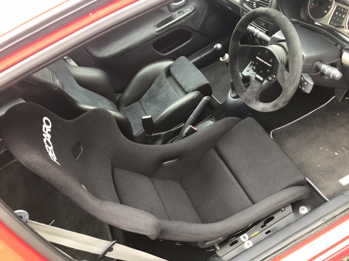

I am thinking of getting a Recaro pole position instead of the Recaro trendline that's in, as I want to run a harness on track. I have the Jon foz lower subframes for my trendline will these work with a pole position or will I need the side mounts as well.
They work with the Recaro side mounts and sliders.
Fitted some for a mate. Subframe holes require drilling to suit the bolt spacing, but you get that with all seats.
