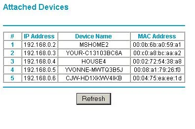

Go to http://192.168.0.1/ Login ( If http://192.168.0.1/ Dont work tell me your router name/model and i will get the right link )
Look around foor 'Attached devices'
and it should come up with some thing like this ( Shows ALL People connected to ur wireless router )
(Don't play with any settings in this Its the router configuraion )
