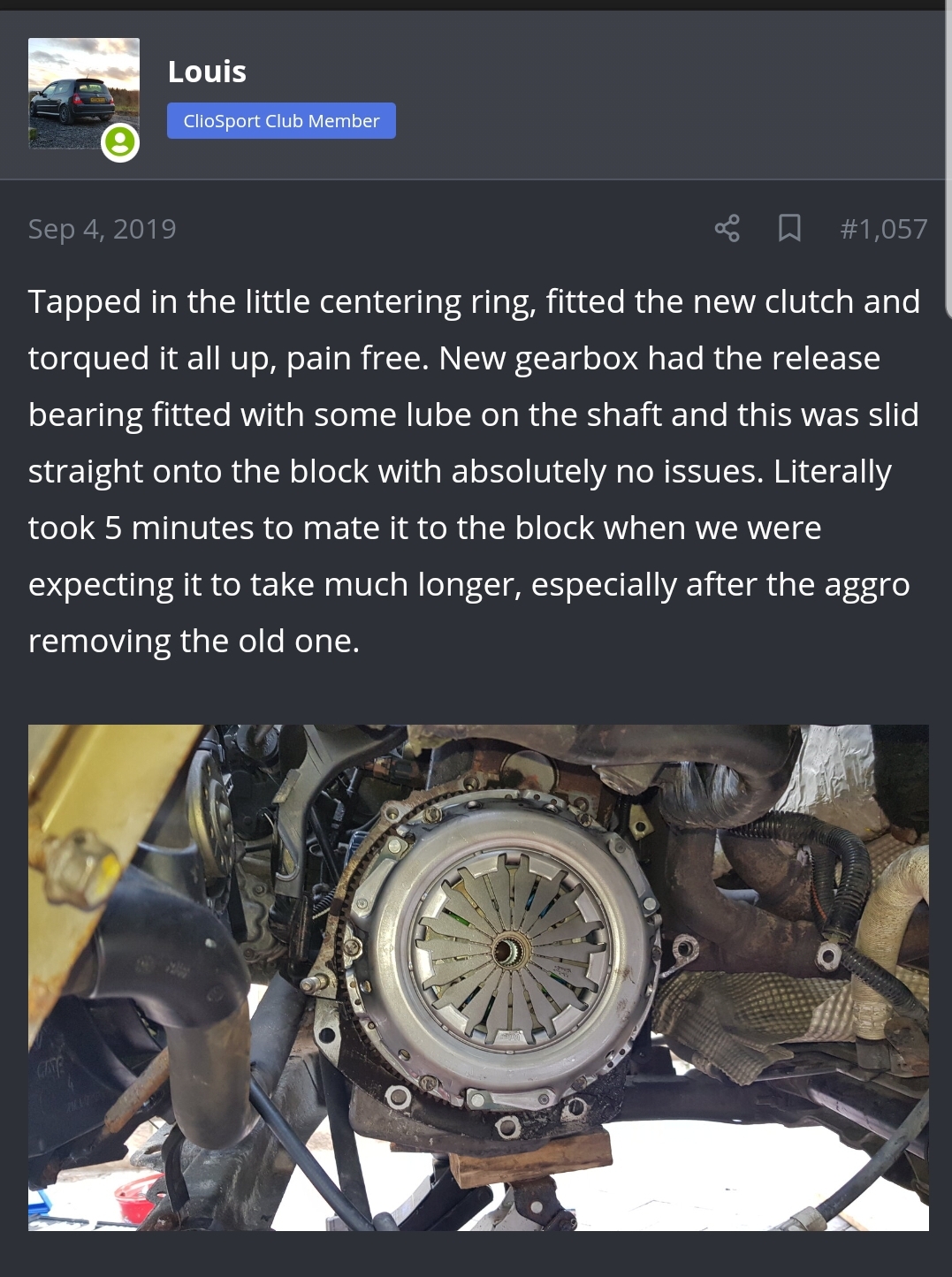

Just checked my post on my thread and we did put a tiny bit of grease onto the shaft. Reckon this is the issue?
Reallllyyyyy dont want to pull the box out again 😭😭

I never put grease on splines so I can't think why we would have mate. If anything I think I told you to clean off the splines in the box and the guide tube and only put a tiny dab on the ball where the fork goes 😂
It was a while back now so I've no idea! We definitely put grease somewhere but didnt slather it because of it catching all the clutch dust.

In the service manual it states that you use a bit of grease on the spline.

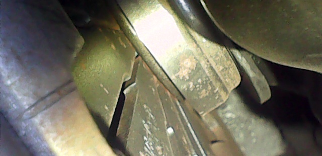

Been at it all evening and not really got anywhere? Started off trying to look into the box and see if I could watch the input shaft but doing it alone I had no chance. Hardly any room in there even with an endoscope cam.
Nothing really looks untoward and it's not caked in clutch dust which is a bonus?

Clean the clutch shaft splines and refit the assembly without any lubricant.
Coat with MOLYKOTE BR2 grease:
- the tube guide,
- the fork pads.
Section 20-2 the Bible
- the tube guide,
- the fork pads.
If anything went into the splines it was a tiny bit of moly. And I mean tiny, I genuinely cant remember now though!
