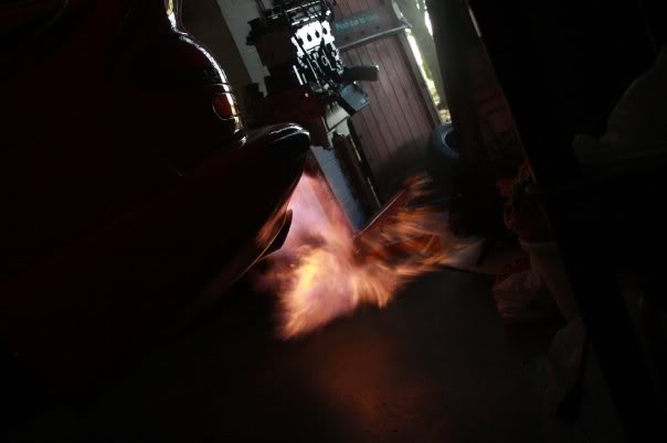

Yes, quite aware of how an omex works lol, I fit them. Overfueling on overrun isn't right, I promise you. By retarding the ignition on overrun you raise EGTs which gets the exhaust hot, that's where the pops and bangs come from. By overfueling you're just cooling down the exhaust gasses. excessive acceleration fueling will give big flames if you tap the throttle and have retarded ignition on overrun.
this was yesterday afternoon lol
