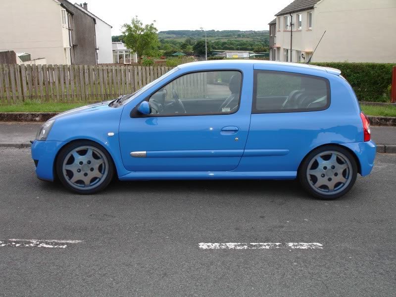

Look on here for a guy called h4ml3t he has merc wheels, he's done it through adaptors, if these Porsche wheels are 4x100 they will fit if anything else adaptors will be needed.

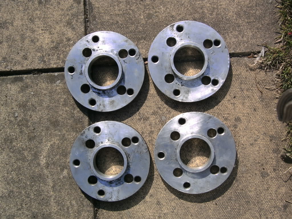

you will need 4x100 to 5x130 PCD adapters

That Clio with the Merc wheels on looks epic... So unique!!

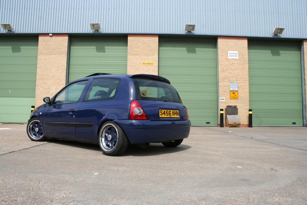

Theres loads of various porshce wheels, Cookie Cutters (mine) Teledials, D90's.

You've also got to think about wheels rubbing due to offsets etc, dont forget the spacers are about 30mm thick!
get yourself on clubpolo mate, all the polo boys use these adapters as polos are 4x100 aswell. you will need the centers bored out to 60.1mm to fit the clio.
any engineers can do this I paid £20 to have mine done.
and yeah that was my car. miss it masivley, also had 944 porshce seats in it too!
maybe slightly, I think the D90s are ok as they don't really have a dish.
you would need the center of the adapters bored out, VW center bore is 57.something renault is 60.1.
apart from that they'll go right on.
Nope, Center bore is 60.1

basically my cookies fitted but only with camber bolts (I say camber bolts it was two washers on the stib axle)
there was alot of rubbing, but as said the cookies had a dish on them, may be different for the flat faced D90s.

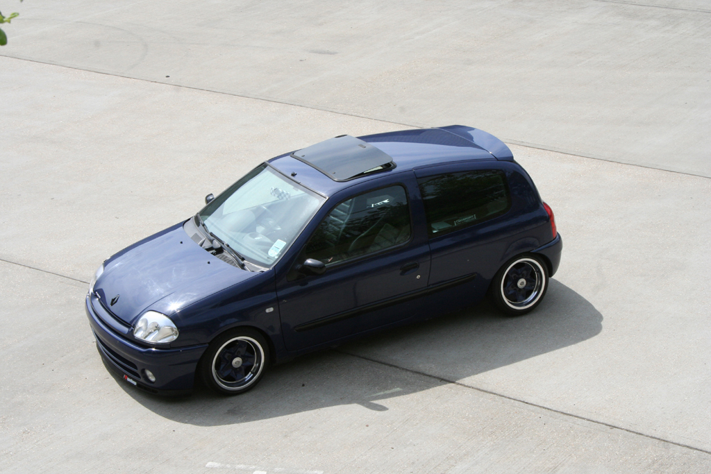

theres a little bit of poke there, I could see some rubbing happening depending on how low your car is.
It's as low as it is in the pic above. I think the alloys above are 8" rears whereas the ones in the eBay ad were 6" on front and 7" rears.
