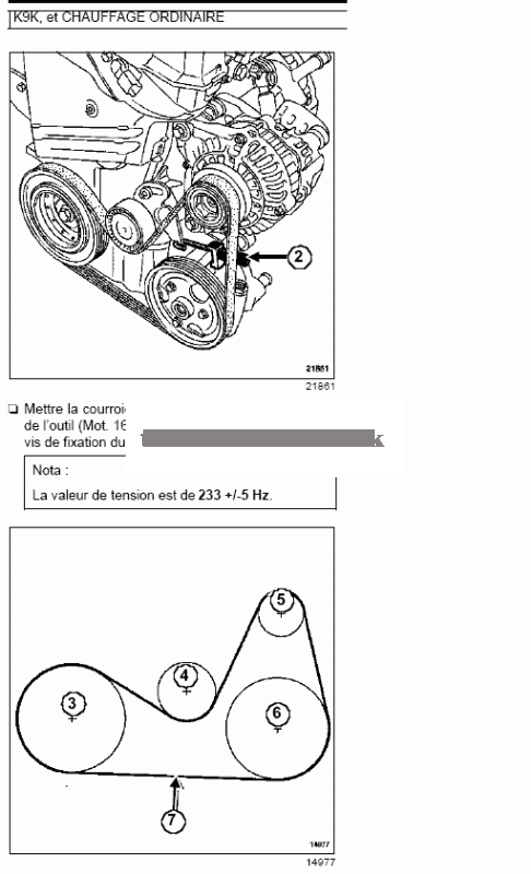

The idler has more grooves from memory. Belt should be on outer grooves all the way round (furthest from engine block) as per Renault tech notes.
If its manual tensioner i made a tool to get the tension on the belt, its a nightmare without
You cant really get a pry bar on it. I made this - copied and pasted off TurboRenault...

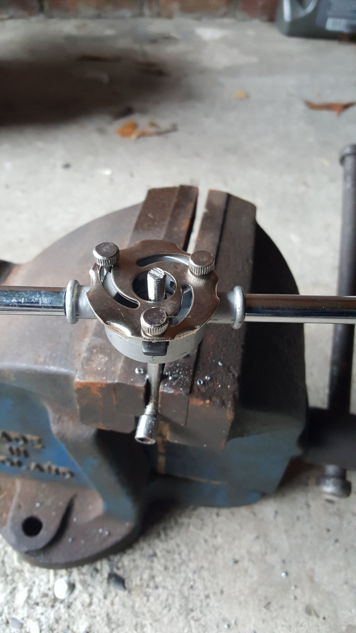

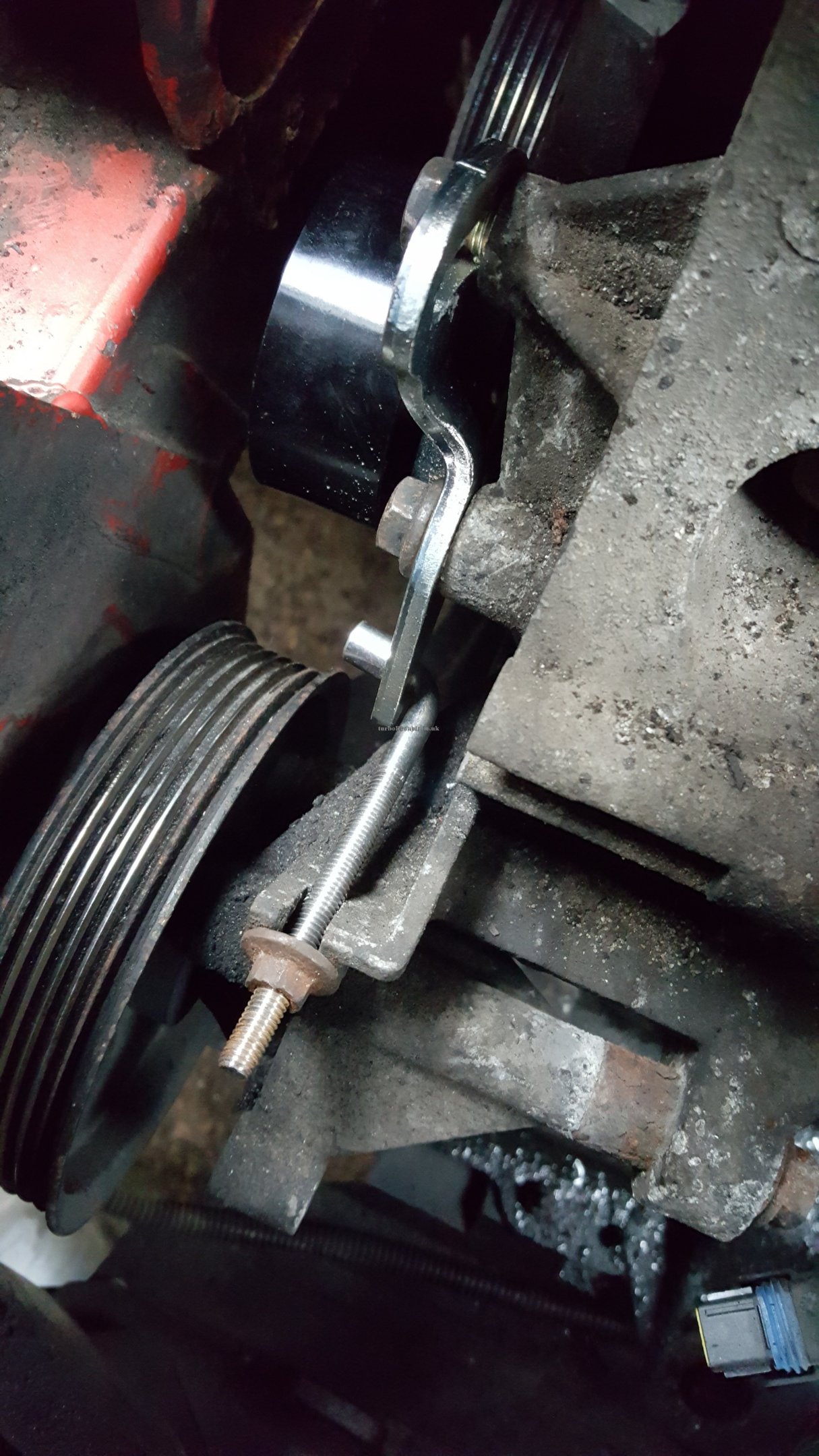

Todays update. So time to get the alternator on. The manual tensioner is a b*****d to set as you cant really get anything in to get tension on it. Last time i borrowed a big snap on pry bar and had @Sheryl_O pulling it whilst i nipped it up which was a bit heath robinson but worked but put stress on the alternator. Renault have a special tool to tension it which i do not have as per lol
Looks fairly simple to make?? I went through the big box of shite and found an old shitey cranked spanner. Cut one end off and forced a m6 die over
And we have one tool that worked epically to tension the belt
Boshed it all back together, nipped up the pmt tensioner and nipped up the bolts. Removed tool and big fire up sounds 100% better, tested alt just over 14 volts that will do me..engine idles smoother win win all round
