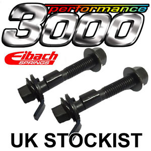

Now my tracking is out and all needs sorting but also I seem to have noticeable positive camber,what I was wanting to know is should I look into getting some kind of camber adjustment method such as camber bolts before taking it in to a garage as I don't presume the car has any adjustment anywhere for camber as it is and I don't want to be paying for it to go in twice if it can't be sorted first time round.

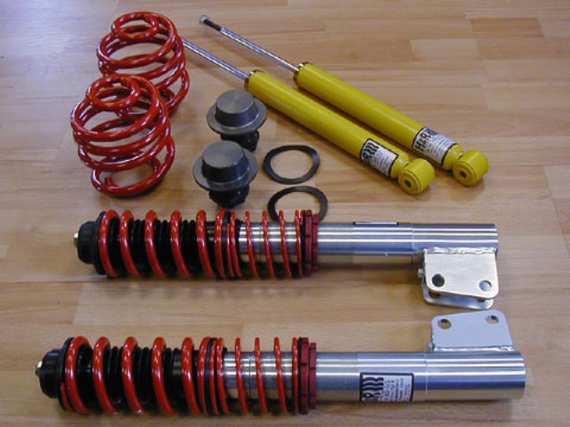

Is the top hole slotted? If you can try and upload some pictures of the camber you have now and also a picture of the coilovers.

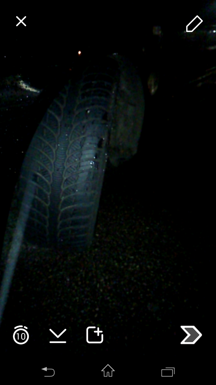

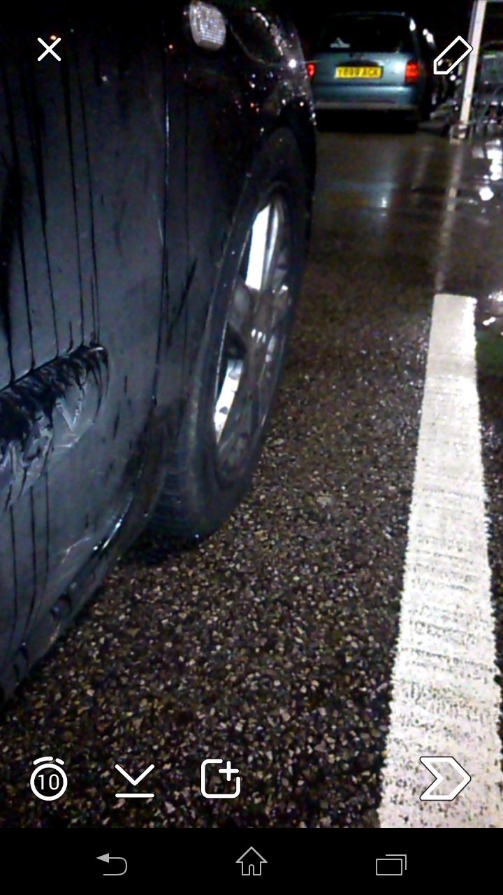

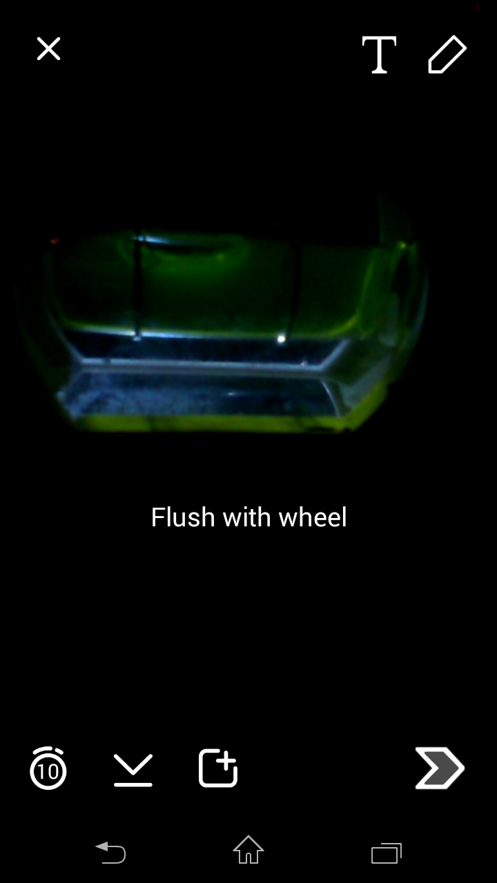

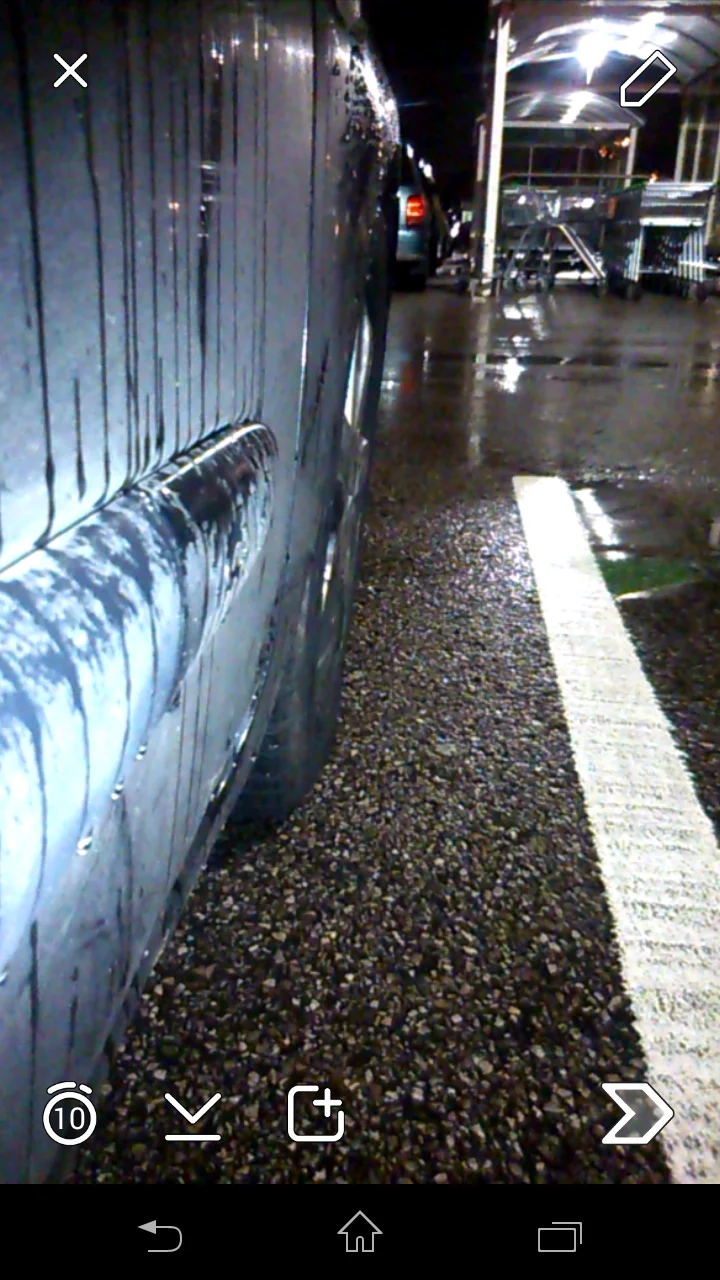

You can't see it too well from these photos but the level shows more accurately how the wheel is cambering
The drivers is the same as passengers the level in the photo is of the drivers side with the wheel being against the left hand side of the level

I presume my options if the coilover are defintly fitted correctly are to either get something like these:

What coil overs are they?
