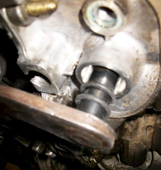

When you come down to clamping the plastic bits arround the two o rings.
This is where we begin with the modification.
Leave the shaft as it is do not clean it (needs to be a bit greasy!).
It should look like this at that point :

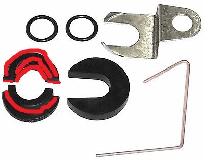

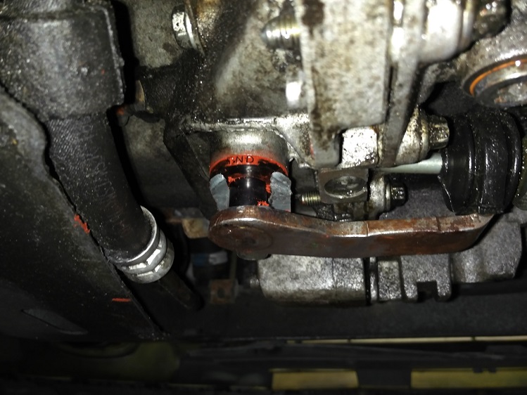

Put some liquid gasket arround the outher side and the inside on both parts (as marked)
Sorry my paint skillz suck :tongueout:
Then put these arround the o rings and jam them in!
Secure it with the metal clip and your done!
I waited 2 days before i filled the gearbox up, give it enough time to dry.
I have driven arround 50 miles now so far and no oil has come out, its not even sweating!

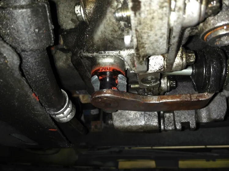

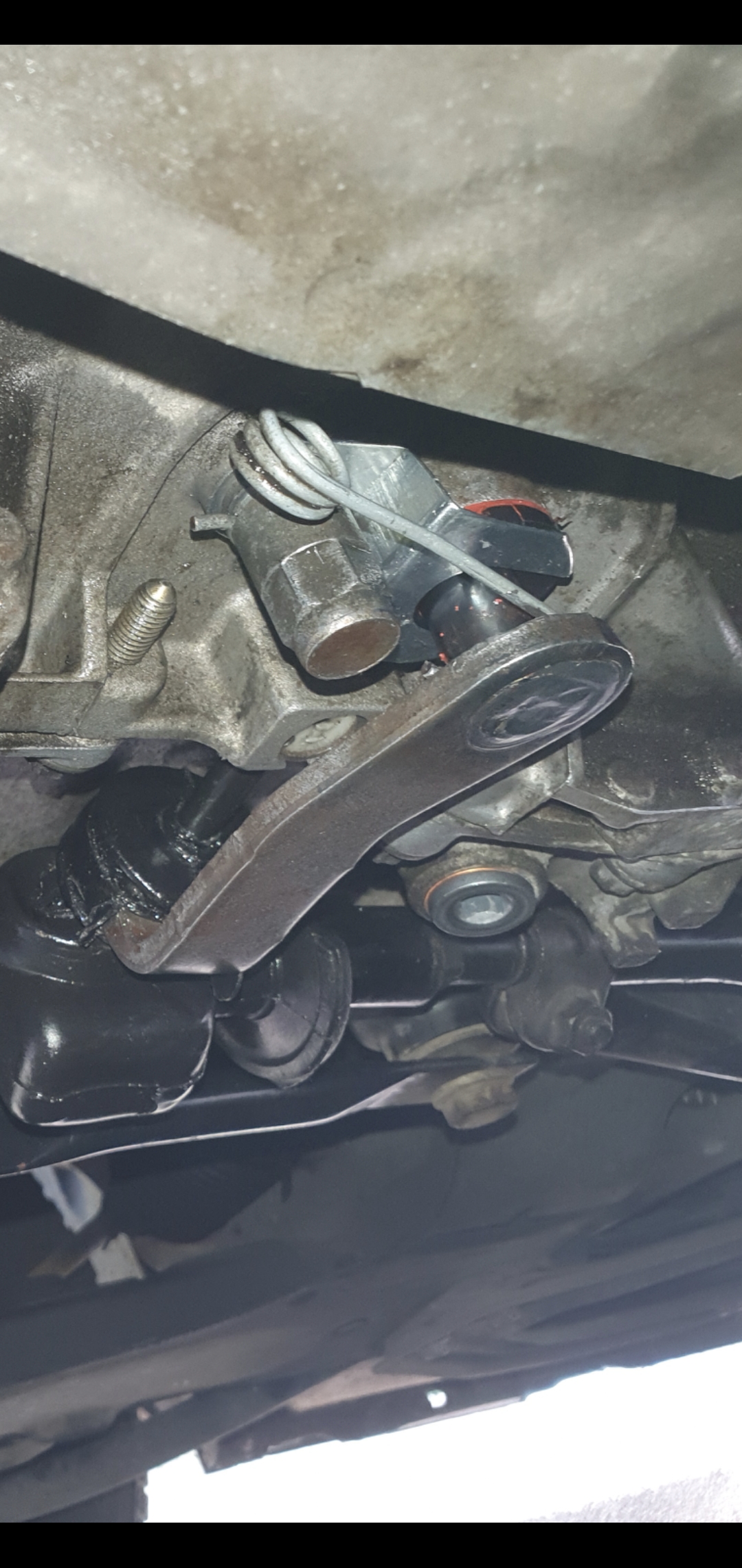

Hi,
i think most of you don't have your clio 2 anymore. I still own clio 2 1.2 16v with jb1 gearbox. I applied this method with high temperature silicone seal and actually it works. I drov 100km and there is not even a drop of oil coming from Selector end. "BUT" it is very very hard and difficult to shift it was a nightmare, after applying grease to the Selector end it is now shift very smooth. Thanks for help
