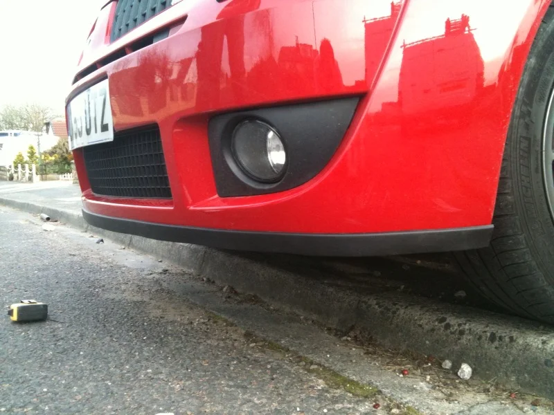

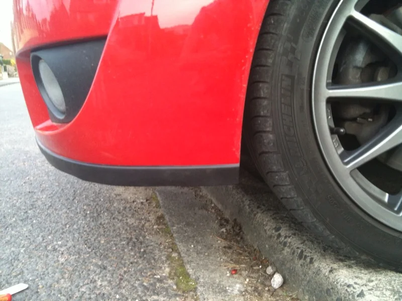

Just fitted mine now, only took 10mins. I used 3.5x20mm self tapping screws (about 10 of them) & cut off each end flush with a sharp stanley knife.
Pics from Iphone so not that good quality
