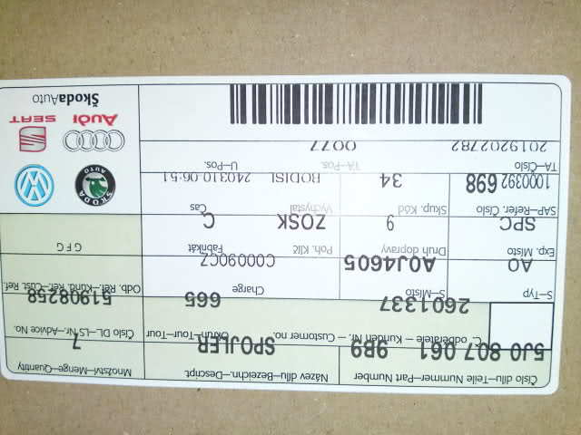

Alrite guys,
I managed to bash my original one the other day, can anyone confirm the correct part number? 5J0 807 061 9B9 or 5JL 807 061 9B9
Cheers.

Here it is!
Cost me £14.32 but i think that's because it came from the Warehouse within a couple of hours! dealer didn't have them in stock but they were having a delivery to which they kindly added this to, top service!!
