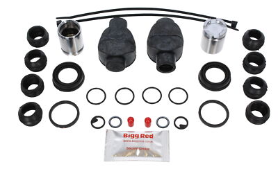

I re-built my rear calipers with this kit. If you watch a few videos on youtube you'll see it really is a pretty straight forward process.
I bought the whole kit and used maybe half of it. Once you get in there you should be able to see whats worth changing and the rest just dont worry about.
Took me an afternoon to get them back to good working order.
Thanks ill give this a try
