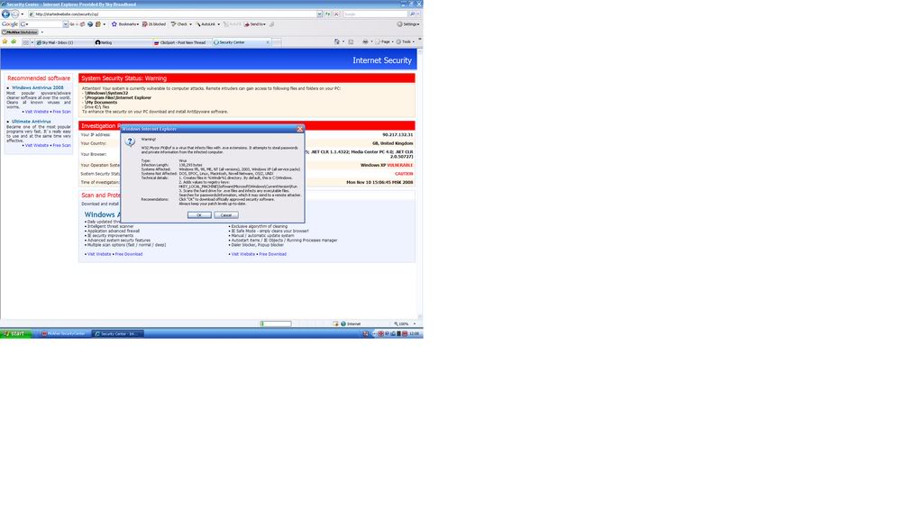

Hi,
Last night our internet stopped working, and some flashing icon in the toolbar appeared. If you click on it it is a direct link to some werbsite called Virus response lab 2009. It also keeps popping up SECURITY WARNING!?
Anyway rang up sky (My provider), We changed the Firewall to default settings.
The internet is now working again, however everytime i open an internet browser a page opens up saying Security Centre.
How do i remove this item? Also the page that loads?

  Rav4
Hi,
Runt he following in the safe mode including networking mode
Please install this tool and download ALL the updates.
http://www.spybot.com/index2.html
Run the tool and restart the machine.
Then download this tool,
http://www.malwarebytes.org/
Please install the tool and all the updates,
Run it, make sure all applications are closed.
This should resolve the issue above.
Both are free tools.
Thanks,
Gabi.

  Rav4
Wicked,
Glad you got it sorted.
