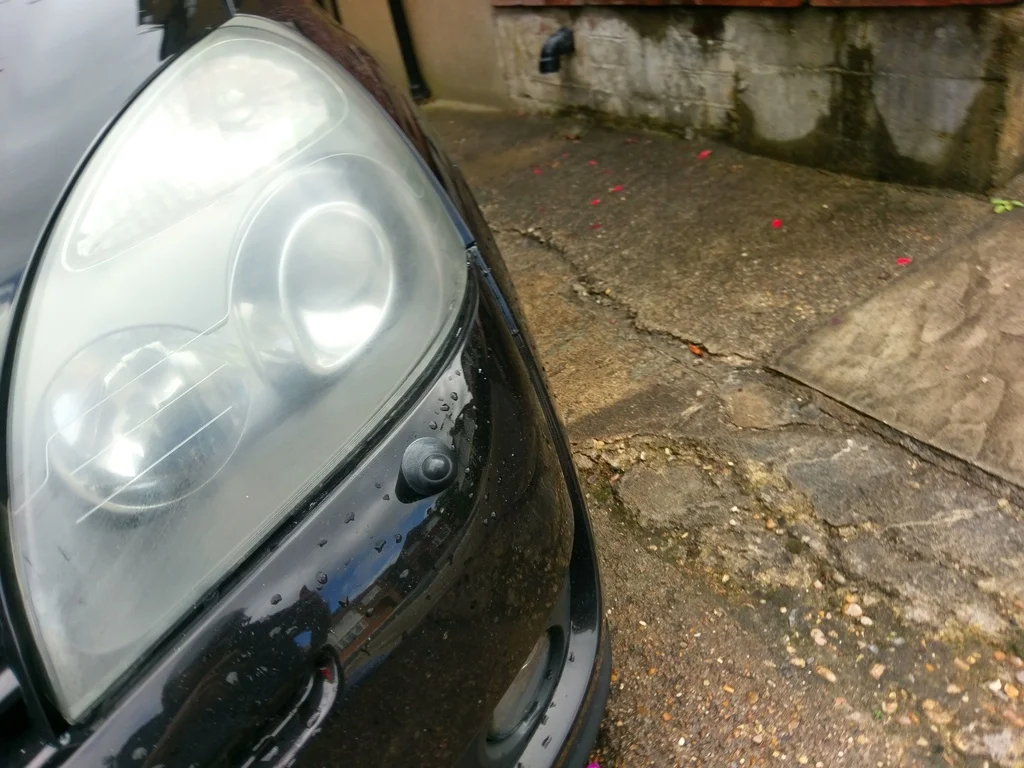

  • Clear the fogged headlight lenses

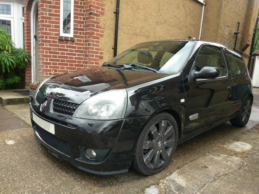

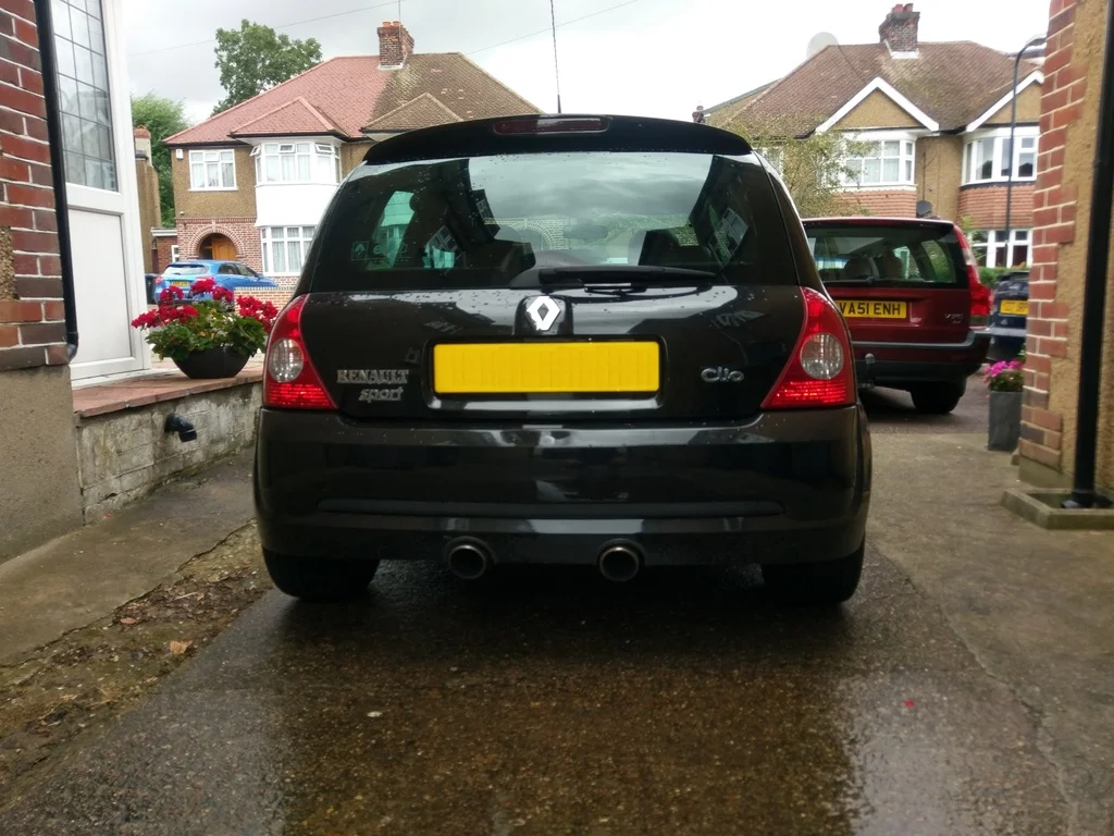

Enough waffle, here's the car as it stands:
It's arse:

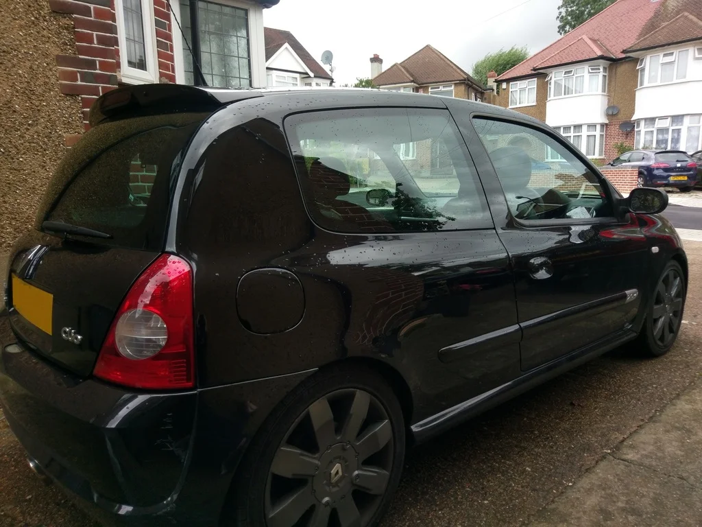

Starboard:
other Starboard:
Cataracts:

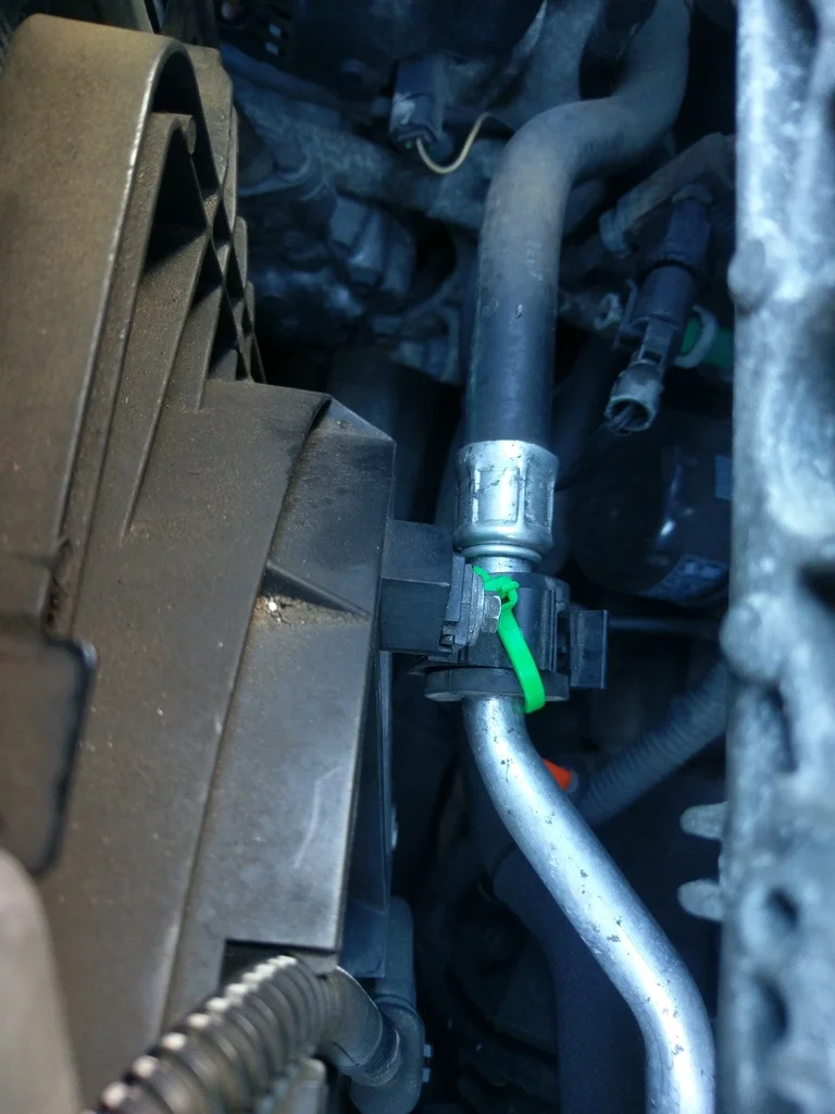

1. Any idea what this cable-tie is holding together (below the fuel guard and just behind the radiator) and how is this usually secured?:

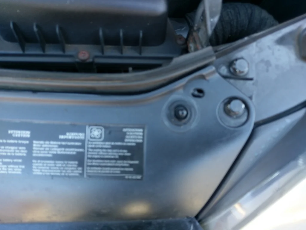

2. You may notice from the below picture that my grille is not secured... after much lurking I'm still not sure what the rights clips are to secure the grille to the chassis:

Lovley looking car matey! It looks like that cable tie is holding together the black clip around the pipe which as that 8mm bolt into the fan. You could get a new clip out of a breakers or renault but id say the zip tie would do the job indefinately

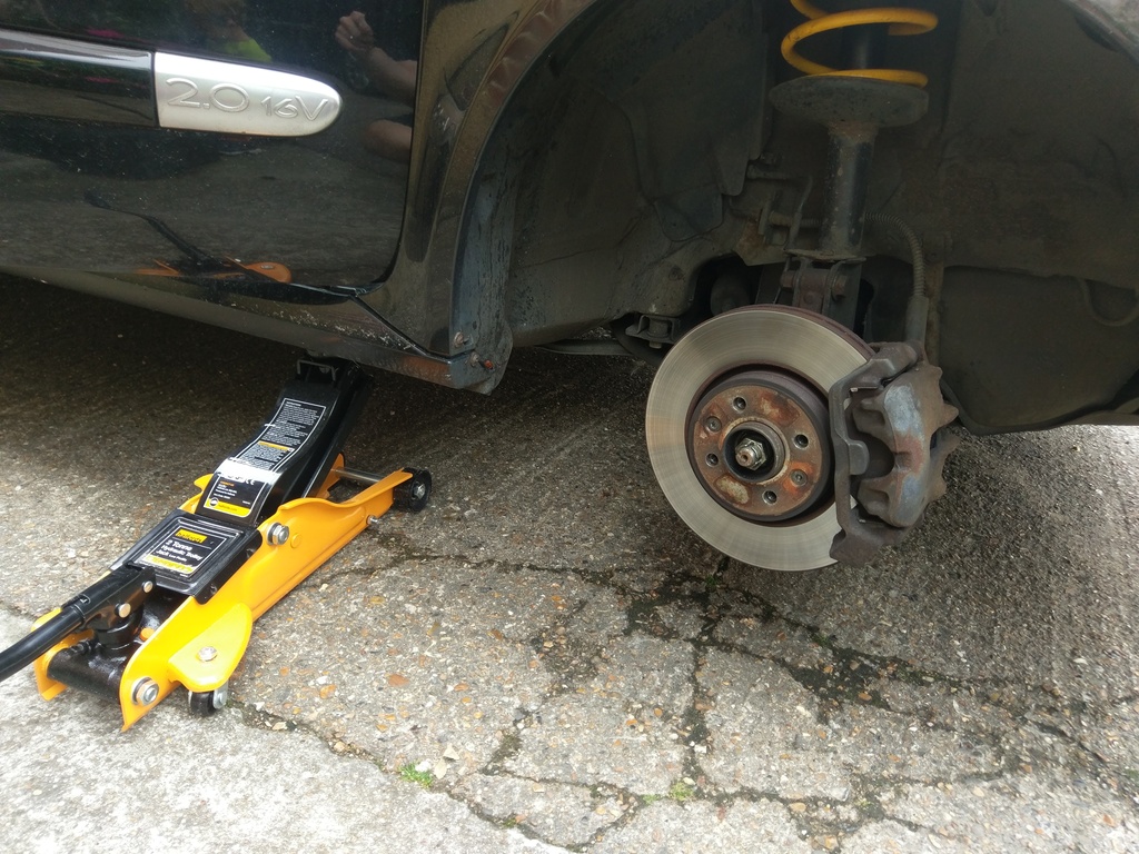

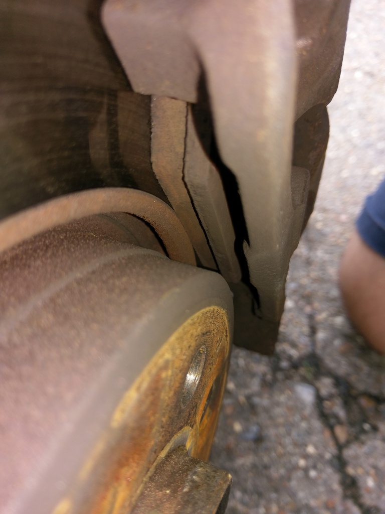

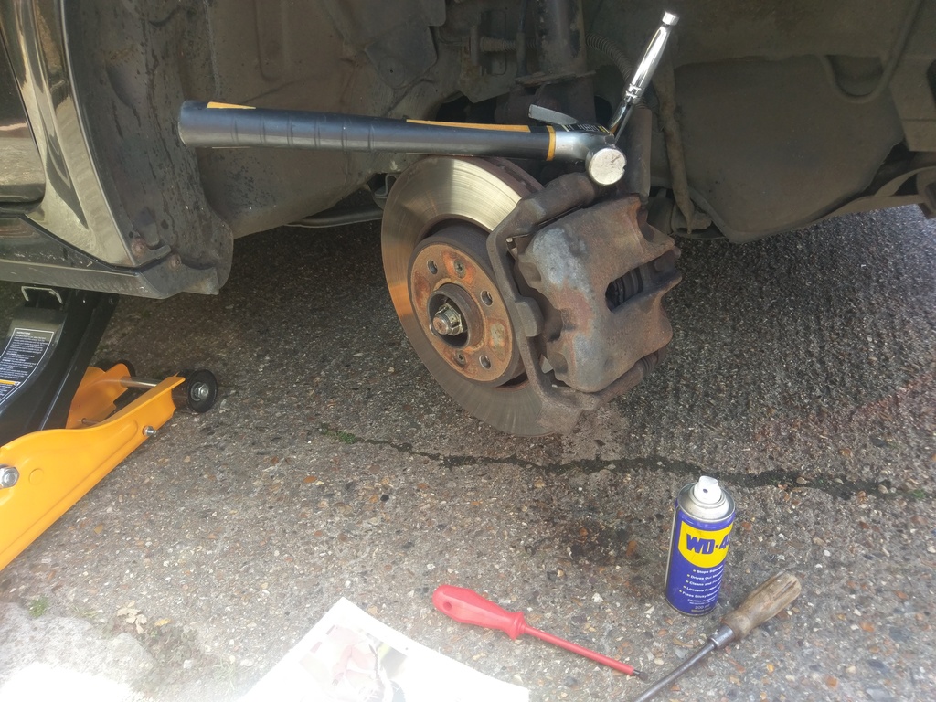

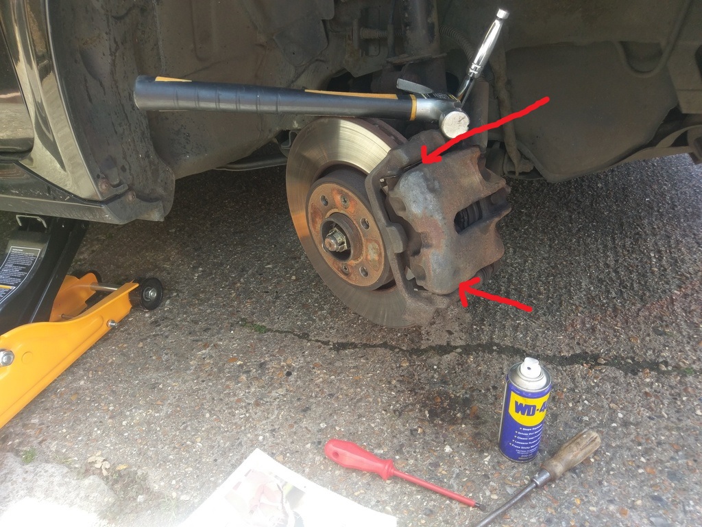

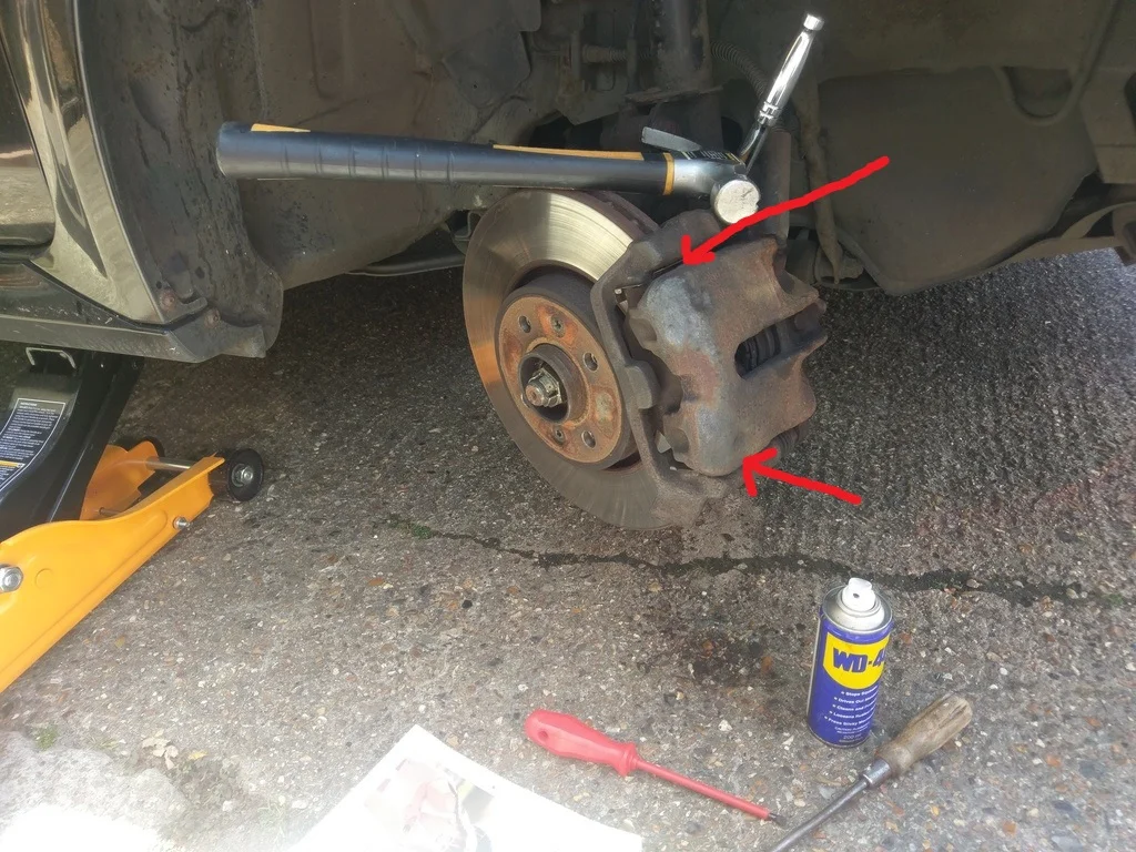

I've been quite busy this morning but took a moment to raise the car and work out which of the wheels was not spinning freely. Culprit found, my front drivers-side brake caliper has seized, I suspect a rusty piston is to blame:
I've now got to make the decision, do I refurb them or do I get myself some new front calipers? I would love a nice fresh set of brake calipers :smilingimp:

Give it a refurb first! Strip it an grease it im sure theres a guide on here somewhere
I've taken a look at a couple of threads and YouTube videos, I'll give it a refurb and see how it goes... another bullet point added to the project list!
@pastymaster - clips ordered, thank you :smile:

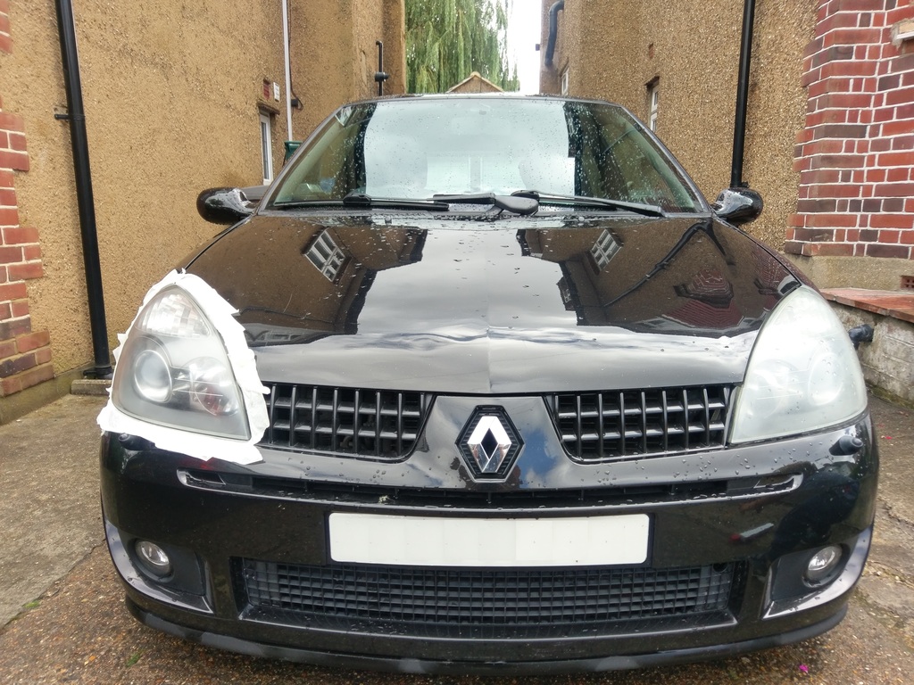

Headlight Polish:
I sanded and polished both headlights using 800, 1,000, 1,500 and 2,000 grit sandpaper followed by many coats of PlastX. The outcome is okay, I don't think I used all my elbow grease on the sandpaper stage and this may be a job I come back to in the future, they look a lot better than they did yesterday though. Look, here's a generic picture of a headlight with masking tape around it to give this paragraph some context:

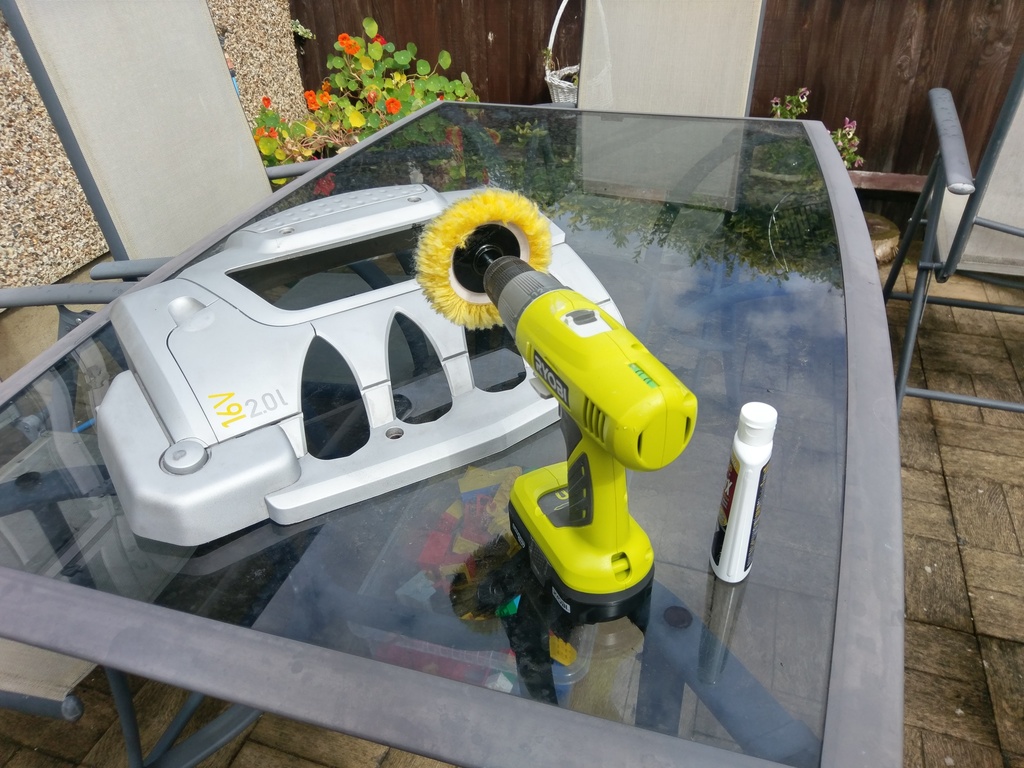

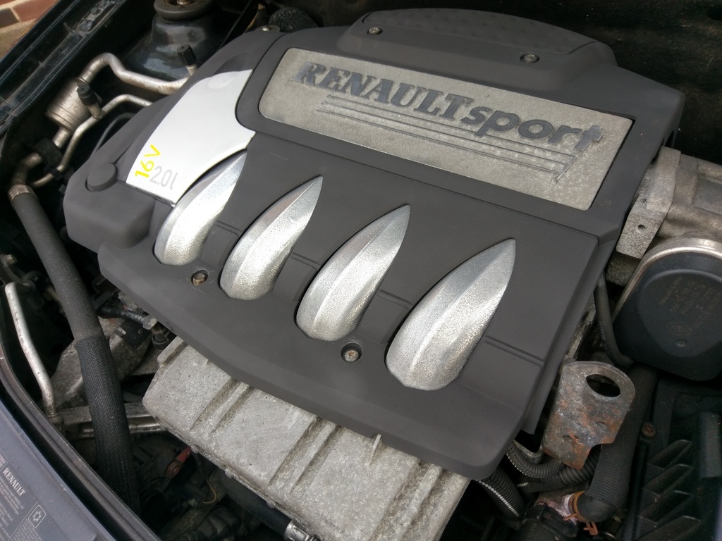

Engine Cover Cleaning...:
I went a little further than planned with this task. Originally I just wanted to clean it - as you can see from this picture of the semi-clean engine cover next to some cleaning stuff:
The problem is I sometimes get a little manic about things. In this case it manifested in me deciding to paint the engine cover black. In between headlight polishes I'd pop around to my makeshift paintbooth and stick another coat of heat resistant black paint onto the engine cover. Halfway through, I looked at it and thought "what a f**king disaster!". Seriously, what possessed me to paint an engine cover having only ever painted once before in my life, my bathroom in 2010... and I did a s**t job then, I got most of the f**king paint on the ceiling, floor and some on the window which I never managed to remove fully. I almost posted in the Wanted forum as I thought I'd ruined my engine cover. Powered through though and gave it five coats of the stuff, and to my surprise it actually turned out pretty medium!

I also got my bodywork clips today so stuck that in, so not all failure!

Those brake bolts won't be rusty on the inside. They'll just be bloody tight and have loctite on them...
Don't need to take them off unless you're swapping the discs... To get the caliper/pads off, undo the little 13mm slider bolts. You'll need to lock off the slider anchors with a 17mm socket. Then put a screwdriver/lever bar in here:
and lever the caliper/pads off the disk..

Brake Caliper Refurb, pt. 2:

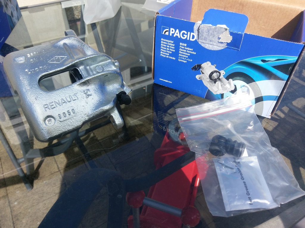

It's been a busy-ish week of car stuff. I wanted to prioritise the brake calipers this week so focused on that issue initially. I took the driver-side caliper off as per @Budgie's helpful guidance and pulled out the piston, it was completely rusted, as was the housing. I worked out how many s***s I gave about this particular caliper and quickly realised it was 0, so off I went to buy 2 new front calipers from a car parts shop I won't name but will clarify it's not one of our preferred traders = my first mistake. OEM passenger-side and driver-side front calipers bought, I came home to fit them but before I could do that, I took a picture of them to fill this post out with some pictures... otherwise it would be a little wordy:
I got the car up, took off the old calipers and began to fit the new driver-side caliper. Initially, I thought I was being an idiot, followed by "f**k, why won't this thing fit!?", finally realising it was a passenger-side caliper... for a different Renault altogether. I popped back to the un-named car parts shop fuming about the fact that I'd been disturbed mid-job by incompetence. On arrival I realised I'd left the incriminating passenger-side caliper for a different Renault at home, I didn't care, I was picking up the correct caliper, giving them a piece of my mind and returning the passenger-side caliper for a different Renault when I finished the job. I didn't quite get to the bit where I gave them a piece of my mind as the chap behind the counter was so apologetic that he just gave me the correct caliper and told me to bring back the incorrect one when I was done, not charging me... this made me happier so I went off to finish the job. Calipers fitted, brake fluid topped up, wheels on, car on floor I returned victorious to the un-names car parts shop to silently gloat over my success and return the incorrect caliper. This is where things got a little bit lucrative. I handed in the caliper along with my receipt and was about to turn and head out then the guy said "insert your card here and I'll process your refund"... um, I guess I'm not too proud of what I did next, but I did it. "Okay" I said, entered my card and got refunded, not for the caliper on the receipt that I paid for but for the caliper I returned which was actually £30 more expensive. It was all a little strange and involved lots of confused people: me, the chap behind the counter, his boss and the person in the queue behind me but it played out in a way that meant I had an unexpected £120 in my bank account. What does one do with a free £120? Buy some motherf**king track wheels!!

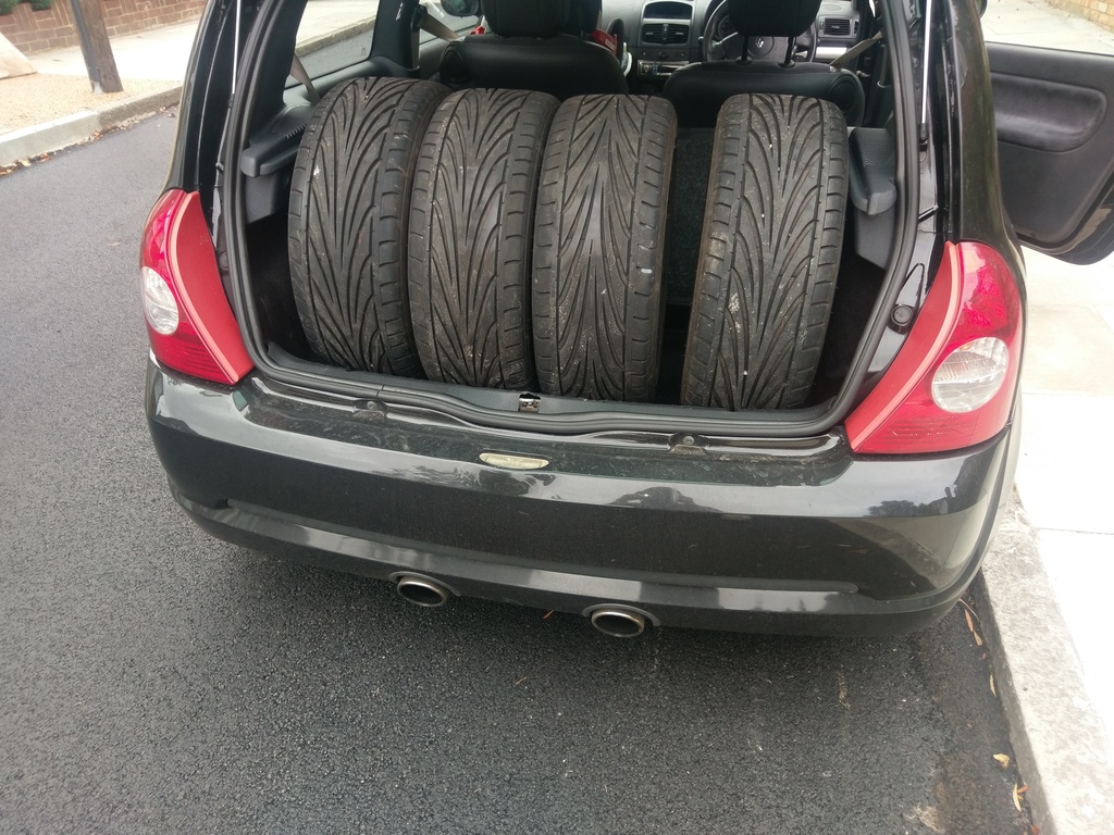

Some Motherf**king Track Wheels!:
This post is no longer following the chronological order in which these actions took place, but let's move past that. Once the caliper was on and the job below was done, I got back onto ebay and offered a chap £100 for his Clio 182 wheels complete with nearly new Toyo Proxes T1-R tyres. We agreed £120 and I went off to pick up my free wheels :)
And look! I never knew you could fit 4 wheels into the boot of a Clio...:
...until I measured the boot prior to my trip to pick them up.
They're now sat around the back of my garage under some tarpaulin ready for use when I get round to booking a trackday. I plan on getting through the T1-R's on track and, based on my experience wrapping them in similar rubber or wrap them in Nankang/Federal track tyres. I'm just not sure at this stage whether a Clio 182 needs that kind of sticky rubber - will do some more lurking on this.

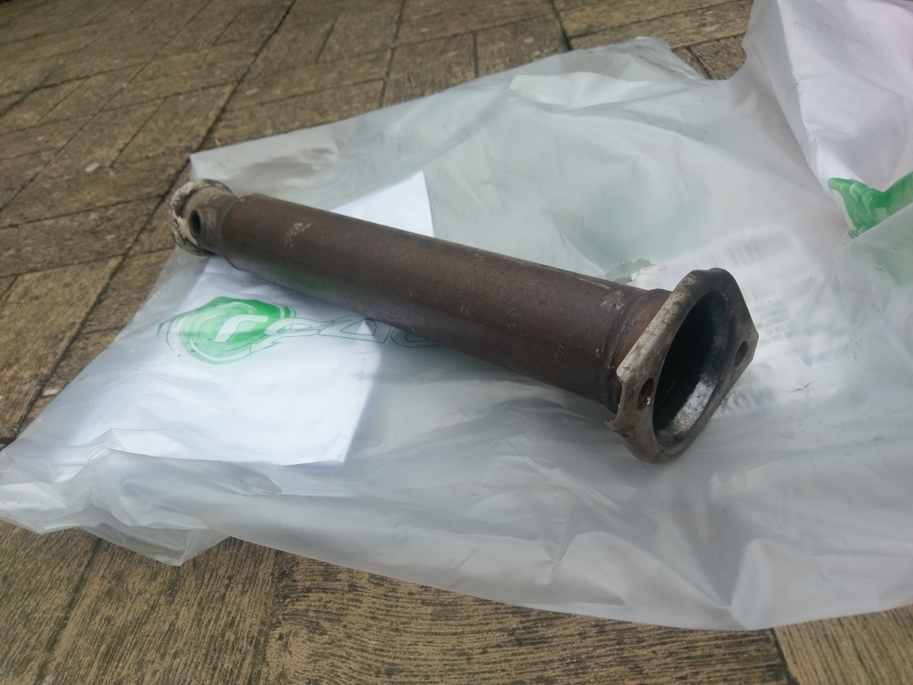

Re-Catting The Exhaust System:
I have to admit I'm one of those Clio owners who got sick of the volume of a decat exhaust system. While I was at the un-named car parts shop I picked up an OEM cat and got a mate to fit it while we were doing the calipers. After re-catting the exhaust system, I took a trip up the M40 and the difference meant I could actually have a conversation with my wife! Absolutely gutted, I immediately thought how I could stick the decat back on but the M40 is not a great place to work on a car, plus I didn't have my toolkit, jack or decat pipe with me so turned the radio up and looked serious - that often works. I have decided to keep the decat pipe as I'll probably fit it in the summer for trackdays and take it off in the winter for normal usage and MOT as it's got a lot of life left:

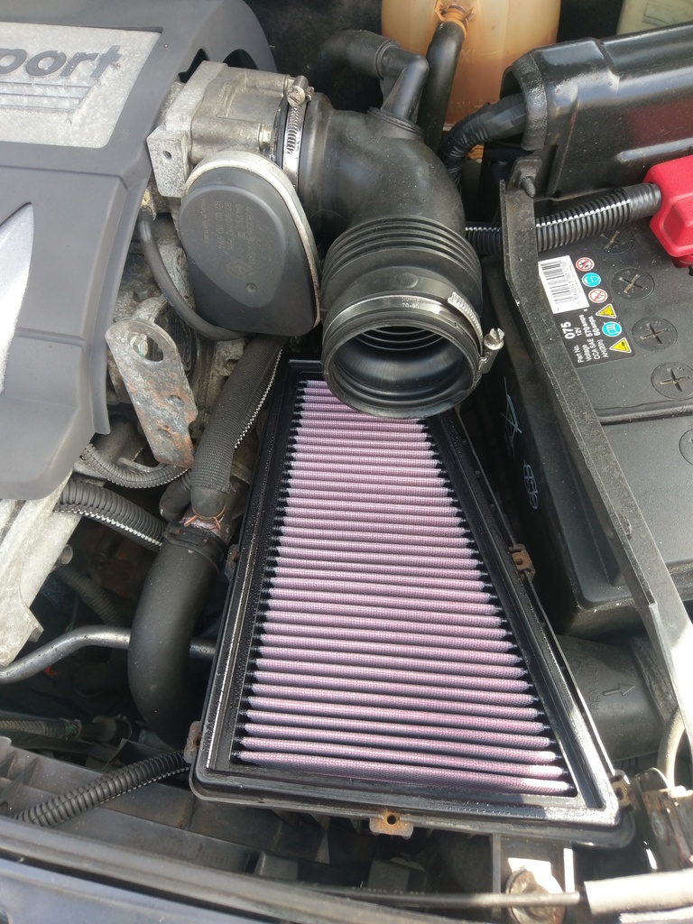

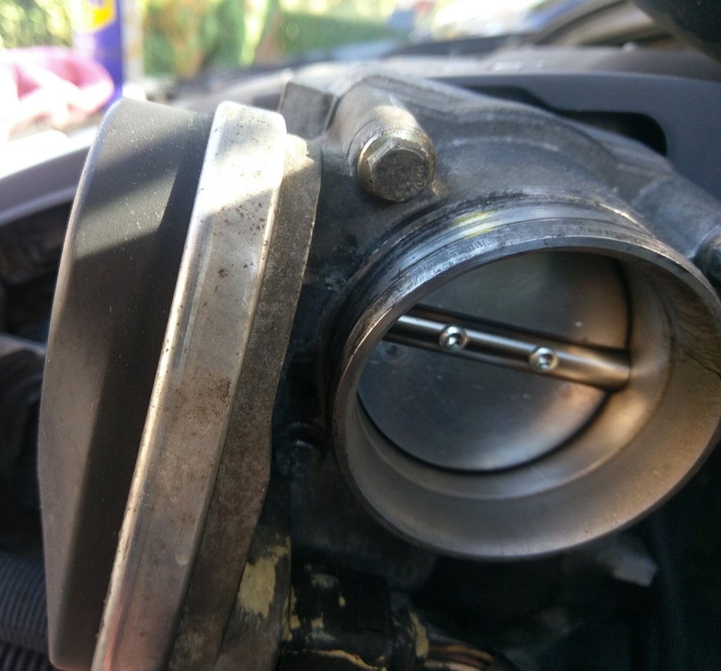

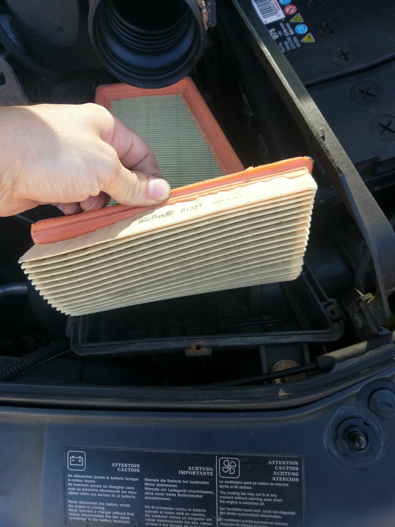

This week I mainly focused on diagnosing and then fixing the rough idle when cold. Having done much lurking on the subject, I decided to tackle the throttle body as a likely cause. I grabbed my WD40 and a microfiber cloth and headed for the car with a purposeful demeanor. Elbow greased and ready to tackle a dirty throttle body I popped the bonnet, took off the air box housing and the elbow. I was surprised to be faced with a very clean throttle body:
Undeterred, I began giving it a right good polish to remove some of the grime that I'd convinced myself would be there and once I got that out of my system, I looked at it and thought "f**k me, that was a waste of time". If you'd like to know what it looked like when I'd finished, refer to the picture above as it looked almost exactly the same! I turned my attention to the air box itself and the filter. That filter... what's the point of it, to ensure that no air gets into the engine?! The bloody thing was rock solid!
Off to ECP to get a different air filter and who knows, maybe I'd get some more free money... free is my favourite type of money! I returned with an air filter but much to my expectations, I did not receive any free money on this occasion. So, refocusing on the task at hand, my little helper and I inspected the air box and inserted a new K&N filter panel:
Airbox Inspection:
New Shiny Air Filter:
The difference is completely unnoticeable, it sounds the same and goes the same. I may have increased power by very slightly but without having put it onto the dyno yet, we'll never know! When cold, the rough idle has improved though so goal somewhat achieved. The issue is not completely resolved and since re-catting the exhaust last week the emissions light has remained on so I suspect there may be more to fix, I want to stick on a code reader to diagnose the issue... not having a code reader makes this task a little difficult.

I too purchased the K&N panel air filter and I too noticed not a huge amount of difference......... but it's sooo much better than the standard paper version! Induction kit may be the way forward should you be into such things :smile:
