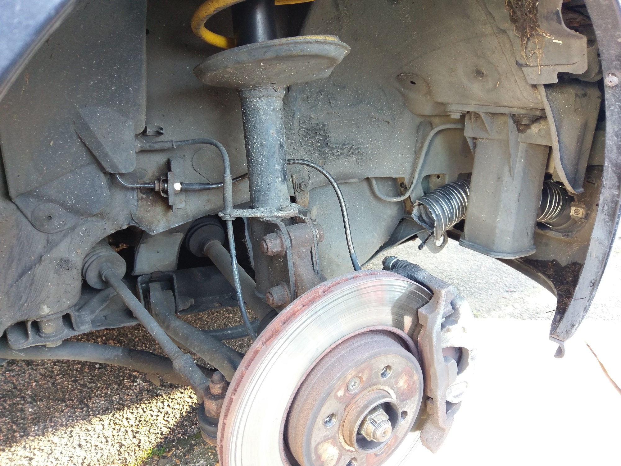

I saw sense, conceded defeat and called my mate Joe who is an actual mechanic. I told him a paired down version of the story above and dropped the car into him. The result:
  • Near-side rear caliper seized (likely due to years of misuse)
  • Cracked near-side rear brake disc (likely overheating due to antics at Silverstone and a fucked caliper)
  • Near-side rear brake pad worn (definitely due to fucked caliper)
  • Me = a lot poorer
  • Clio = sorted

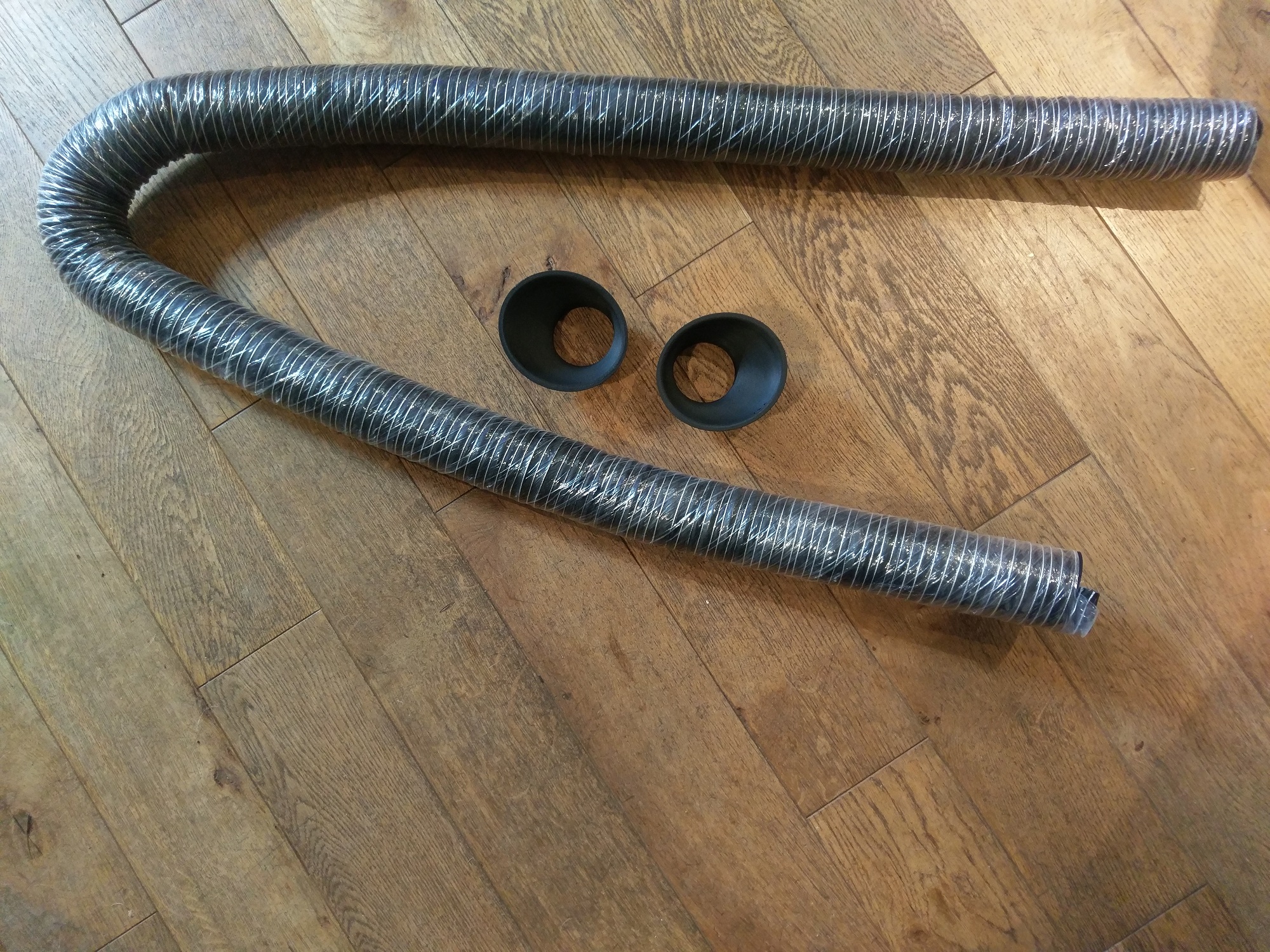

It turns out Santa Clause has a 3D printer!
Will plug these into the car before my next track day :)

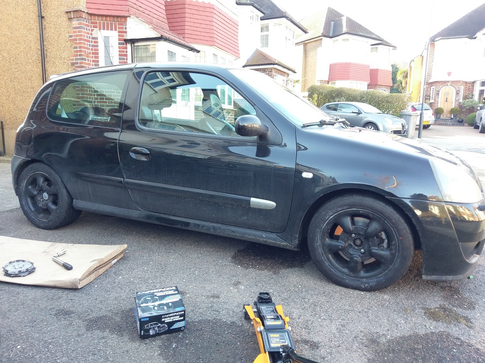

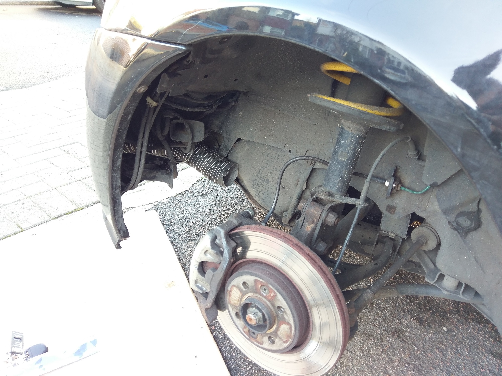

Brake cooling equipment:

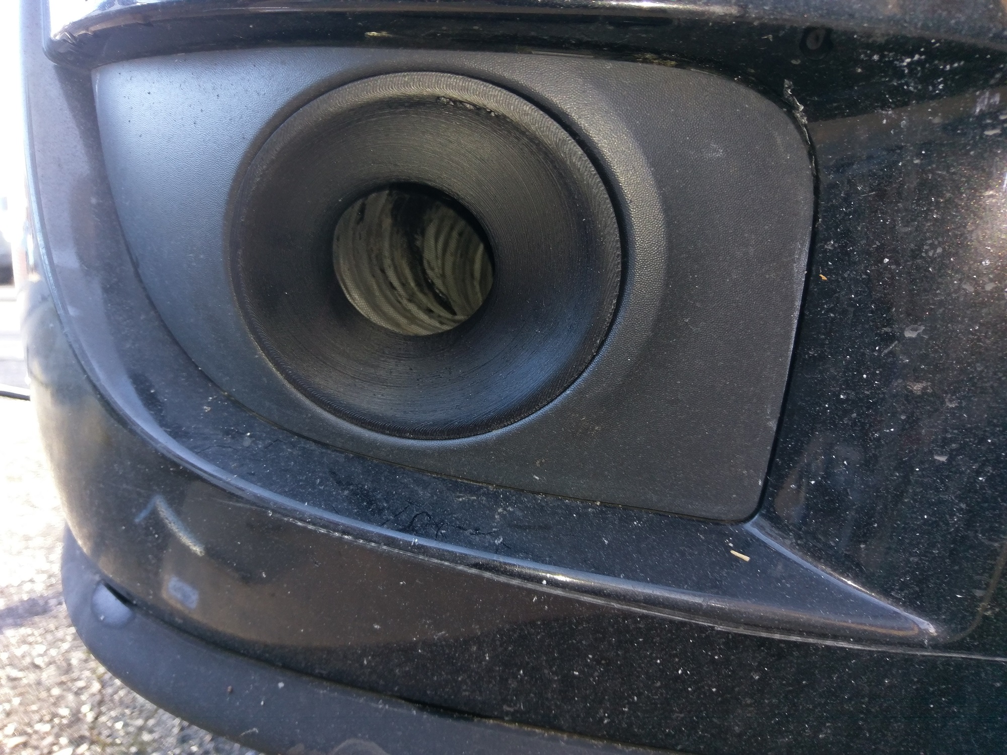

Santa Clause used his 3D printer to produce stealth brake duct scoops (from eBay) and included far too much piping, 2 jubilee clips and a few cable ties. These appeared under the tree on Christmas day and stayed there until today, when I finally got around to installing them. Jacking the car up was successful on this occasion; I wasn’t scuppered by a locking wheel nut and got the car in the air. Removing the drivers-side wheel I was reminded about the bloody carbon canister that lives behind the fog lamp. A quick read of a few threads here made me want to leave it in place and see if I could fit the 63mm bore piping around the canister. I got it around with a bit of force… I’m not sure how much this bend will impact the cooling provided:
My original plan of having the pipe run alongside the rear wall of the wheel well and turn toward the rear of the caliper attached to the lower wishbone failed when I realised the wheel would rub whenever I turned left slightly. I chopped it back to here, again unsure if this would actually provide any cooling to the brakes… the driveshaft and lower wishbone would stay nice and cold though:
The passenger side was a doddle in comparison, I simply moved one horn from the bottom to the top of the bracket. These will be so great for cooling my drive shaft and lower wishbones but I am sceptical about them keeping my brakes cool:
In total I spent about 4 hours on this! Although I wasn’t working fast, I cannot believe it took me that long!! If I did it again, it would take me around 1 hour, I wasted too much time being stupid, drinking tea and taking pictures of my progress.

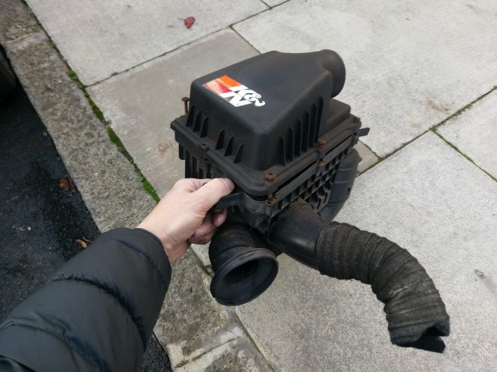

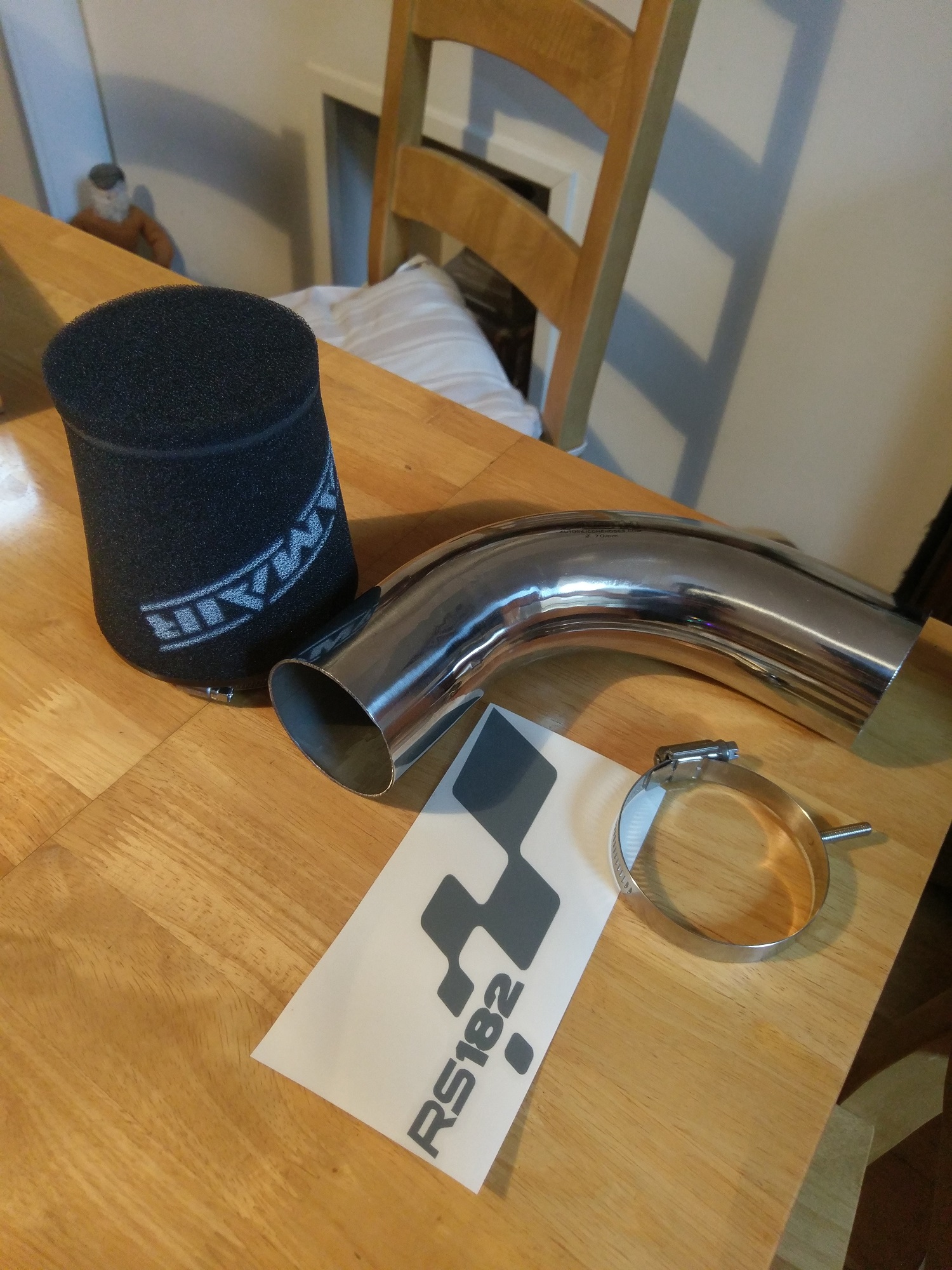

The Fatty induction kit:

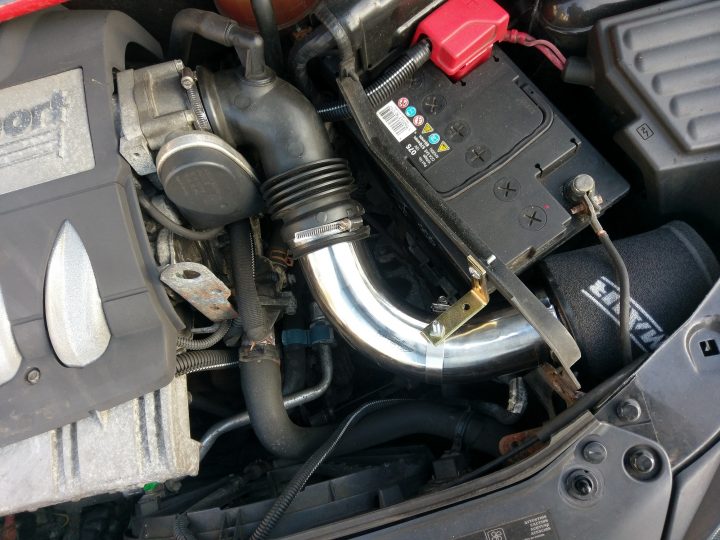

Thanks to my regular lurking on this forum I bought a DIY induction set-up one evening after many beers and a few whiskeys. All the bits arrived shortly thereafter and sat in the corner of my room for a few weeks. @DJR1210 VERY kindly sent me a juibilee clip to attach the 90 degree pipe to a bracket, receipt of that reminded me I had a DIY induction set-up in the corner of my room, the weather was nice so I thought “to hell with it, life without a loud engine is a shower of s**t, I need some induction roar in my life”. I proceeded to remove my airbox, completed with almost all of the original screws and a 700 mile old K&N panel filter:
*My hand is not small, it’s just really far away
It was just after this I realised I had a jubilee clip to attach to a bracket, but I didn’t have a bracket. I popped down to Wickes and grabbed a generic bracket, headed home, removed the negative cable from the battery terminal and installed the gear. Job jobbed:
Very proud of my efforts at fettling I wanted to take her for a spin. Key in ignition, hand on steering wheel and excited grin across my face I turned the key. The engine turned around 4 times and cut out; I repeated this 4-5 times while descending into mild panic and I swore a lot. Eventually, I gathered myself and came inside to lurk the f**k out of ClioSport. After 10 minutes I realised that installing an induction kit is not going to give me this problem, I then worried it was one of the earths that I’d possibly damaged. Continuing to lurk it slowly became obvious that I’d actually engaged the immobiliser… and it worked! @bloke had posted the details for resetting your immobiliser on another thread, I gave this a go and the bloody thing fired up! I swore a bit more and went for a drive. Much fun was had.
The induction kit sounds great when peddle is on the metal but I can’t say I’ve noticed any performance difference positive or negative… but it sounds AWESOME!

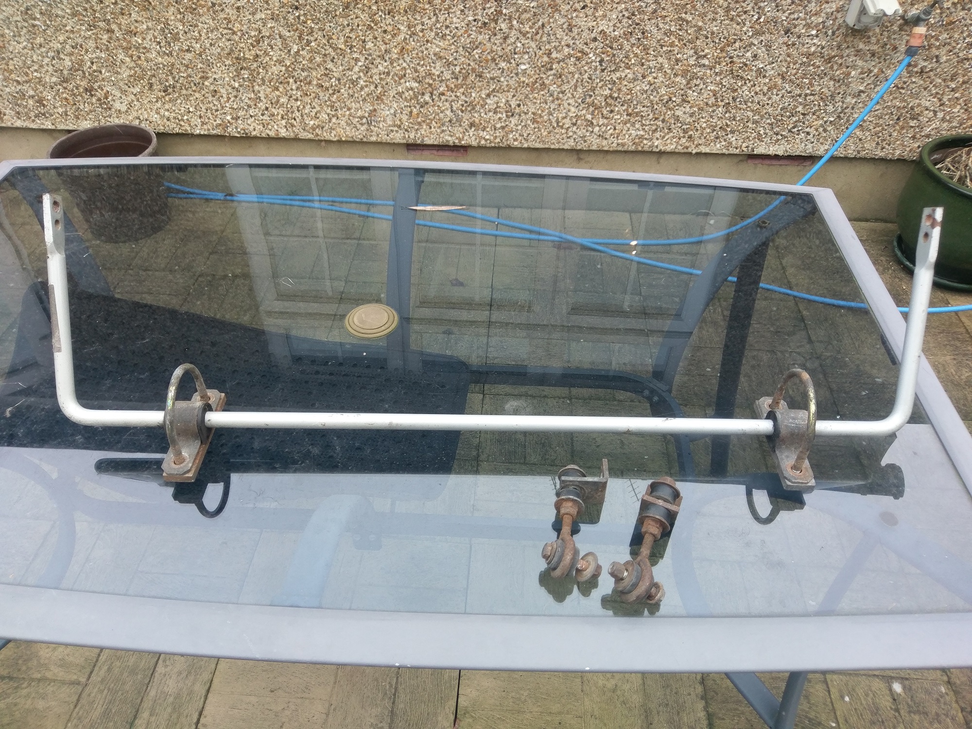

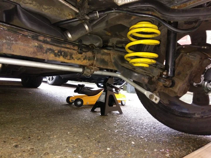

Whiteline ARB:
This was my most daring attempt at fettling yet! I’d picked up an ARB from a chap on ClioSport and like hell was I going to leave this lying around, I couldn’t wait to fit it!
I jacked the rear of the car up and got to work. Starting on the passenger side, I stuck the jack under the cross beam, underneath the spring compressed the spring slightly and took the lower shock absorber bolt out. I put in the drop link bracket and started to screw the lower shock absorber bolt back it… it just spun. I continued to ineffectually wiggle it around, take it out, look at it with that frown you get when you’re confused but want to feel like you know what you’re doing while your inner-self is rolling around laughing and asking if we can just go to the pub instead of doing this s**t, but it just spun. I got my torch and looked through the bolt hole and realised it was 5-7mm higher than the stub axle(?) bolt hole.
“FOR f**k SAKE!”
That’s what I said; my middle class neighbours were unimpressed. Stupid thoughts went through my head before I realised I just needed to jack the spring up a little higher. Did that, bolt in and continued. The driver side took no time at all having learned from my previous douchebaggery. I went a bit tight on the drop link bushes, I’ve subsequently loosened these up again:
I took her for a spin this evening as I’d not driven for driving sake in a few days. The car is going well, the noise is brilliant, the understeer seems to have been reduced and the lower front wishbones are probably very cold.

How you finding the apex springs?
Crashy as hell, I have to take avoiding action everytime I see a pothole or a pebble. They're ridiculous. I've been on track with them twice and they're pretty s**t... it's on my list of upgrades but I haven't decide between Eibach spring or coilovers yet.

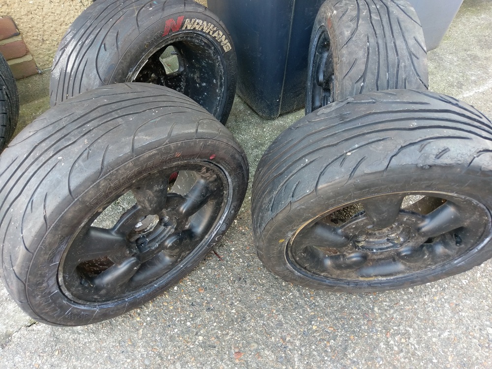

Having now done 2 track sessions, 1 on 3 different budget tyres and 1 premium tyre and 1 on a set of 4 Proxes T1-R I was keen to get some good track rubber. Although I've completed a few TD's in my life the first 2 in the Clio were the first I'd done on road tyres, it was a shitshow.

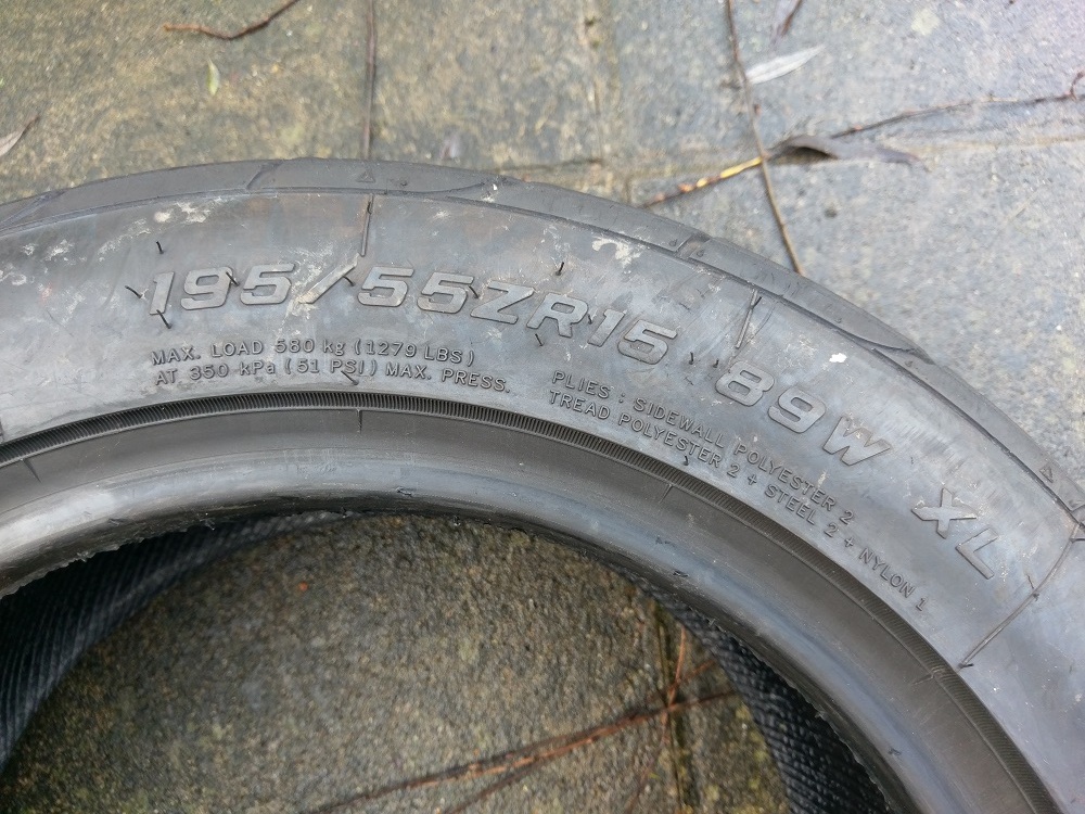

I'd set my mind on getting a smaller set of track wheels as tyre prices and options for the spare set of original 182 wheels I was not great. I sold the spare 182 wheels and picked up a set of black 15" Valver wheels (Speedline Vega's) from a chap on here and began sourcing some used 15" track tyres. Within a few days of Ebay mining, I found a chap selling 195/50/15 Nankang NS-2R 180 tread for £55 a pair. I made contact, made a deal and headed out in the Clio with my 3.5yr old on a 5 hour round trip to pick up 4 track tyres. Super excited as
I got there was quickly distracted from checking the evenness of the tread, or the size of the tyres, or the condition of the rubber by 2 things:
  1. The story of where the tyres came from
  2. Stickers
Talking to the chap selling them, he mentioned that these had come from his friend's VW FunCup race car after the series organiser changed the control tyre at the end of the season. I ignored the fact that these had come from a friend's car and he knew very little about racing, I asked many questions about VW FunCup racing cars and, on hindsight made the chap visibly uncomfortable. I learned very little about VW FunCup race cars.
2. Stickers
I noticed that some of the tyres had Nankang stickers on them and thought how cool they'd look.
I loaded my boot with 4 tyres that either had stickers or a good amount of thread and drove home. I rolled the tyres around to the back of the garden and lined them up. Something didn't look quite right about them lined up together so took a look at my 195/50/15 tyres and one said this on it:
FFS!
I contacted the chap on Ebay to say I was an idiot and brought home 3 50mm profile tyres and 1 55mm tyre, explaining I hoped I could send one back to him to swap for a 50mm tyre... like f**k was I driving back there again. He said not to worry about sending it back and he would post a replacement to me... what a hero! It wasn't his mistake, it was mine... because stickers!
So the replacement tyres arrived and garage locally stuck them onto my Valver wheels:
You'll see that 1 tyre had been badly overheated, 1 has been slightly overheated, 2 are okay and 1 has a sticker on the wrong side. The wheels were balanced and I stuck them on to get ~100 miles to see how thy felt:
I tried with and without the spacers but the offset on Valver wheels means that they give a wider track anyway so spacers were no longer needed and sold. It handles okay but the rear (overheated tyres) is a bit lumpy and I was getting steering wheel wobble over 60 mph which does not exist on my road wheels/Proxes T1-R's. I assumed balancing issues but not sure so I jacked the car up to a height where I could just spin the wheels, the front passenger side front wheel scraped the ground for half a rotation and span freely for half a rotation... I think I found my issue but no idea whether it's the tyre or the wheel.
It's not serious enough for me not to get on track though and am aiming to get to Brands in late February to give them a run-in
