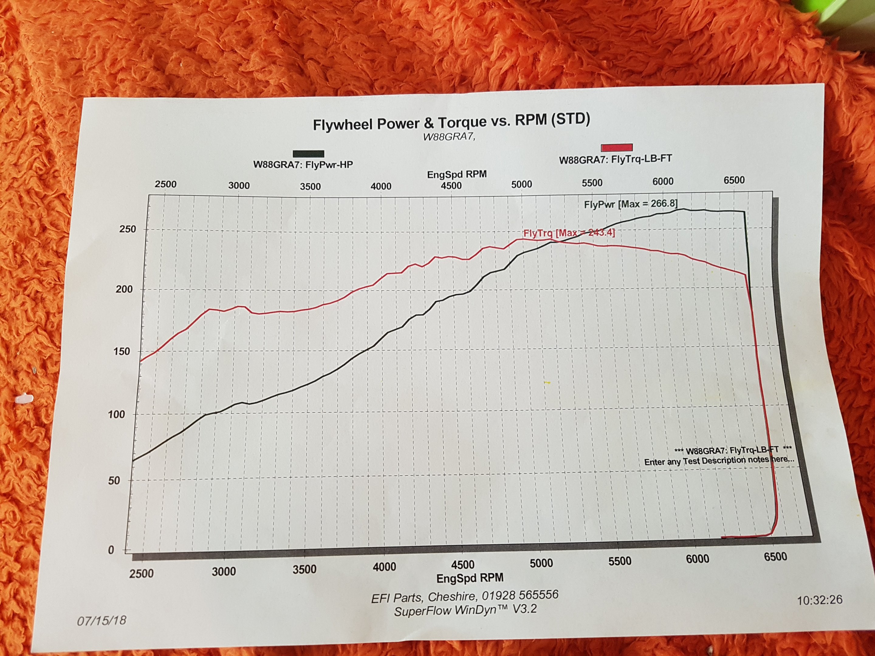

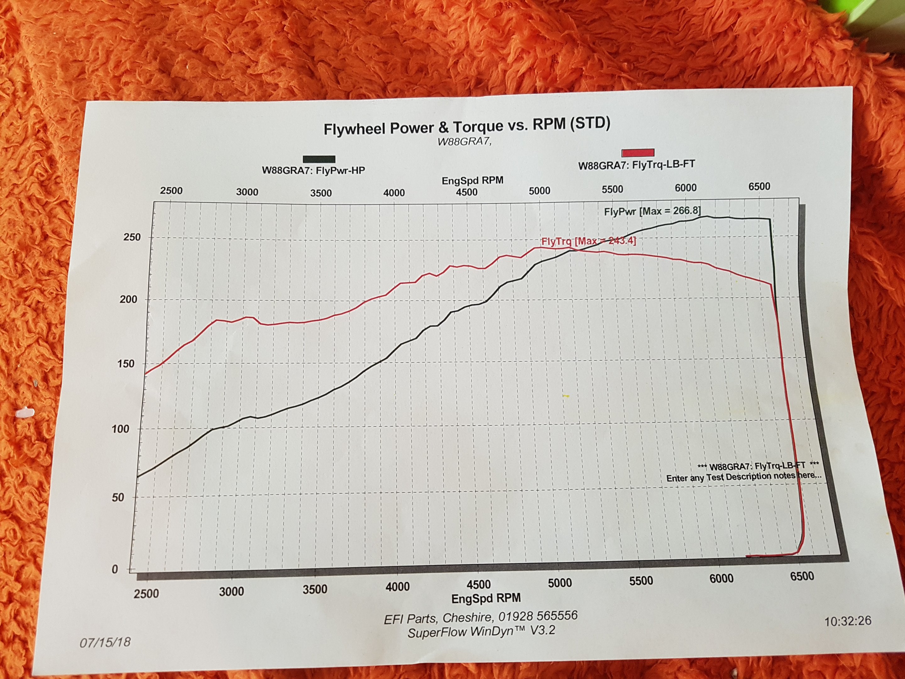

It's a nice car, got all the right bits on for sure, shame you've had a turbo issue but after being told it had a GT2871r with "Hybrid core from turbo solutions" it was disappointing to find it was a Chinese garrett replica when it came to mapping, despite the 260bhp it made. Carl had to die grind the wastegate out because the casting was poor on it not allowing proper waste gate boost control. With a better quality turbo it would and should be a very capable car.

With the smaller turbo can they still make 250/260bhp?

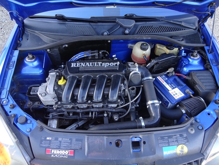

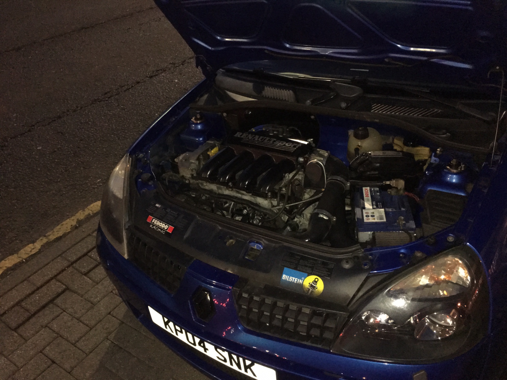

Thought I’d share some pics lol
this is with a garrett 2560, pulls so well and now has a dci box on it, gearing works well with it.
same casing and set up so as reliable. ratios are great though, 4,000rpm in 5th and you're doing 105mph!!! 1st is just about the same as standard, 2nd is slightly taller but you really notice the difference in 3rd and 4th!!!
