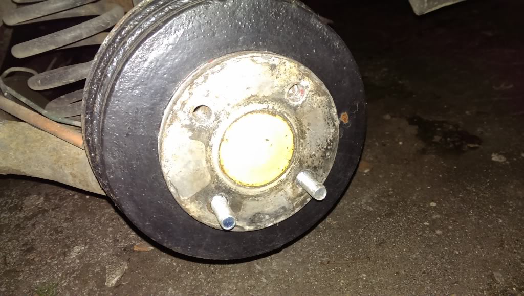

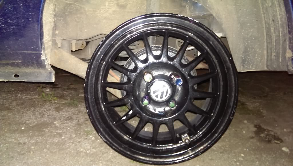

Ok, so I bought a set of alloys off ebay after several messages back and forth between me and the seller in order to establish if they'd fit my car. They're the correct pcd (4x100), offset and width are fine and then he said that they had previously been on a clio so I thought great! However, I got picked them up and the centre bore seems to be too small. Judging by the VW centre caps he gave to me with them, the centre bore is probably 57.1 rather than 60.1.
The deal was done outside of ebay so can't get my money back. Plus due to the amount I spent on them and the distance I travelled to get them, it's not worth me taking them back. I'll most likely sell them on it I can't get them to fit.

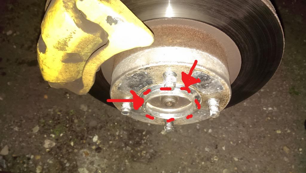

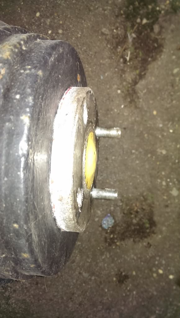

Anyway I went to trial fit them today just to check, and they seemed to fit ok due to my spacers, which essentially negate the centre bore (see pics). Since there is no centre bore to actually sit the wheel on top of, would it be possible to safely fit these wheels to my car? It is my understanding that it is the bolts alone that secure the wheels to the car and that the centre bore is mainly there to make it easier to put the wheels on, not for safety purposes.
However, the front spacers do have little bit protruding that would emulate the centre bore, surely I could just get the same ones as are on the back for the front?

I think you're confusing the actual metal that the wheel sits on with the hub nut cover; a thin piece of tin that's there to prevent the ingress of s**t into the hub nut hole and then the bearing.
I'm referring to the metal bit that the wheel sits on, very crudely pointed out in the above picture. Since the centre bore takes some of the load, how can such a thin piece of metal provide structural support? Surely it isn't as strong as the centre bore itself. So my point/question is, why is there a need for me to replace the rear spacers? I apologise for my naivety.
Remove that s**tty spacer and look at the actual original part. It's a load baring part.
*edit, is that a spacer or silver paint??
Either way, i'm right and that's what matters. Someone with more of a grasp of physics will be along to explain it properly.
So the front spacers are s**tty too? They're hubcentric, which I thought is what you said I needed for the back?
I'm no longer debating the role of the hub, my issue is with the little aluminium protrusion on the spacer itself. My point is that this cannot provide the exact same load baring potential that the hub does, so why is it essential?
Edit in response to Mr.Potato's Edit: That is a spacer, around the same thickness as the ones on the back, but these ones still have the hubcentric part intact.
