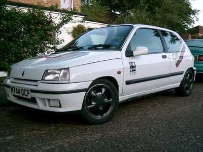

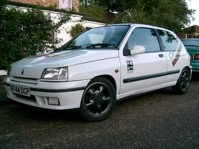

These are my anthracite ones I got done by Fred :cool:
I've found them hardwearing but you just have to be careful cleaning them as I found they scratched slightly when I used a sponge that had a bit of grit on (bit silly really but only did it once! lol) - only a lambswool washmitt for me now! :)
ooooh very nice!
Its the scratching i'm worried about. I like the way they can currently stand up to a good scrub, so I dont want to lose that toughness.
But that stealth bomber/batmobile look is just so seductive.
