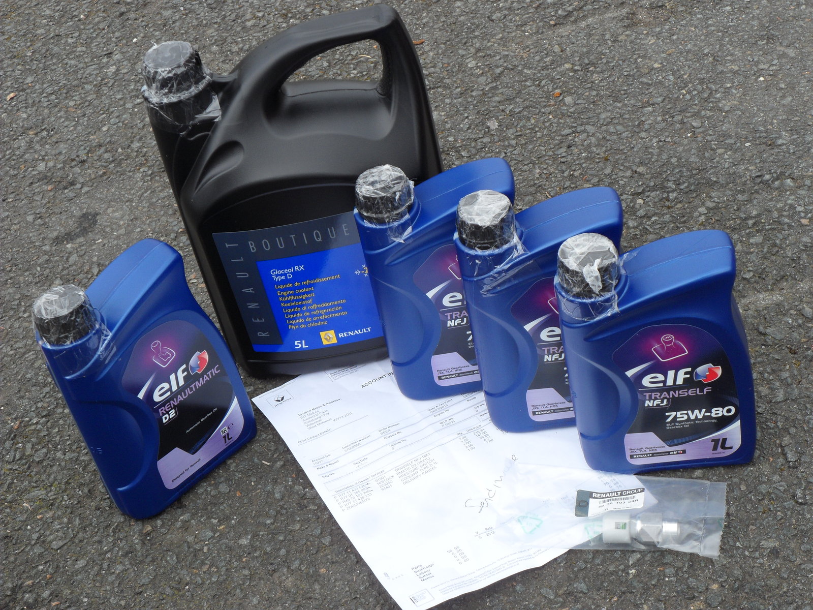

Renault stuff is cheap enough, seen on the far left (ATF)

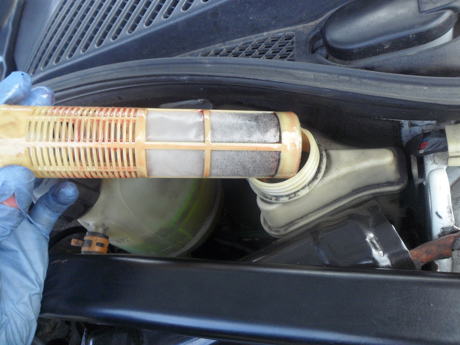

Remove the cap and inner filter insert (clean it whilst you are there, mine was dirty, see below), use a silicone nozzle (wider bit at the bottom covering the hole inside the tank), and piece of hose connected to it, drain fluid into a container
