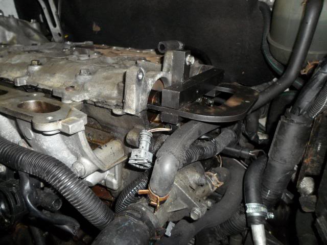

My pipe blew up going into bombhole at 80mph at Snetterton evening a few weeks back, next morning got hold of a pipe and changed it on my drive. I have had my engine out a few times so I'm pretty familiar with the Clio engine bay now however no expert. I felt like moving the most amount of s**t out the way would make my life easier, so I had bumper, battery, ECU and gearbox mount all out. After unbolting it pump side, you follow it round to a few different fiddly bolts going over and around the gearbox that you need to undo, once those are undone the pipe is just attached to the rack, which I heard was the hardest part and although it was a bit fiddly, I found it alright. There's 4 pipes coming out of the rack in a very tight format so I used a spanner to undo the 2 in front of the high pressure line that I was after and it freed up space to get the 17mm spanner on the end of the high pressure line, after about 10 mins of undoing it (you only have space for about 1/8 of a turn at a time) it comes free, reverse the procedure, fill with fluid, bleeding it by doing full locks and adding fluid until its at max and you're good to go.
