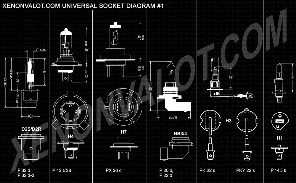

hey, i need some new dipped headlights, they the ones u got yeah? what fitting number are they? im after the phillips blue vision ultea blue 4000ks, what fitting do i need? need em soon as cause my one has blown! cheers for any help

Im having a similar coversation on another topic, I dont have a 2002 clio but from a conversation I have with another forum user he said that the bulbs twist out for the high beam. If its the same for the low beam the bulbs are HB4/9006 otherwise if they have those clips that retain the bulbs they are H7.

come on folk just a quick look under the hood, tell us or decribe the bulbs (twist fitment or clip), also see whether the bulb has a black tip (important)
The new shape clio uses H7 bulbs for dipped headlights - they are a bugger to fit unless you have small hands, even more of a pain to fit if your car has air con as the pipework gets in the way.
Sorry to disagree but its not H1 (The lanky looking bulb, maybe for the Mk2 Phase1), if anything its H7 or 9006, I will post a pic later.
The are two types of fitments:
- Offset pins
- Inl-ine pins
Check with your old bulbs and you might notice the pin alignment is wrong

On the new shape Clio (2001>) without xenon lights the bulbs are:
Side: W5W
Dipped: H7
Full/main beam: H1
Indicator: PY21W
Sorry Craig,
I was presuming that 172 had exactly the same high beam bulb as the non-xenons (please refer to previous page and look at high beam bulb, H7 or 9006)
