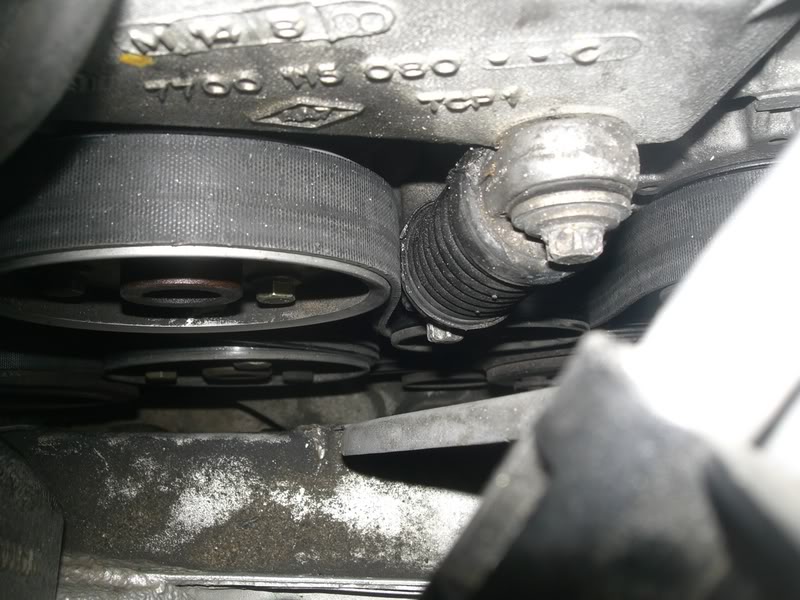

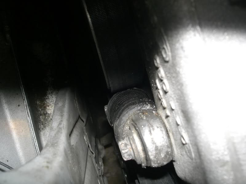

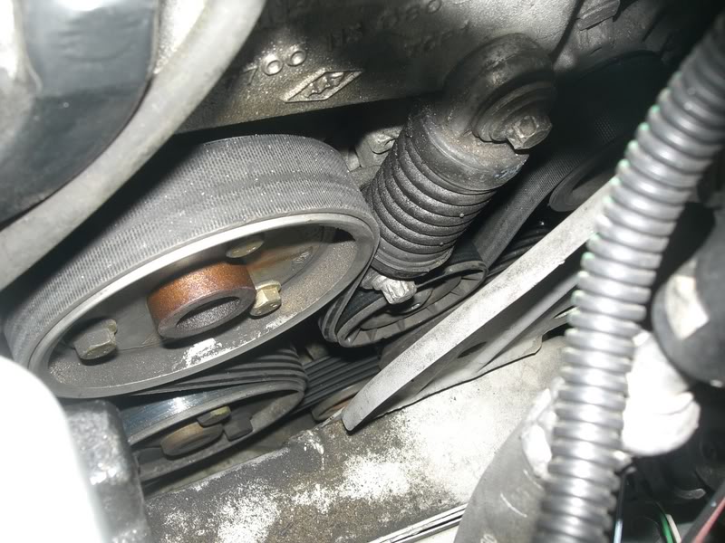

just had a good look and the base of the tensioner spring is rubbing on the belt, left a faint mark on the belt, belt can move a good 2cm before becoming tight. did a search and in a few posts edde said he has a aux belt and tensioner belt change guide. dont want the belt coming off and geting caught in the cam belt ££££.
nathan
just got a scew drive and prised a gap between the belt and pully spring, it creaked and moved away from it, seems to have done the trick... for now.

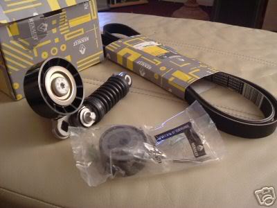

That looks like the camshaft sealing bush, are you sure its part of that kit ?
Whats the part number on it MOT1487 or 1488 maybe ?

parts are on ebay, not mine. your guess is as good as mine.
