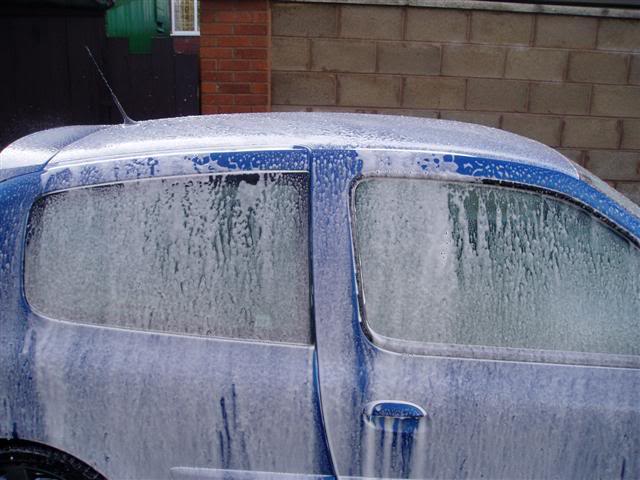

I've used one for years . Never had a problem . If you attach a short length of hose to a bucket filled with water and a couple of capfuls of shampoo they create alot of foam , good for giving the car a good prewash soak .

I give it a quick blast down first to loosen the dirt , then soak it in suds , then wash using a wash mitt and 2 bucket method .
yer thats the plan i had! not sure how to get good suds! so do u put the soap tube in a bucket?
I did use a bucket originally , now i use a homebrew fermenting bin as the bucket soon ran out of water . Run a short length of hose into the bin through a hole on the lid . A couple of capfuls of shampoo and bobs your uncle . The fermenting bins are only cheap , around a tenner with a lid .
If you use one of tha vario lances you can have lower pressure suds or high pressure suds , good for your under the wheel arches .
Any shampoo will foam up well using this method . I usually use chemical guys wash n wax as i have a few gallons .

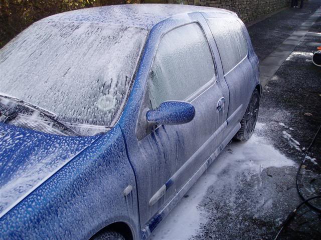

^^^ Yeah Dave . I run a 6 foot length of hose from the fermenting bin which is full of warm water and a couple of capfuls of shampoo . Pressure washers are pumps at the end of the day so will pull water as well as push water .

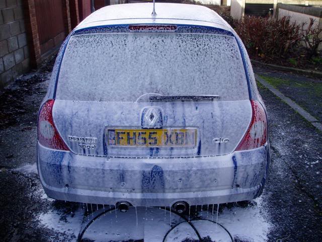

I only use it to foam the car , i do the final rinse connected to a hosepipe and tap .
