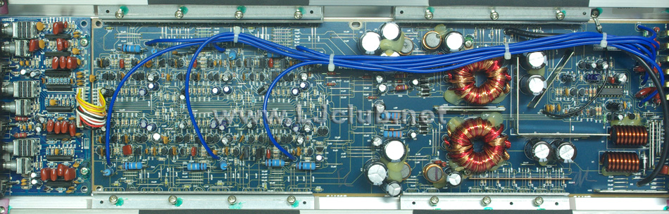

how the h3ll do i remove these
My amp is not working properly.
I need to check the capacitors for dry joints but the frkn mosfets are not willing to part with the sink which is the chassis. I have removed the screws and the covers.
The ones in question are below the screws on the sides.
How should i takle it?
problem is that my 6th output stopped working. Thought fk that i will use just the 5th. Lately the 5th would only work if i slapped the amp and later would cut out again.
The amp in question is an Infinity RA6006.
Other areas i should look on?
it's probably the thermal paste holding them on.
i'd try running it for a bit before trying remove the circuit board
yes, forgot to update
I used a screw driver against the chassis as a leverage and managed to get the things off.
