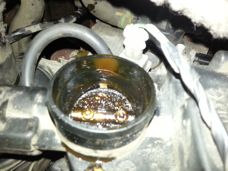

Still the issue hasnt been solved. I took it to a mechanic i know who works for a good garage to check it just before the garage shut.
He gave it a few checks such as checking spark plugs, compression check, plugging it in and seeing if anything came up as a fault and all of them came back fine.. Apart from the spark plug in cylinder 4 had no sut on the bottom of it whilst all the others had which led him to believe the missifre is down to oil. He took a pipe off the right hand side of the throttle body which leads to the air box and found this:
So basically the throttle bodies is full of oil when it shouldnt be and he said that will most definitely the reason why its missfiring and said 'the oil will be going to its first port of call which is "cylinder 4" so that is why the spark plug has no sut on the bottom and the oil will just be going down there'. So what he thinks is the garage just havent cleaned the throttle bodies out and done a rush job on the car.
I then called the garage up this morning and they came out with this 'Oh well i dont think that is the problem due to the engine over time naturally building up an oil ring, which was washed out when the headgasket went' and 'the compression on cylinder 1 was low aswell' even though the garage i took it to showed me the compression in each cylinder and all were the same and was a good reading. He said for me to just keep running it in and hope the missfire sorts itself by running it in for another 500miles and then take it back to him to have a look. He said if it keeps missfiring then they will be looking into rebores? To be quite honest ive never heard of 'running an engine in' after doing the head gasket and neither have the few garages i have took it to and never heard of having to rebore when the compression is all fine?

Ive had it back in the garage about 2 weeks ago and he said he reset the tappets and it came out a tiny bit quieter but has got louder again.. Also i cleaned the throttle body out from oil along with air intake tube and checked again two days ago.. Had oil in it again.. so not sure what it can be to be honest! Blocked breather?
