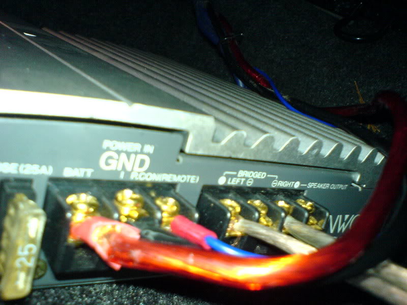

hey all, need some insparation! ok, ive got an old sub and amp i wanted to put into the gf's car. ok, ive wired it all up and checked it, however still not working???
do i need to wire somthing to this....(prob a stoopid question)

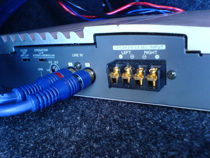

I would suggest from that picture that the phono leads are the wrong way around, i always use red as positive/right.
Is there also an earth point on that pic, with no wire attached to it. Hidden behind the phono leads.

i switched around the phonos tho so thats not the problem, ground is in place too so i realli dont know! tis getting on my nerves, never had that many probs fitting in a sub!

What is on the other side, although that says input there should be wires on speaker output,
just make sure as well that you have got a 12v live to the remote
you should have
12v + RED
ov - BLACK
Swithced 12V + (usually Blue)
if you not got a remote wire and just want to check it works before feeding one down loop a wire from 12v red into the remote, (this will leave the amp perm on so can flatten battery if left in this method better to use remote if poss, if need more help take a pic of other side as well, so i can see other terminials

hmm, there a lil hitch to that, i havent got multimeter! but when i took it off my dads car yesterday it was in good working order! 25amp fuse is fine, and there is 12v at red...ill try unbridged....hold on

ok...lil update, unbridged dont work. checked both fuses, there fine. the ground is secure and suitable! i realli dont know now! ill double check it in a min, im sure im just missing something!
