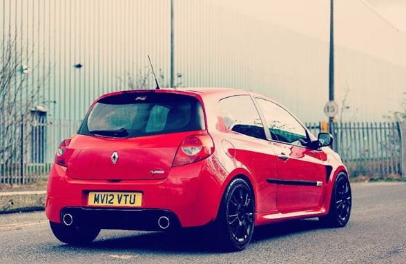

I've owned the car from new and it was ordered by complete chance as it happened. I visited my then local Renaultsport specialist (Warrington, Cheshire) for some parts for my 182 (I'll dig out some pics sometime) and at the time, the dealership had a red 200 Raider on display in the showroom. Instantly I was interested and kind of fell for it there and then and was back within a week to place my order.
I came back a week later to start the process and pick my options, but before then I wanted to drive a demo. As the Raider was on display, they let me take the Sales Manager's regular 200... which happened to be Ultra Red. :sunglasses: I had been thinking about the Raider and being a big detailing nerd, I was worried about not being able to geek out properly on a matte finish and since I couldn't order any of the Renault ID colours (my car was one of the last factory orders) I went with Ultra Red.
I went a bit mental on the options list, so the car has every option bar rear park sensors, as they ruin the look of the bumper. Everything else was ticked. We agreed a price, I sold my 182 and my Twingo 133 which I had at the time as a daily.

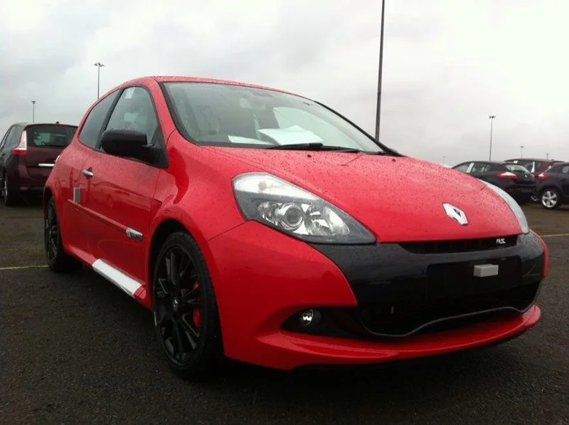

The car arrived at the docks where my mate happened to work in April 2012, so he snapped it at the import centre for me :sunglasses:

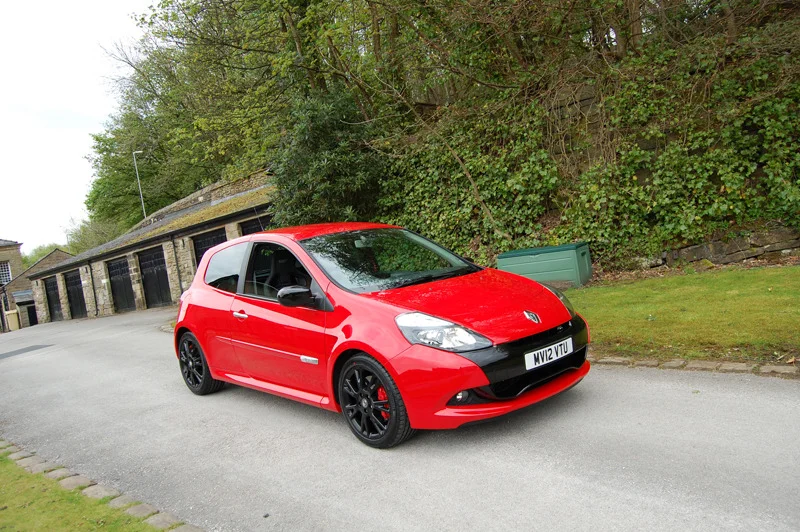

I then took delivery of it on May 1st 2012. I took a few days holiday, plus the weekend and did a full new car prep/detail on the car. Removing all abrasions/QA sanding marks etc. It was flawless.
I then swapped the horrible grey centre caps for matching black ones, purchased from a CS member.
...and detailed it further. :hearteyes:

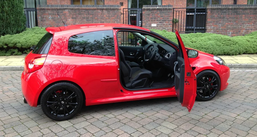

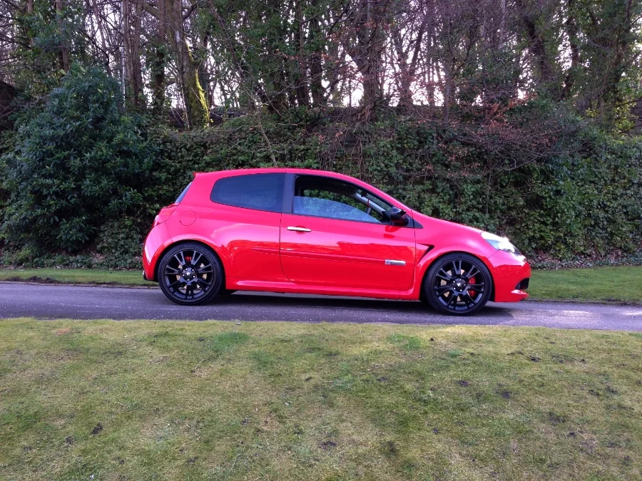

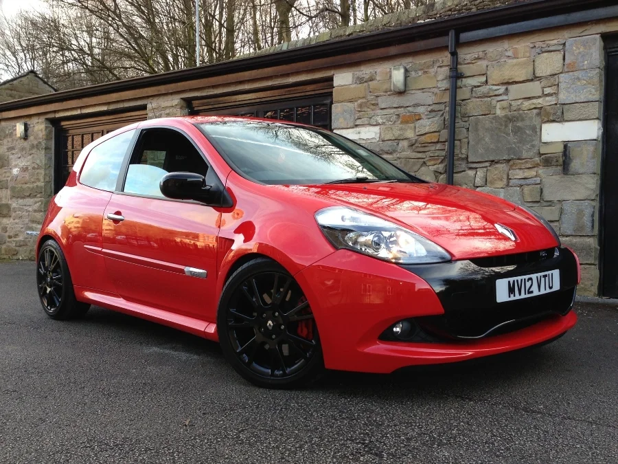

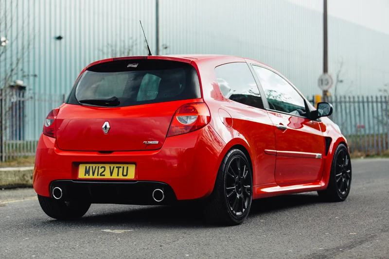

I then ordered some goodies. H&R 25mm hubcentric spacers, along with H&R 30/40 springs.
Spacers on:
Springs and spacers on:

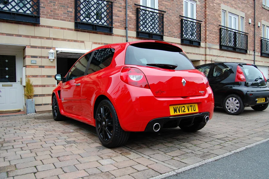

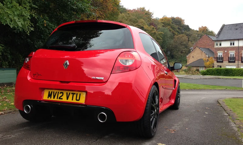

It stayed like this from 2012 to 2016. I was really happy with it.
It did Le Mans, Euro road trips, meetings and events and then in 2015/2016, I went to the Nurburgring...

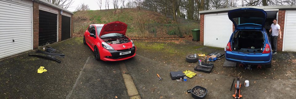

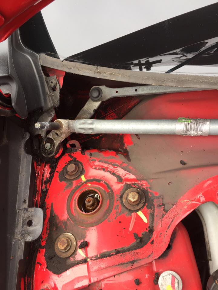

A few weekends ago I decided to clear my scuttle drains, since they'd never been cleared before and they car's now five years old. It proved to be a good decision! The offside drain was completely blocked and had a few inches of pooled water at the top of the turret. Everything was cleaned, cleared and sealed. Much better. I worked on it whilst my mate with a 172 Cup sorted his exhaust and a few other bits on his project.
This weekend I've removed both Sportsters ready for the buyer to collect this coming weekend. They were also shampooed, brushed and sealed with a hydrophobic coating.

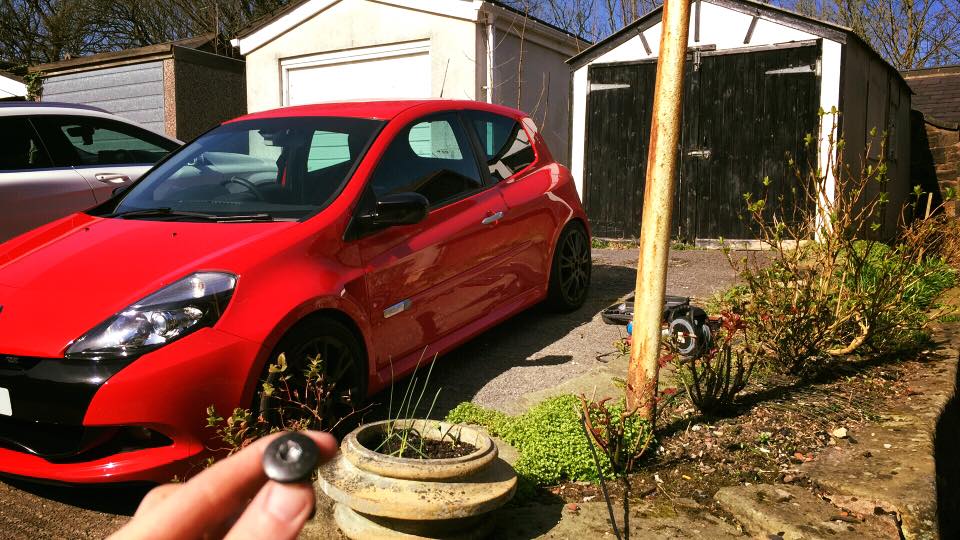

The removal went perfectly... up until I rounded off the FINAL BLOODY TORX BOLT and then had to drive over an hour away to my mate's house to borrow his impact. Fortunately it came right off with an impact and an oversized T45 which I hammered on. Phew.

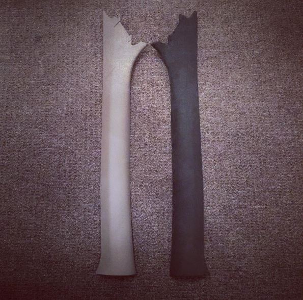

I also removed the plastic A pillar covers and retrimmed them in dark grey 9001 Alcantara. A million times better looking and it'll all tie in with the Alcantara wheel, gaiter and gearknob that I've ordered from Royal.

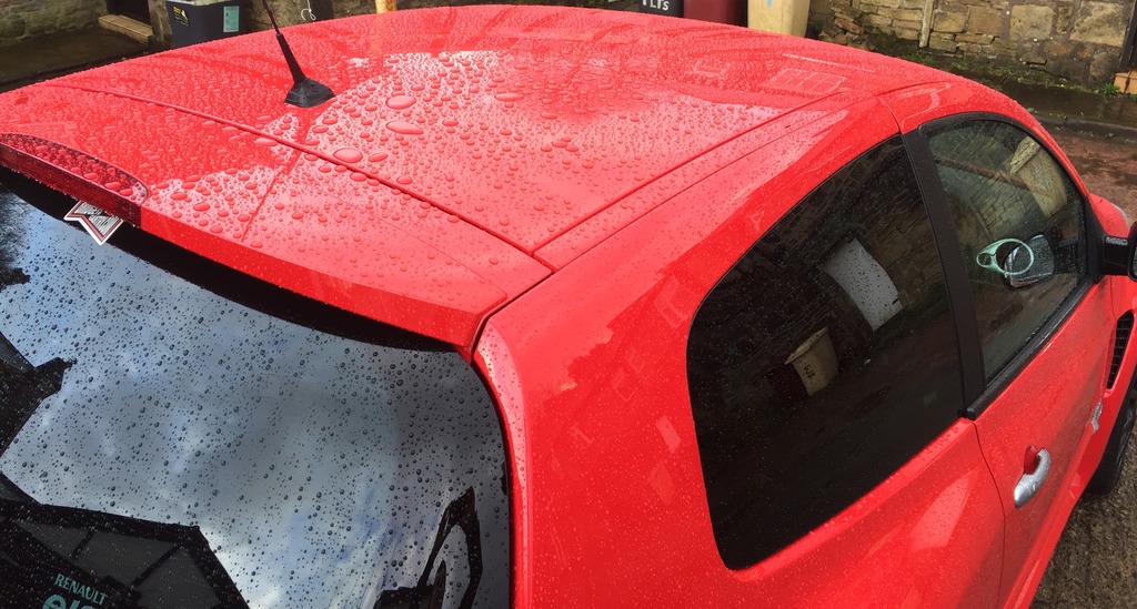

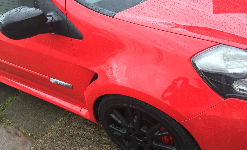

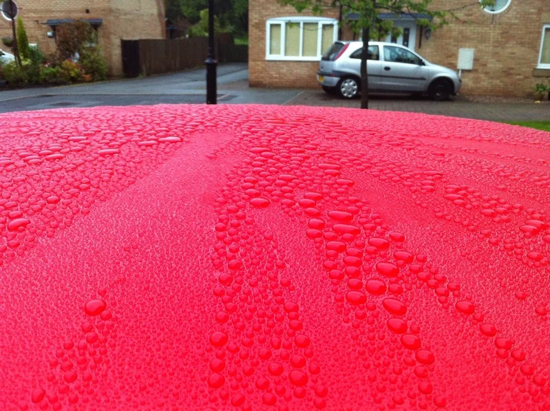

Arrived home from work to see the results of the weekend's detailing session. The car wasn't corrected because the paint is generally in great condition, it was more about depth and additional protection.
Crappy iPhone photo but hey.
Washed with Zaino Z2
Decon using Tardis in the worst places (lower doors, bootlid, rear bumper)
Clayed with Sonus Mild w/ 50% soap mix
HydrO2 applied to lower panels, wheels, diffuser and heavy fouling areas
Towel dried with Water Magnet x2
Glazed with Prima Amigo x2
Waxed with Soft99 Mirror wax (AMAZING stuff)
Gtechniq G1 & G2 on all glass
Gtechniq C4 on all plastics
Final wipedown with Zaino Z8 x2
Prima Wheel Armour used on all wheels
AutoFinesse Satin used to dress all tyres and buffed off to a matte finish
The interior was tackled on day two when I removed the seats, shampooed them and sealed the fabric.

Also fitted my newly retrimmed pillar covers! Looking good! ...shameless free plug for AutoFinesse, too.

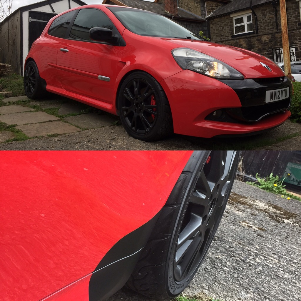

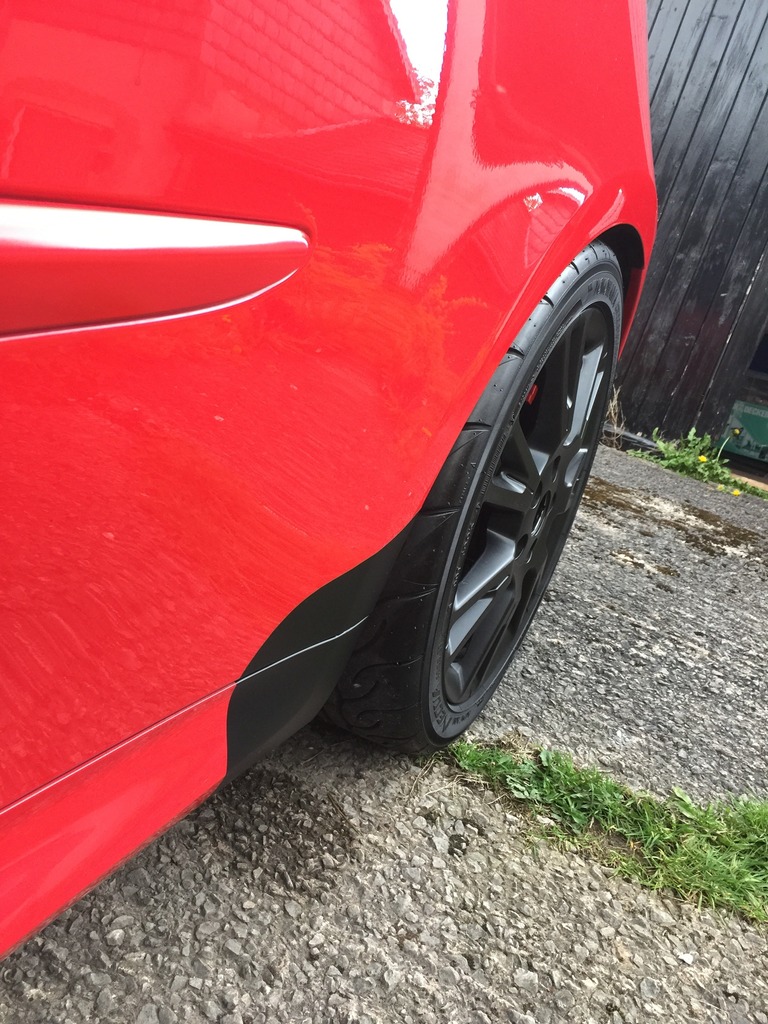

Finally completed my set of 200 Cup plastic sidestrips to fit. Some people aren't a fan, since it's a FF and I'm technically downgrading it, but I like the look of them.
Also waiting for a small black lip spoiler for the back.
Thoughts? Apologies for the poor quality Instagram image.

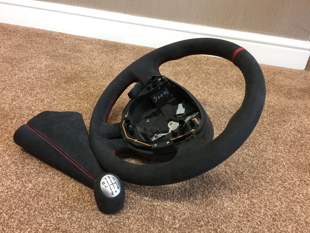

Decent sized update this weekend, finally! My retrimmed parts arrived from Jack at Royal on Friday, so after work I cracked on with installing them. Everything went back together really easily aside from the gaiter. The OE gaiter is stables to the (very flimsy) silver plastic surround which comes away from the shroud, so it's quite a time consuming process to unpick all the staples carefully and then re-staple the new boot to it.
Considering it's only a small touch, the Alcantara parts make such a huge difference to how the interior feels to sit in (on the floor with no seats. Lol) and really makes it feel special. The Alcantara pillars that I wrapped last week are also a pretty good match, so it all looks really tidy IMO. I also fitted my new Ultra Racing rear brace, which I had painted satin black. I wasn't a fan of the white or the previous red that I had done, so black was the option I went with. So much cleaner looking.

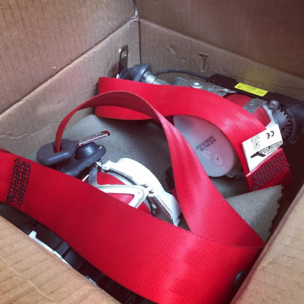

I've also sourced some red seatbelts from a lad on RS197.200, so they'll be in the post this week! Chuffed with that! They'll really finish off the interior IMO. This but with red belts. :smiley:

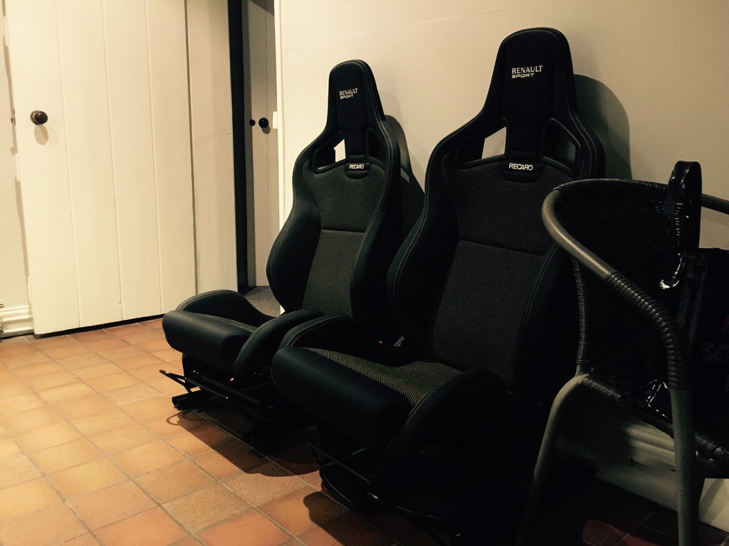

Seats have been once again delayed by Corbeau. Now looking at May 15th for shipment. Almost two and a half months after ordering... :sleeping:

Red RS seatbelts :sunglasses:

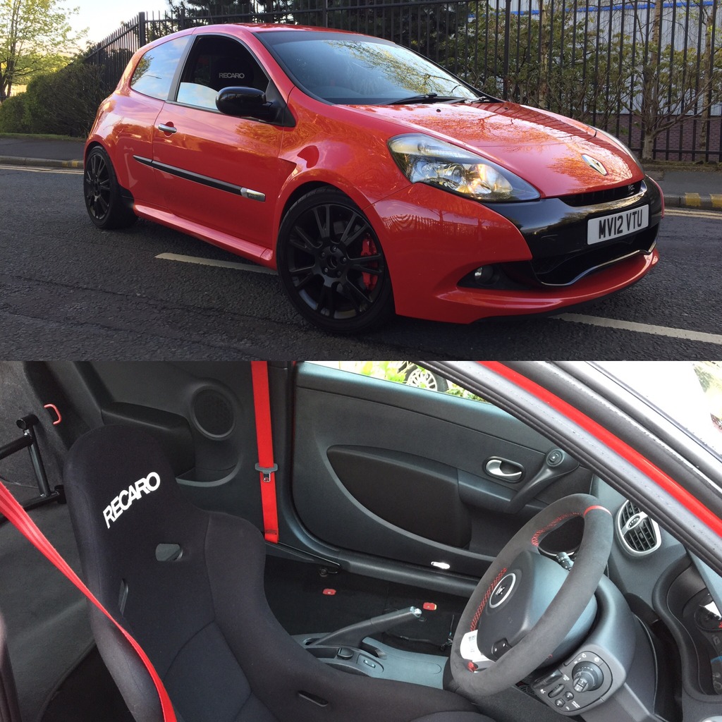

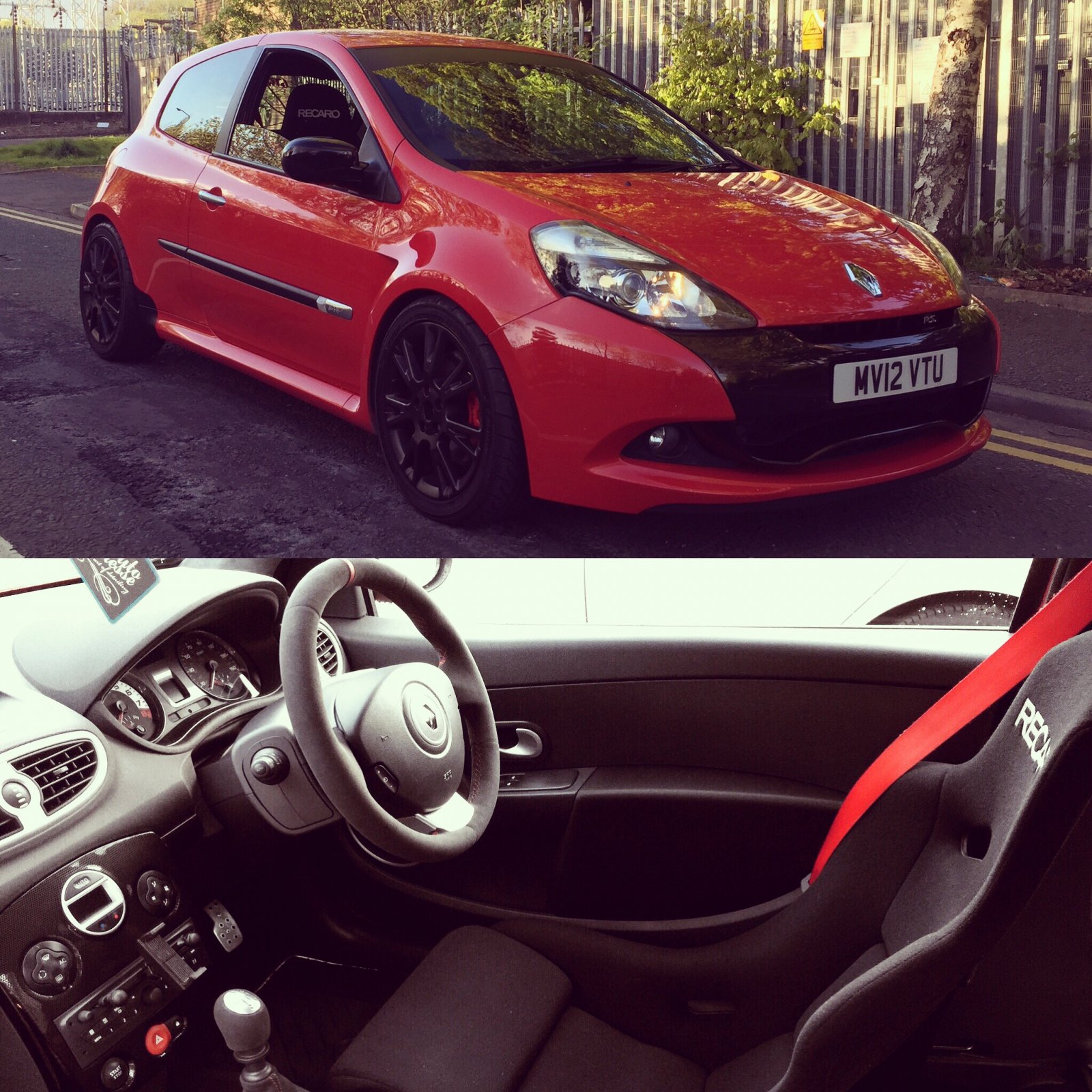

Yeah, I'm over the moon with the finished interior now and relieved that it turned out exactly how I wanted it to.
Aside from a few tweaks like painting my vents (not decided on colour) and sorting the Safety Devices cage later this summer, it's mostly done, interior wise now.

Fitted all the 200 Cup strips tonight, I ordered a spare driver's side strip to replace one that @Plummer had painted for his own car. Looks so good now... and will be back on the road tomorrow!
RS plates test fitted too.

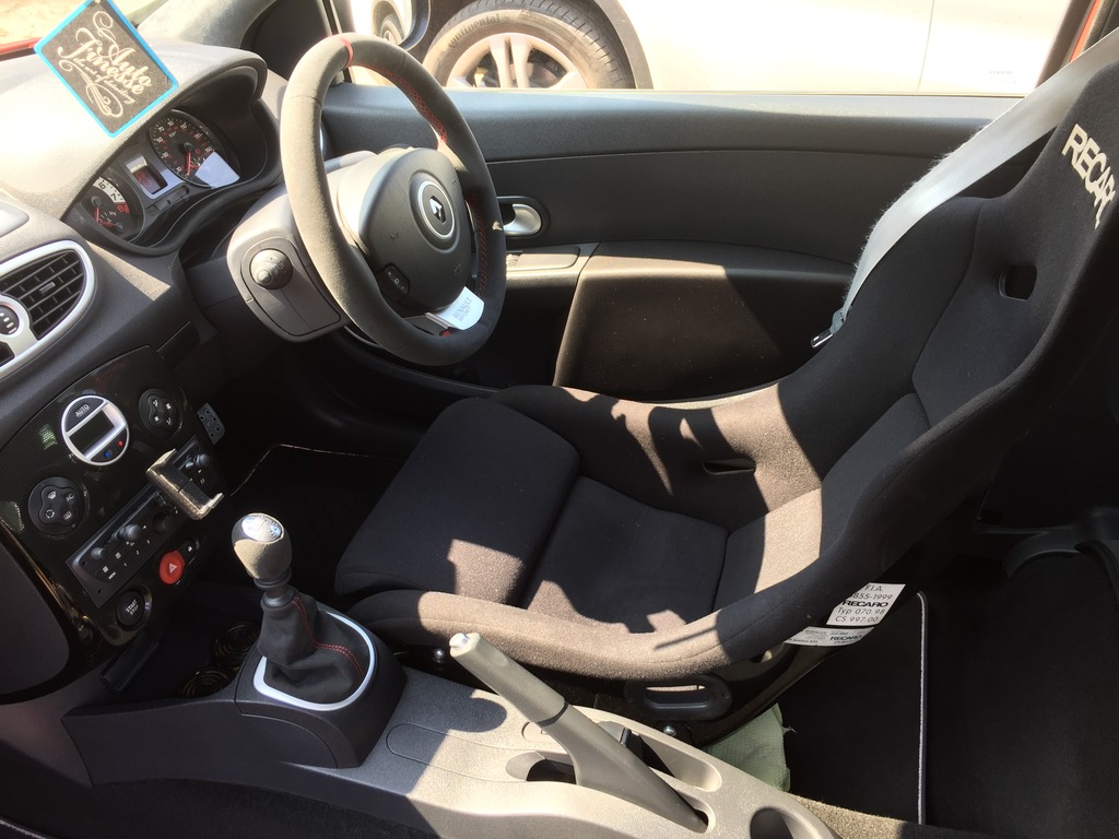

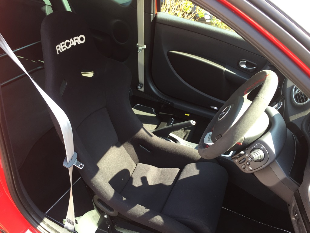

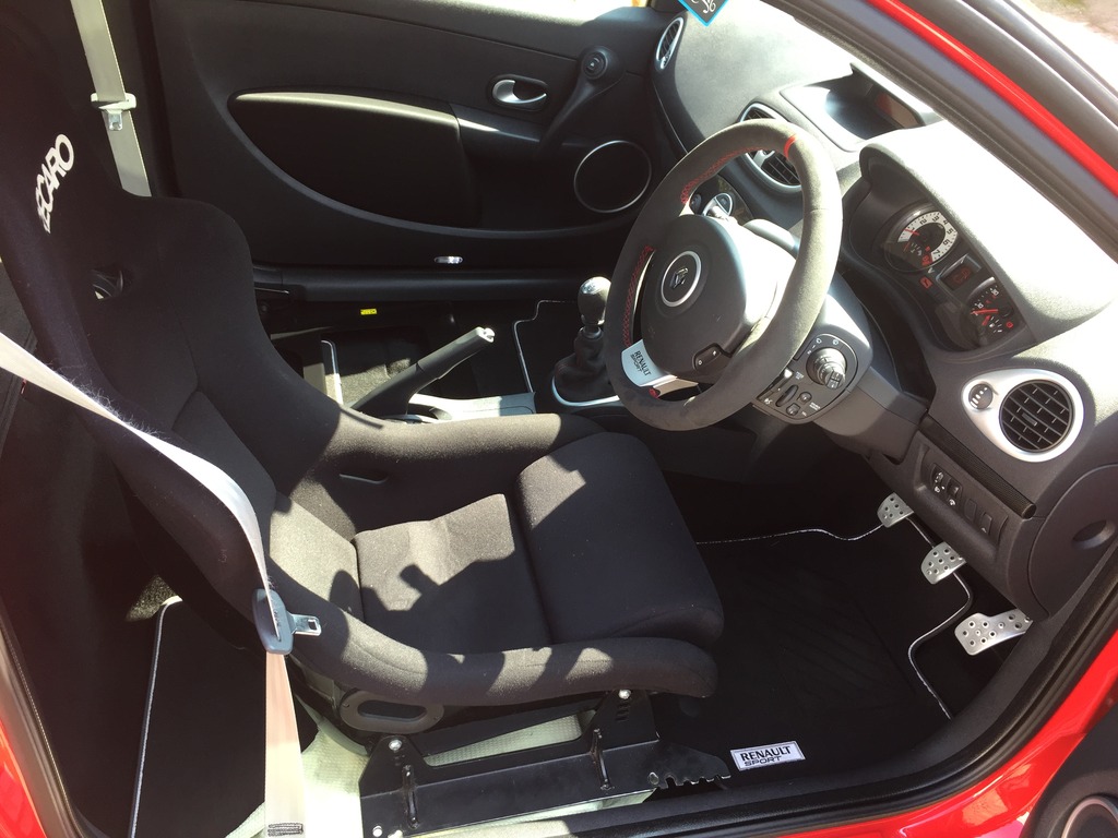

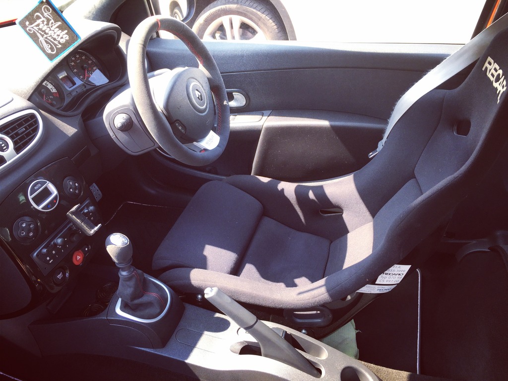

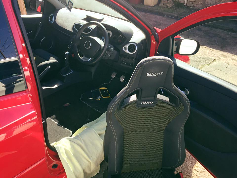

My new Sparco subframes came to replace the terrible OMP ones that I originally ordered. If you're looking for Mk3 frames, avoid them like the plague; they barely fit.
I offered up the Sparcos and they lined right up, then chucked the sidemounts on and had the first drive in nearly two months. The driving position and bucket completely changed how the car feels, it's like a big kart now. Love it.
I only went to get fuel and for a few quick pictures but all seems well. No airbag lights, no seat belt beep. All good.
The only negative is that the sidemounts I've borrowed from a mate are universal, so they're fixed with no runners and the driving position is a lot further back than I'm used to. I normally like to sit fairly close so I can wrist the top of the wheel, Ragnotti style, but there's no chance of that. It'll do the job until my seats arrive though!

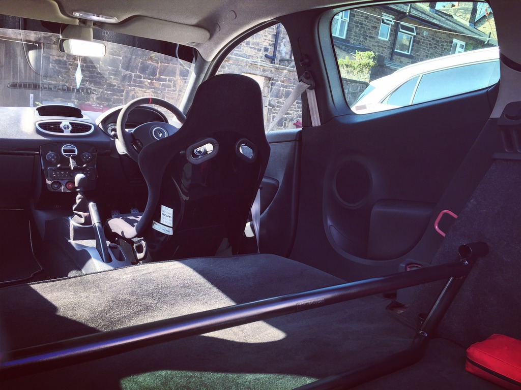

Had the whole weekend free (Mrs was away with friends) so I did a lot of driving to make up for the 8 weeks of not driving. Headed over to Rivington on Saturday/Sunday and then ended up in Macclesfield on Monday, so had a few runs up the Cat & Fiddle road. The car's totally transformed since I last drove it, the Pole Position totally transforms how committed you can be on a hard drive, also makes pedal work so much easier being lower in the car.
The AD08Rs work really well in the warm weather and I definitely notice the weight I've removed too. I had the car weighed on the Saturday and it came in at 1138kg, with no driver but 1/4 tank of fuel. That's about 66kg saved over standard, but with just the one seat. My goal is sub-1100kg with two seats and all interior trim as it is now... it's a lofty target but I have a rear wiper delete, V6 Airbox, dry cell battery and plans to remove the tar/hidden insulation etc, so it's doable.
As long as it doesn't turn into a rattlebox too much, I'm happy losing the insulation. It's mainly a road car after all.

The height of that seat! Must be 10 inches lower than standard 😂
That picture above is with no subframe OR sidemounts, so yeah it probably is. Now it's fitted it's more like a 3-4 inch drop from the standard Recaros. So much better.
