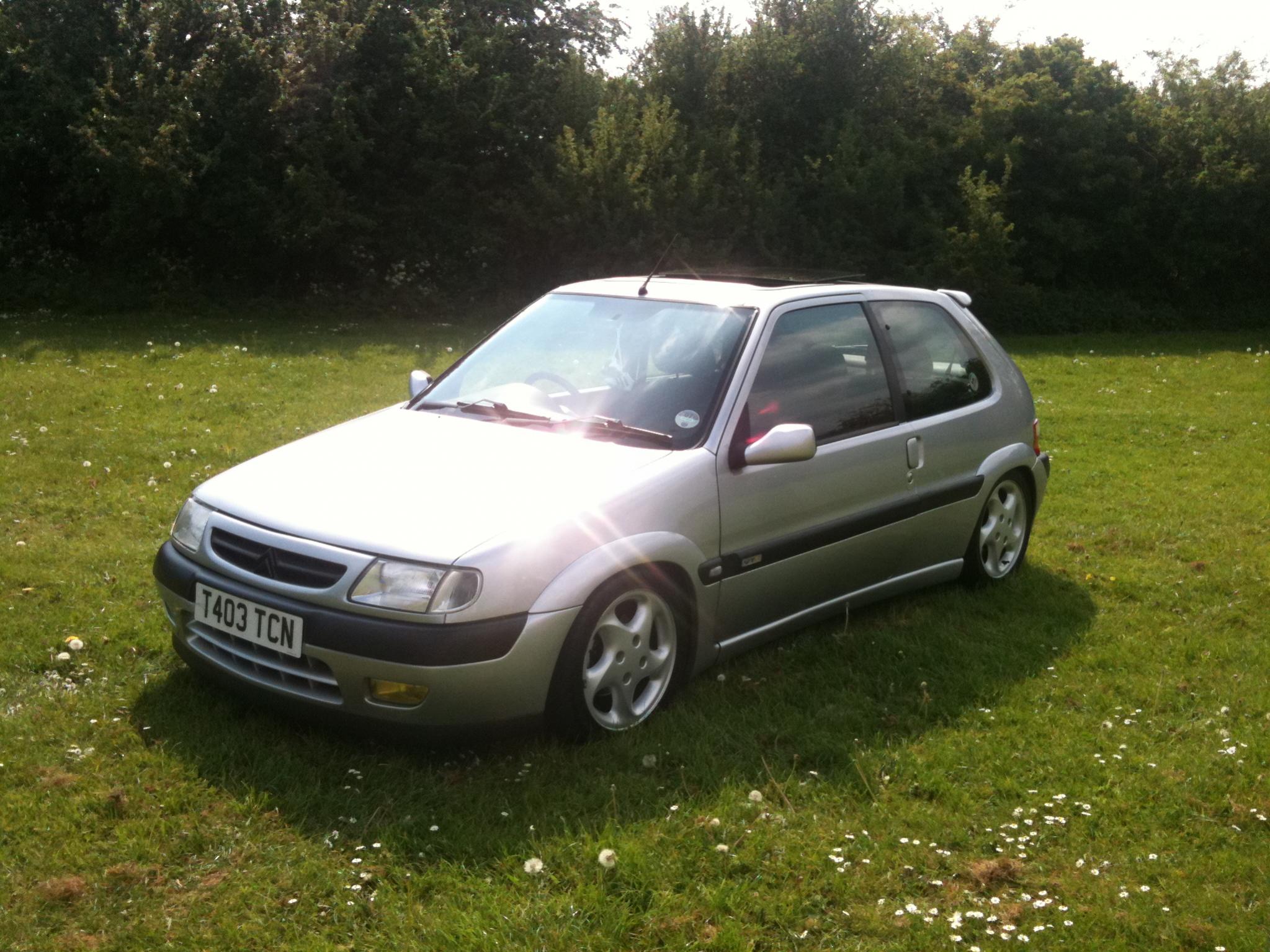

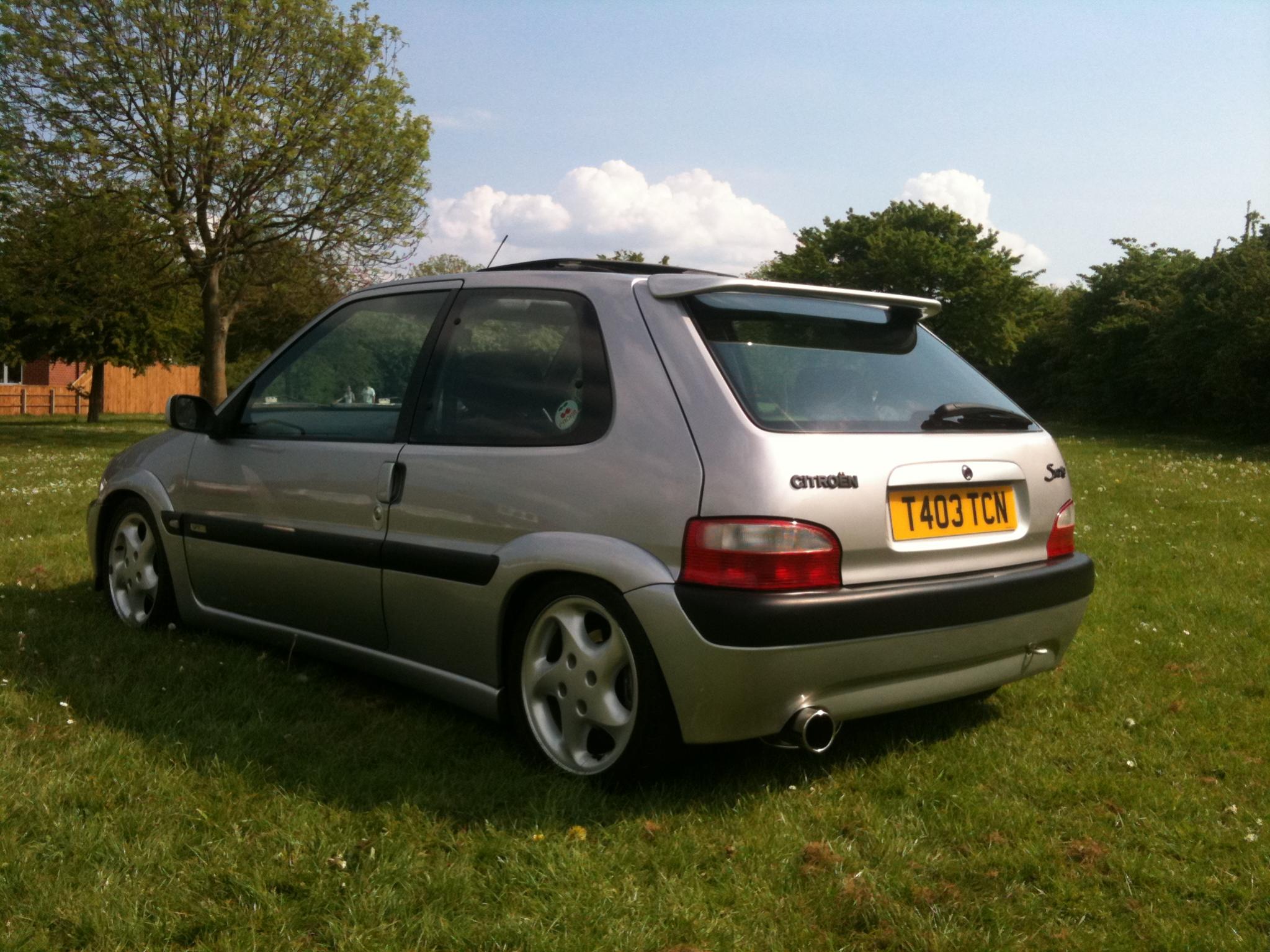

As said not all saxo's are chavy but thats how they get thought of, couple of pics of the 1 i owned great little car
  Mk2 Escort
Re: Project OEM Chavbox. Alot of Pictures
Really nice saxo that love the colour :cool: i didnt no what to expect with the chavbox title lol but i like it alot nicely done
View attachment 53809View attachment 53810
I do think the title is misleading but thats my humour towards it. You old saxo looks smart, mk1 too. Even better

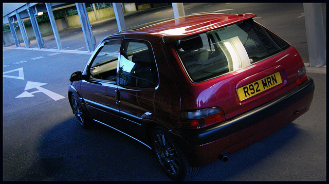

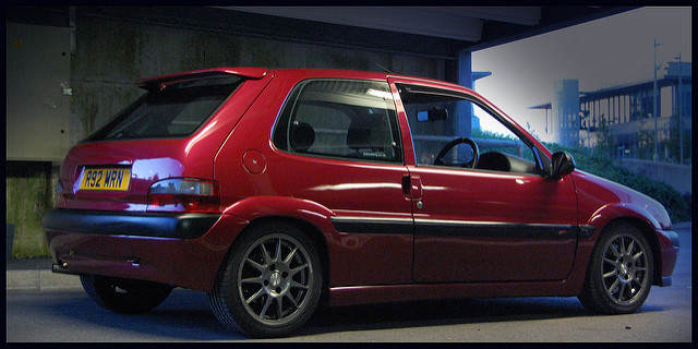

Right, its been a while people. (4 months to be more accurate).
Quick update with what has been happening. As mentioned earlier the head has had a full rebuild and the car is running sweet as ever (only covered 1500 miles since the beginning of April!)
Theres a lil bit of progress so ill try and keep this short;

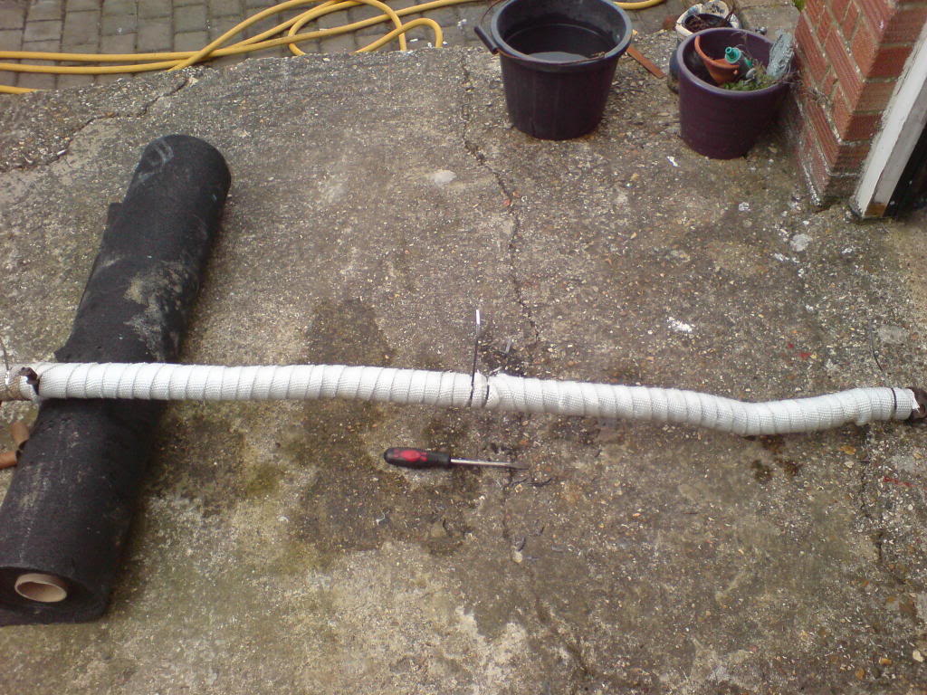

After the rebuild i got a decat pipe and fully heat wrapped it (not running any heat shields so it helps), and coupled this with group n hard rubber mounts.
This pipe sounds the nuts!!!! I am totally in love with the sound it makes. I have no video clips at the moment but im sure Fletcher, wonkystripedbandit, autoba and originalboyracer can back me up in this.
When i got the car in the air to fit the pipe i saw the drivers front arch was caked in oil. All the wheel / brakes / arch were dripping. The metal clip that hold the CV boot on and snapped open and the boot had slipped down the driveshaft. With a quick bodge it was off to a mates garage for a whole new driveshaft.

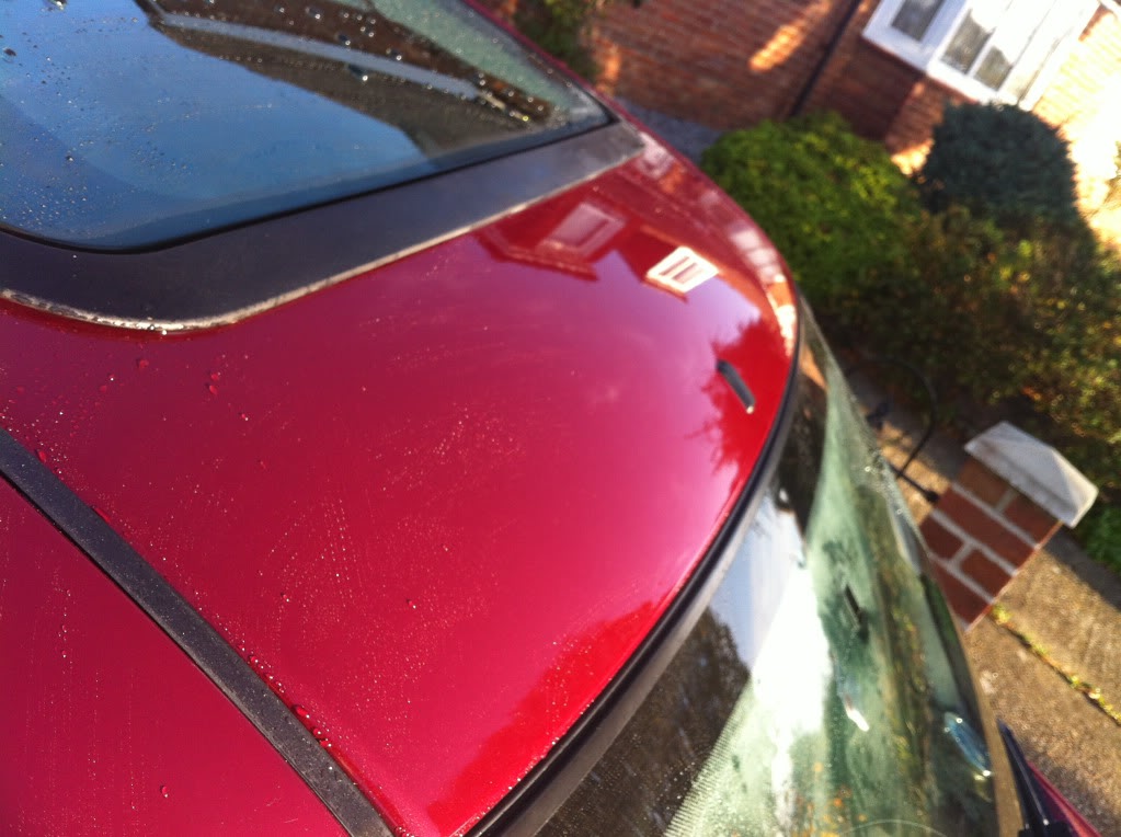

At this point FCS was drawing ever closer and even thought i keep my paint as clean as i can it had developed a fair bit of laquer peel on the front bumper over its life. So i booked it into a local bodyshop to get it sorted, however i got carried away and it got booked in for every panel to have some work done (bar the roof)!
It was done in time for FCS (just).....
The bodyshop work was as follows:
All parking dents removed from doors
Dents in wings removed
Dents in boot removed
Removed rear badges
Sprayed both doors / wings / rear quarters / boot / spoiler / bonnet / front bumper
All black trims sprayed in satin (more oem look, textured satin spray)
Also fitted carbon fog blanks, red snap off boss bolts just before FCS.

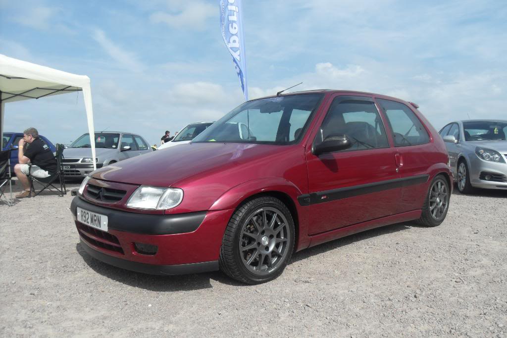

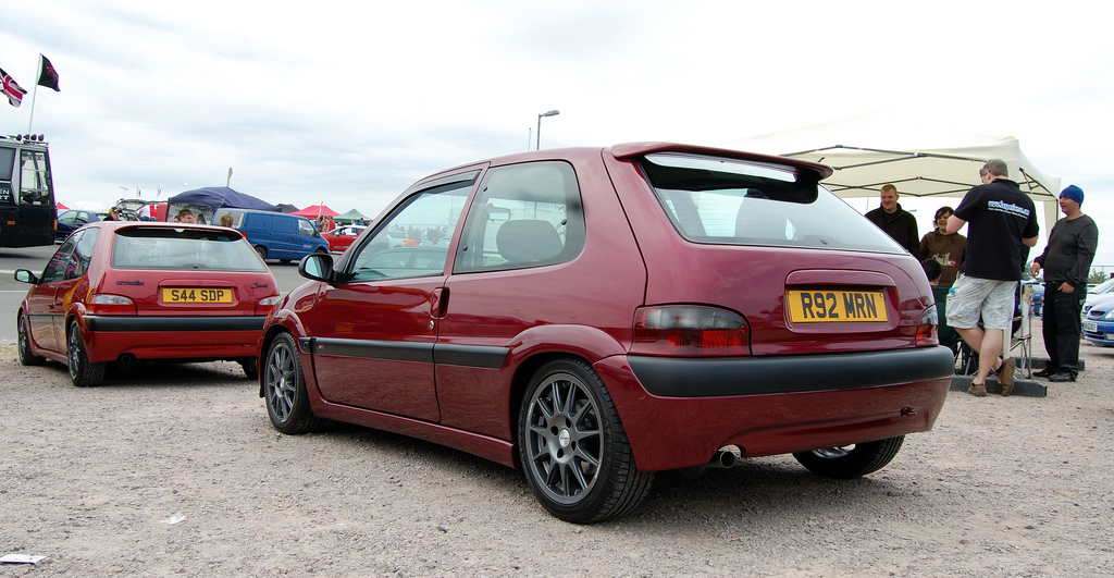

The car was a mission to get clean in the few days i had it before fcs but turned out to be all worth it, resulting in me picking up the FCS Special award on the Saxperience stand
Pics of fcs:
my ugly mug with my trophy

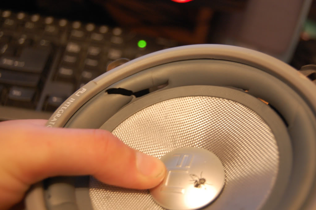

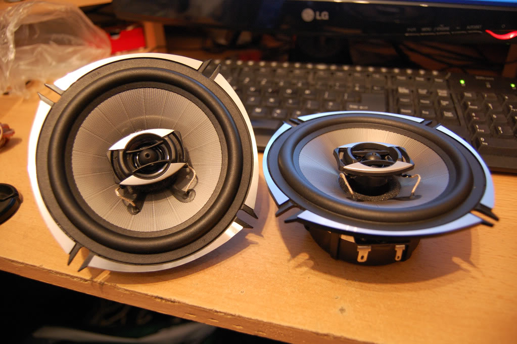

My speakers had been playign up for some time so next on my list was some sort of upgrade. My requirements were;
Had to be lightweight
Direct replacements to fit behind the standard speaker grille.
They had to be full range speakers (not comps) as i didn't want to mess around mounting a tweeter.
Had to be good enough to not need an amp to get any decent sound out of them. Don't want to go to the trouble of adding more weight with an amp etc.
I opted for some SPL Dynamic speakers and cannot rate them highly enough, build quality is top notch as is sound quality.
New:
vs Old:

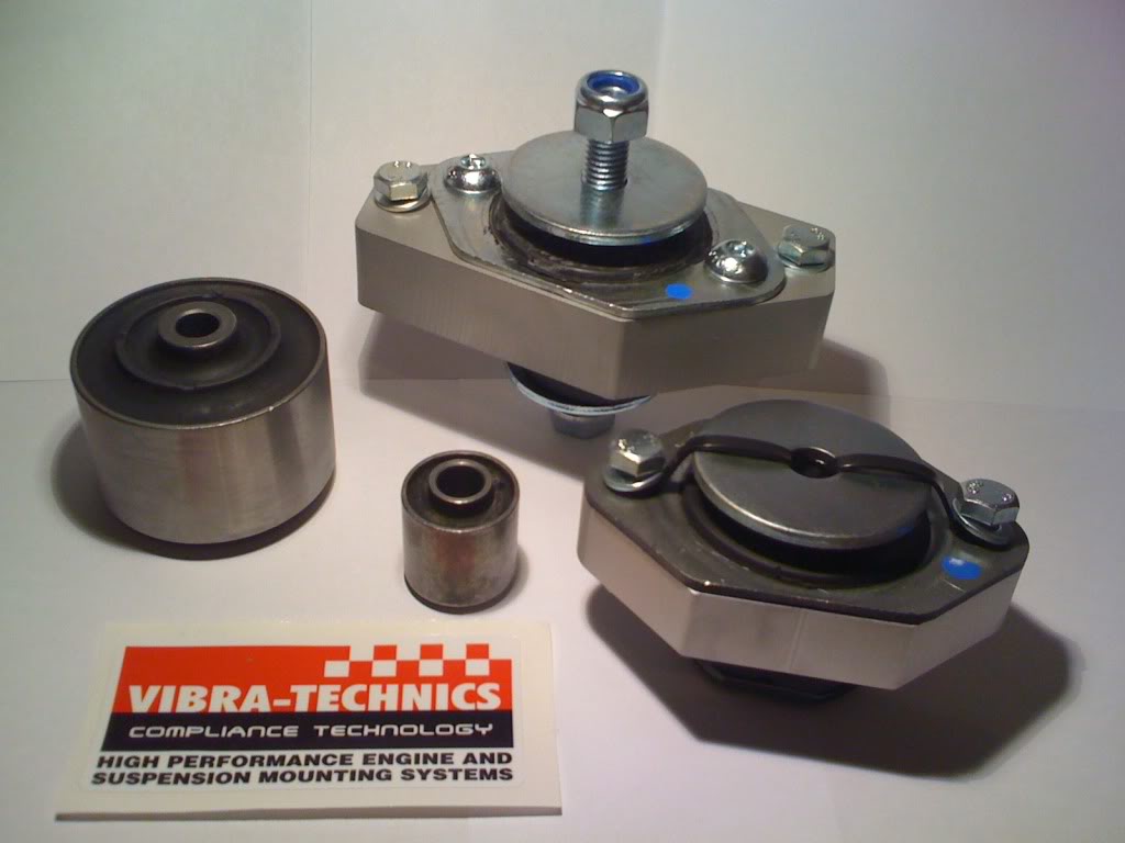

Just bought a PugSport Grp N Lower fork bush for the car and soon to be joined by a full set of VibraTechnics Fast Road engine mounts which should help transform the car.

Vibra-Technics Fast Road Ecu Mount
Vibra-Technics Fast Road Gearbox Mount
Vibra-Technics Lower mount
Pugsport GrpN lower fork bush
Should do me nicely

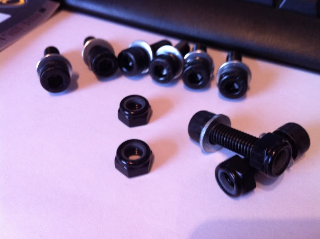

Pimp Bolts, who can guess what they are for?
Crappy updates ftmfw
  Mk2 Escort
Ha got you on that one fletch.
