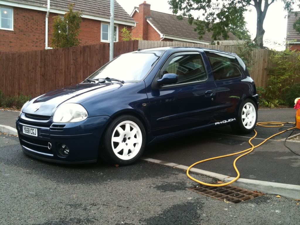

Heres a few pics of the car
http://i851.photobucket.com/albums/ab75/payton31/fbe1d9e2.jpg
http://i851.photobucket.com/albums/ab75/payton31/4fb46150.jpg
http://i851.photobucket.com/albums/ab75/payton31/3d674625.jpg
http://i851.photobucket.com/albums/ab75/payton31/bfcef331.jpg
