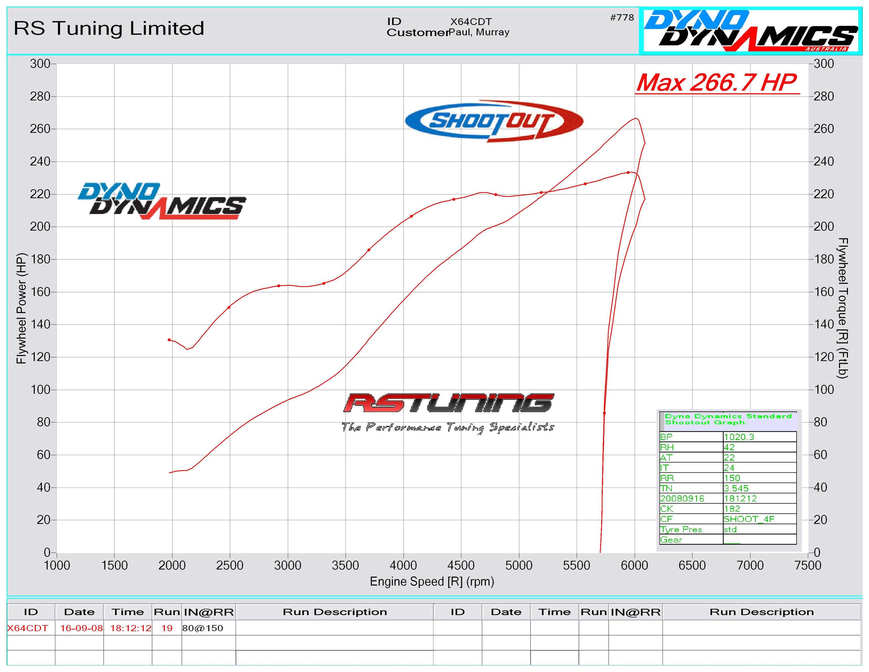

Started to map the clio today, really need to sort some kind of restrictor out, i'm sure it wont last long with 266hp @ 6000 rpm on stock internals!

Here's a quick graph, loads more mapping to do as it's way rich at the mo:

LOL! 266 bhp at under 6000 rpm? Madness. Shows what can be done when things are engineered and mapped properly :D
