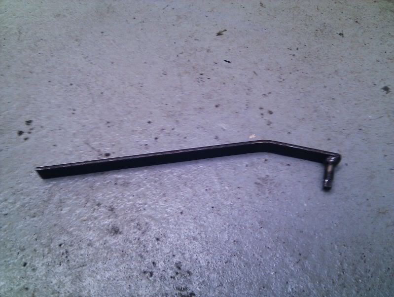

does such a thing exist? i broke my home made effort today (after god knows how many uses) and rather than trying to weld it back together i quite fancy a proper looking bit of kit,,
if it does exist,, part numbers? found one in the snap-on/ast catalouge,, but it looks the wrong shape :S
im on about the 3/8 drive tensioner tool by the way

I tried it too, and it didn't locate properly, or give enough swing because of being straight
So I made this:
cool, the ratcheting aspect of the snap on one is handy, a combination of the one you've made and the snap on one would be brilliant
I don't see the advantage unless you want it to work on other vehicles. The 3/8 square drive is welded on at the ideal angle.
