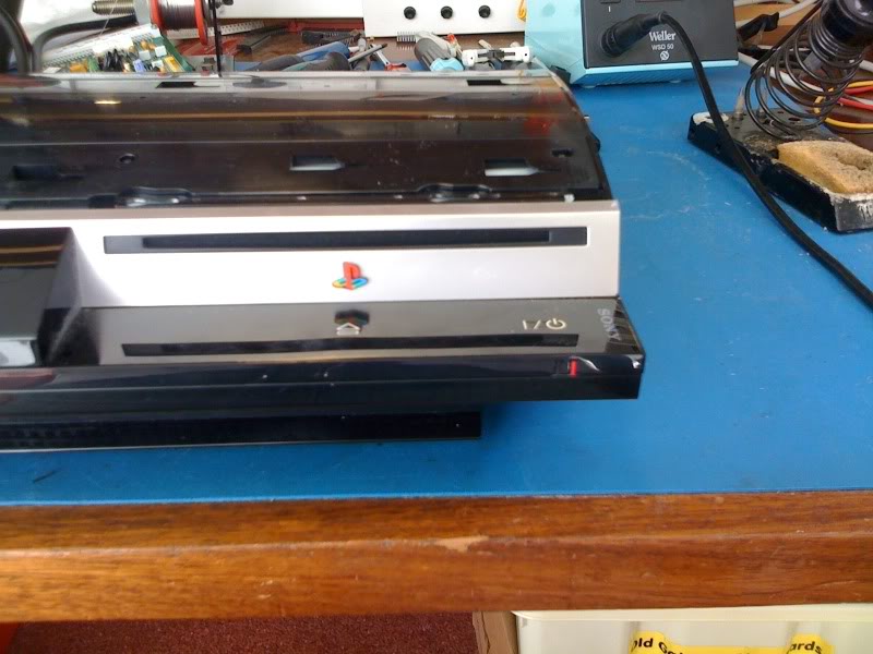

Mate at 5-a-side gave this to me last night to see what I could do with it..had the Yellow Light Of Death. Half an hour or so at work this morning and.........

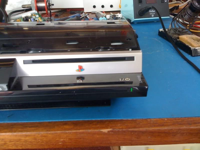

f**k knows to be honest Scutch. First one I have done with the YLOD (its a first model outside of warranty) and I havent been able to get my hands on one until now.
Had it running all morning and it seems fine but no TV to test it on at work.
Shal we take bets?? Il say a month! :)
Edit if it goes again il stick it through our proper all singing/dancing reflow machine which can check the pins too. I did this one by hand.

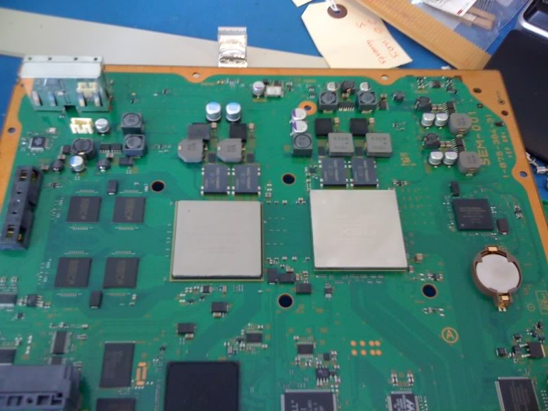

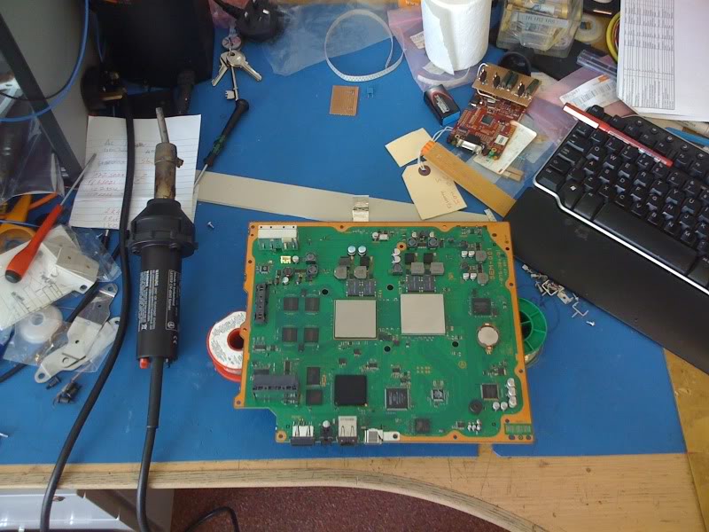

What was wrong with it in the end?
Doesn't look complicated at all, nothing compared to a proper PC.

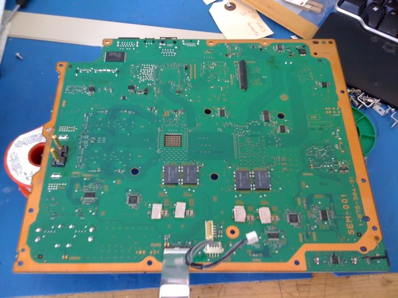

Similar issue to the XBOX clamp issue and dry solder joints to be honest.
Reflow/heat the CPU, GPU and new heatsink compound.
Its a bit of a git to get down to that level though but theres fcuk on the main board as you can see. Quite interesting really for a geek like me :)
