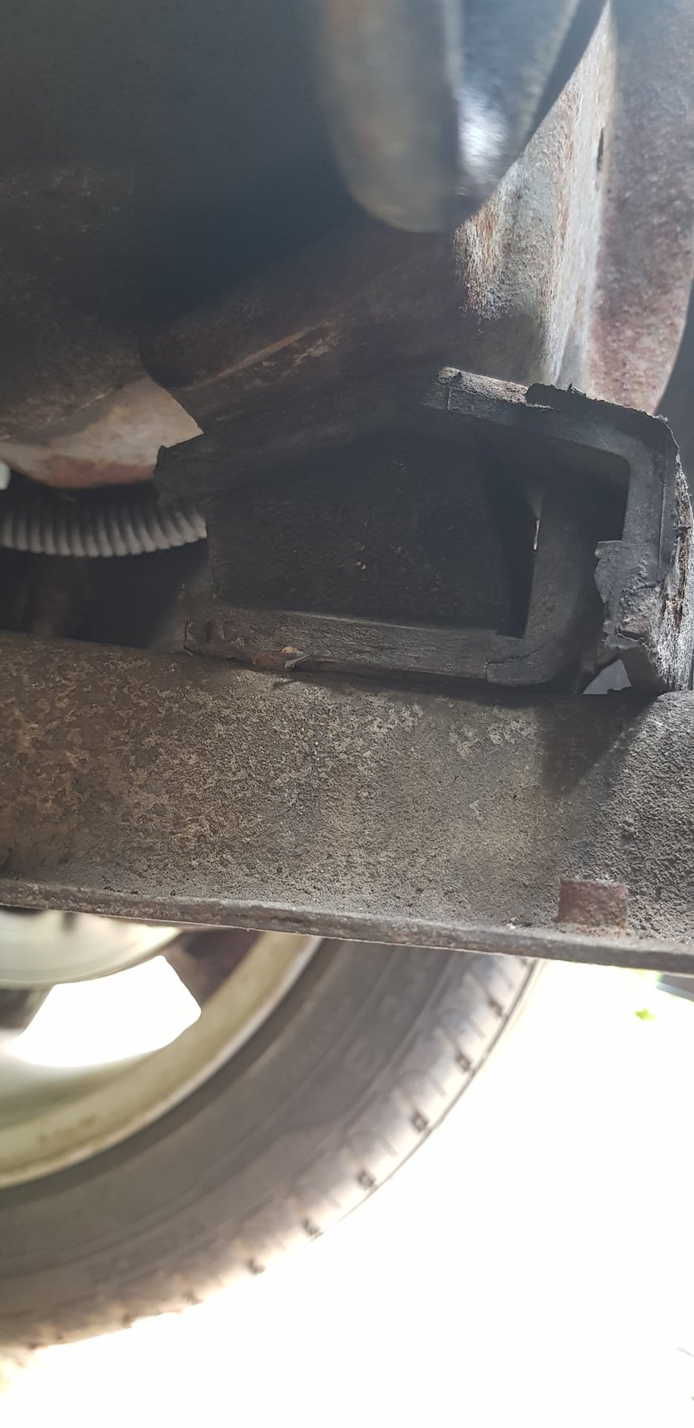

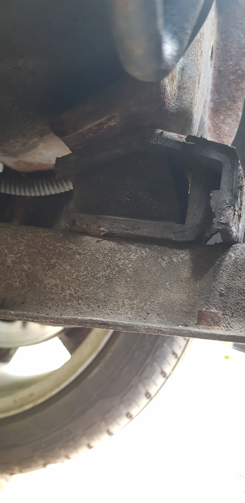

I've changed the gearbox oil today and noticed some previous bumpy has fitted the lower gearbox mount upside down!
Removing it looks like a right b#####d
Wasnt too hard to remove and flip the mount at all really, nice worn mark in my subframe from the wount rubbing now though.
