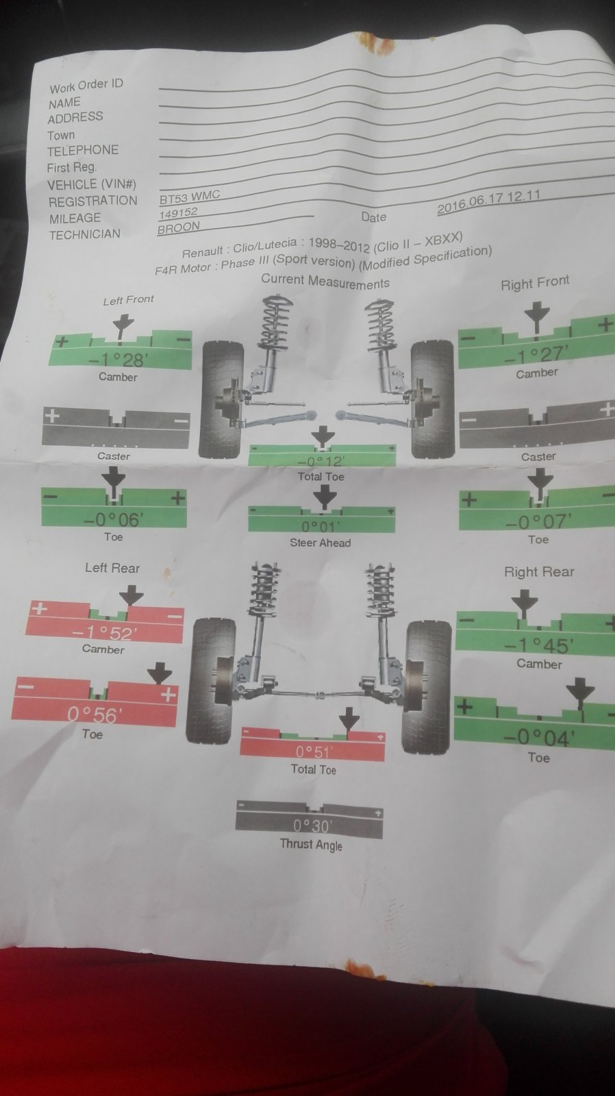

They claim the rear wheel out wouldn't pull it left, true ?
I don't know much about tracking and alignments but I know what toe is and to have -0.5 on the rear wheel would probably be causing that. If rear tyres were not to blame for tracking issues then we wouldn't need to align them would we? Sounds like hes lying. Just my opinion, correct me if I'm wrong
That rear tow wont be helping mate, my mondeo pulls left and the tracking is fine. Think mine is the steering rack as i get wheel wobble above 50 and the steering wanders. Had everything checked and re-checked, new tyres and swapped the wheels around to no avail, bugs the shite out of me.

The rear toe should be fixed so something must be bent I was hoping a shim could sort.it rather than a new axle
